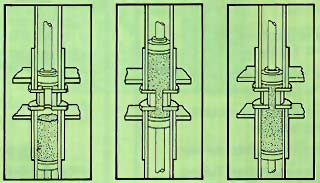

Figure 4: Schematic of the AFM process, which shows abrasive media being extruded through the workpiece and tooling.
Abrasive flow machining. Another free-abrasive means of improving surface roughness is abrasive flow machining (AFM), which also can be used to remove burrs and create radii. In AFM, two opposed cylinders extrude a semisolid abrasive media back and forth through passages formed by the workpiece and the tooling (Figure 4). The process is abrasive only in the extrusion area where the flow is restricted. The machining action is similar to a grinding or lapping operation as the abrasive media gently and uniformly hones the surface or edges. Materials from soft aluminum to tough nickel alloys, ceramics, and carbides can be successfully micromachined with this process.
The media is composed of a pliable semisolid carrier and a concentration of abrasive grains. The viscosity of the carrier and the abrasive grain size, type, and concentration can be varied to achieve specific finishing results. Higher-viscosity media is used for uniformly abrading the walls of large passages, while lower-viscosity media is generally appropriate for radiusing edges and for processing small passages.
The uniformity of the polished surface is one of the primary advantages of AFM, especially compared to manual finishing methods. This advantage leads to other benefits beyond lower labor costs, including improved part performance, longer tool life, less scrap and rework, and shorter inspection times.
Because AFM can remove the total HAZ regardless of its depth, the process embraces a wide range of applications, from critical aerospace and medical components to high production volumes of parts. AFM can reach even the most inaccessible areas and can process multiple holes, slots, or edges in one operation. Used to polish dies for extruding, drawing, forging, cold heading, and compacting, the process eliminates the expense and inconsistency of hand work. Uniform, controlled removal of material permits accurate sizing of die passages with minimal dimensional change. Typically, original EDMed finishes of 100µin. Ra are polished to below 10µin. Ra in a 10-min. cycle without special tooling requirements. Surface-finish improvements to one-tenth the original finish are generally expected from the process in such applications.
