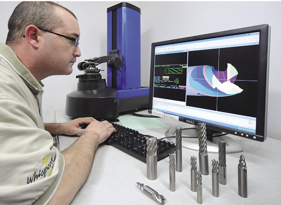

Dura-Mill Inc., Malta, N.Y., produces solid-carbide endmills, such as its WhisperKut and WhisperKut Plus with an asymmetrical variable-helix design to reduce harmful harmonic resonance. The toolmaker was experiencing machine tool issues but having trouble pinpointing the exact cause, noted Charles Ward, Dura-Mill’s plant engineer.

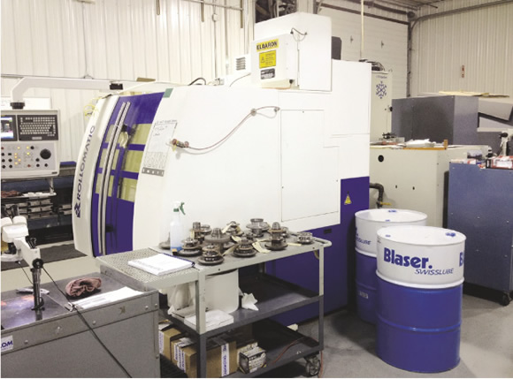

“The electrical cabling was failing at an astounding rate in several different brands of machines,” Ward said, adding that the plastic wire ways that prevent wires from becoming tangled were also cracking and falling apart.

After switching to Blaser Swisslube’s Blasogrind HC5 synthetic grinding oil, Dura-Mill eliminated degradation to plastic components in its grinding machines (above) for producing solid-carbide endmills (below).
