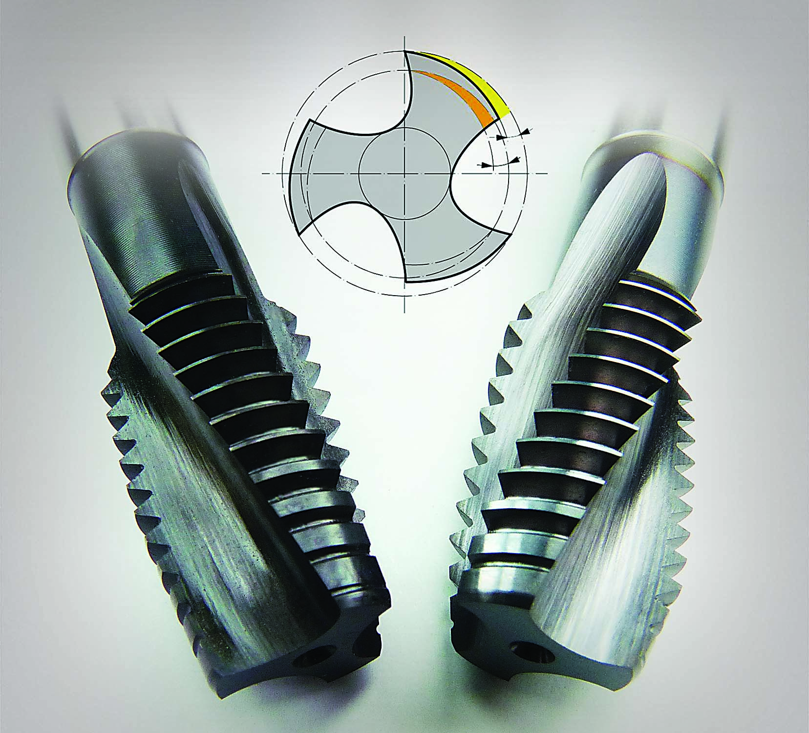

When used to tap tough, long-chipping titanium, benefits of high-relief geometry include longer tool life and better thread finish. Image courtesy of Emuge-Franken

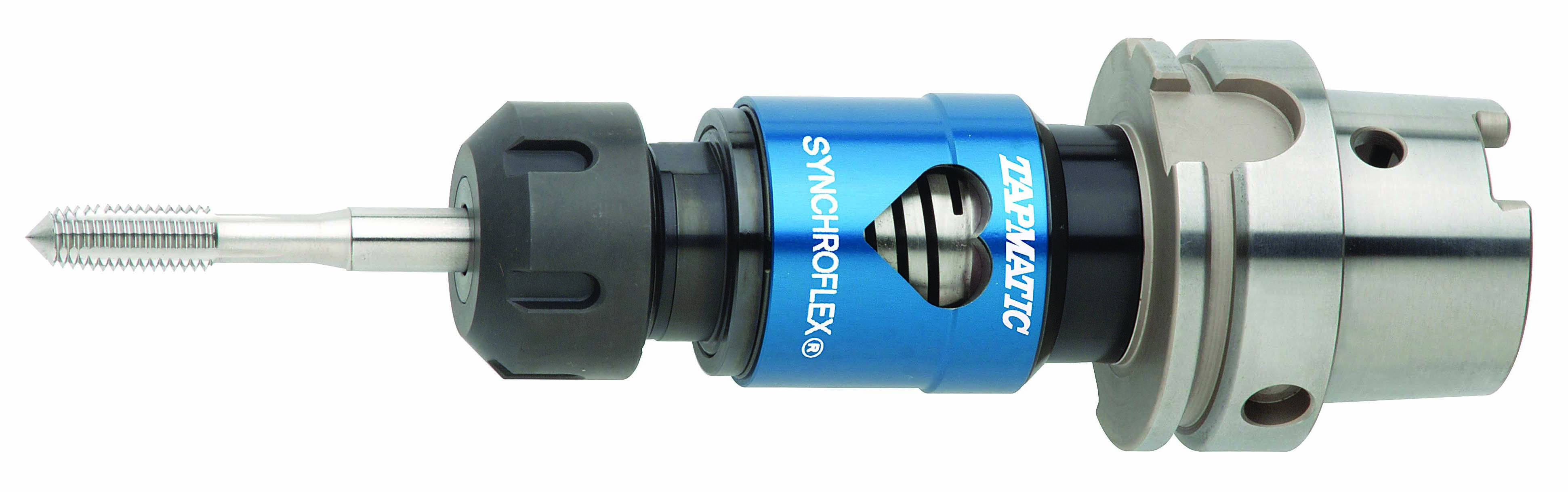

To solve this problem, both Emuge-Franken and Tapmatic offer tapholders designed to provide a minor amount of positional compensation during rigid tapping. The result, according to both companies, is much better thread quality and significantly longer tap life.

Emuge-Franken makes taps with geometries and coatings aimed at improving tool life and thread quality in titanium applications. Hatch said a major challenge in making these tools is dealing with the high compressive forces produced by titanium tapping. Emuge-Franken does this by giving the taps a high-relief geometry, which increases the space between friction surfaces for improved lubrication and reduced torque load in both the forward and reverse directions.
In addition, he pointed out that taps designed to thread titanium need a flute angle that provides enough core strength to handle the high cutting torque produced by the process. This means that high-helix taps — with higher hook angles to improve shearing action in soft, ductile materials — cannot be used for titanium.
With a precisely machined flexure inside, SynchroFlex tapholders provide small amounts of positional compensation to improve rigid tapping results and tool life. Image courtesy of Tapmatic

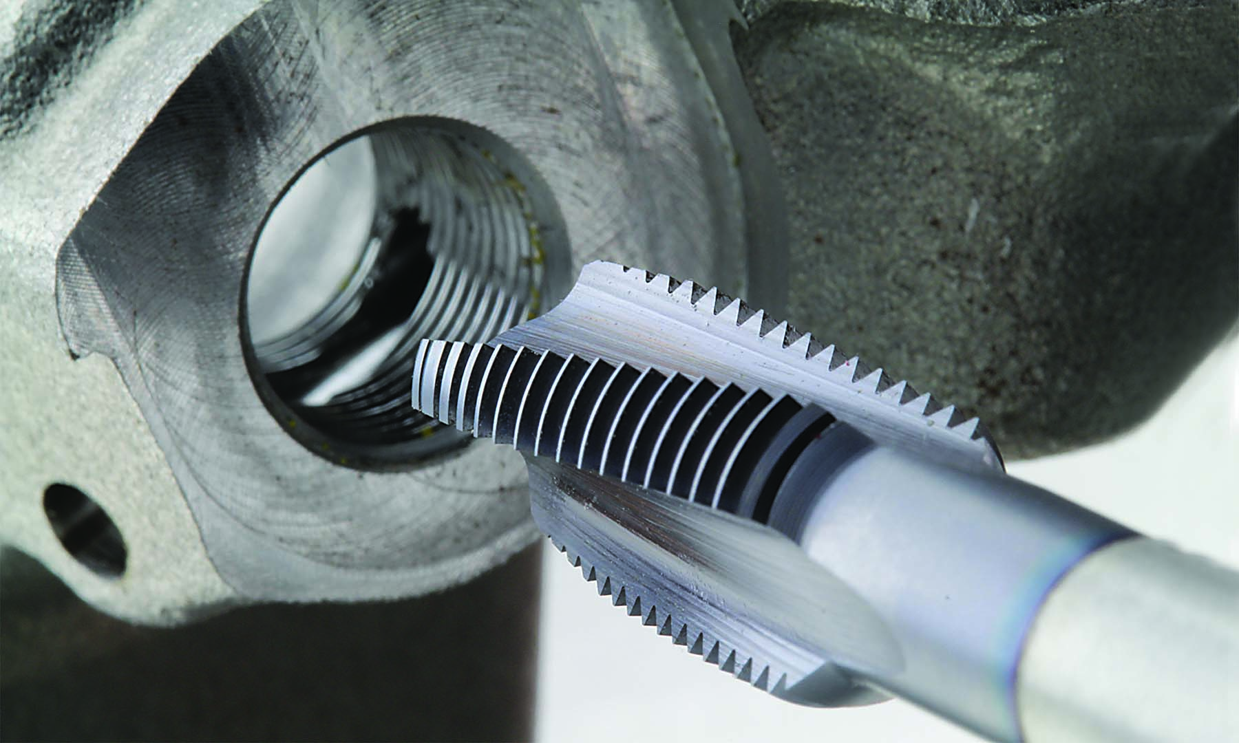

The right tap design also makes it easier to move chips out of a hole. This is particularly helpful when tapping titanium, which presents chip-forming difficulties. So Emuge-Franken offers tap geometries designed specifically to move chips out of a through hole or blind hole. The company's through-hole tap geometry pushes titanium chips forward so they exit the hole on the side opposite the one that the tap entered. For a blind hole, Hatch said the company has a tap design that allows chips to be drawn out with the assistance of a fluid.
As for coatings, he said Emuge-Franken uses a TiCN formulation that helps a tool deal with the high compression forces produced when tapping titanium by increasing mechanical resistance to edge wear and improving sliding characteristics.

High-relief tapping geometry increases the space between friction surfaces for improved lubrication and reduced torque load in both the forward and reverse directions. The advanced geometry counteracts high compressive forces produced by the elastic memory of titanium. Image courtesy of Emuge-Franken
