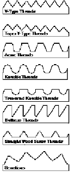

Thread rolling is applicable to many standard and special thread forms. Besides common 60° profiles, other types of threads that can be rolled include parallel- and taper-pipe, V-type, acme, knuckle, buttress, straight wood screw, and serrations (Figure 5). As long as the flank angles on each side of the thread add up to at least 20°, practically any special shaped thread can be rolled between 0.055″ and 9.000″ in diameter with a thread-rolling head/attachment. Just by changing rolls, a thread-rolling head/attachment also can knurl and burnish. In addition, depending on the specific application, it may be possible to reduce tube diameters, swage the ends of tubes, roll annular ring profiles (i.e. barbs and grooves), and mark logos, letters, and numbers.

Thread Rolling on CNC? Figure 5. Types of profiles that can be rolled.
