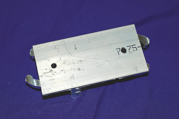

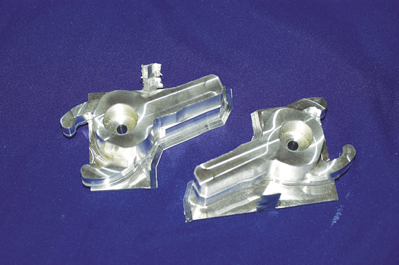

A trick for separating multiple ganged parts involves applying a 90° chamfer mill or drill-point endmill to follow a contour that will be the parting line between the parts. Leave 0.001 " to 0.003 " of material at the bottom for an easy break line on the back of the ganged parts. Then, you can easily snap off the parts and insert them in pocketed soft jaws for second-side operations.

Top: A trick for separating multiple ganged parts involves applying a 90° chamfer mill or drill-point endmill to follow a contour that will be the parting line between the parts. Middle: Leave 0.001 " to 0.003 " of material at the bottom of the contour path for an easy break line on the back of the ganged parts. Bottom: Then, you can easily snap off the parts.
