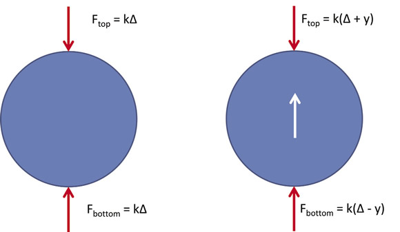

It is important for the bearings to be very stiff, because the stiffer they are, the more accurate the machine is and the less likelihood there is for chatter. Setting and maintaining the preload in spindle bearings (keeping the balls under significant compression) is essential, because if the preload is released, bearing stiffness drops by a factor of two. To see why, examine Figure 1, which shows a cross section of the spindle (blue) and the forces (red) created by the compression preloading of two opposing balls.
We are ignoring the other balls for now and assuming that the force in the spring is linearly proportional to the amount the balls are squeezed (F = ky). In reality, the balls are springs that get stiffer the harder they are squeezed, but as long as the displacement is small, our approximation is not a problem.
Without an applied external load (white arrow), the forces produced on the spindle by the balls are balanced, and the spindle is centered in the housing. In this case, the sum of the forces in the vertical direction is:
Fbottom - Ftop = kΔ - kΔ = 0.
This means the spindle will not move up or down.
If we apply an external load to cause a small displacement in the vertical direction y, the situation is shown in the bottom part of Figure 1. The external force releases a little of the preload on the bottom and slightly increases the preload on the top. In that case, the sum of the forces in the vertical direction, which still sum to 0 so the spindle does not move up or down, is:
Fbottom + Fexternal - Ftop = k(Δ-y) + Fexternal - k(Δ+y) = 0.
That can be written as:
kΔ - ky + Fexternal - kΔ - ky = 0, or
Fexternal = 2ky.
Figure%201.tif
Courtesy of S. Smith
Figure 1. A preloaded spindle with no external load (left) and with an applied external load (right).
Even though one ball is being compressed, and one is being released, the stiffness for the balls adds together (k + k = 2k) as long as they both stay in contact with the spindle. The stiffness of the other balls in the bearing only contributes partially to the bearing stiffness in the vertical direction. Because the forces in those balls act radially, they only have a smaller component of force-carrying capacity in the vertical direction. However, each ball has a matching ball on the opposite side, and the same rule applies. As long as all of the balls are in contact, the stiffness is increased both by the balls being compressed and by those being released by the external force.
If the preload is lost, the spindle stiffness is reduced by a factor of two. If the external force is large enough to make y larger than Δ, all of the balls on the bottom side of the spindle lose contact with the spindle and can no longer contribute to spindle stiffness.
