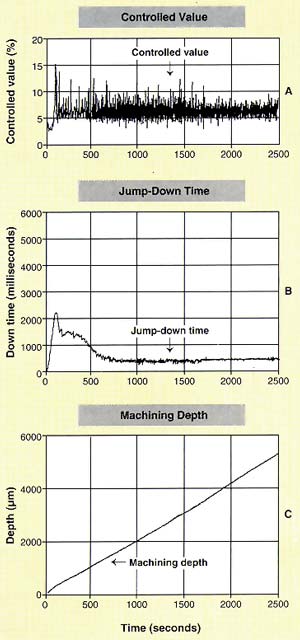

Figure 5: These graphs show the data recorded from a die-sinker EDM operation that incorporated adaptive control.

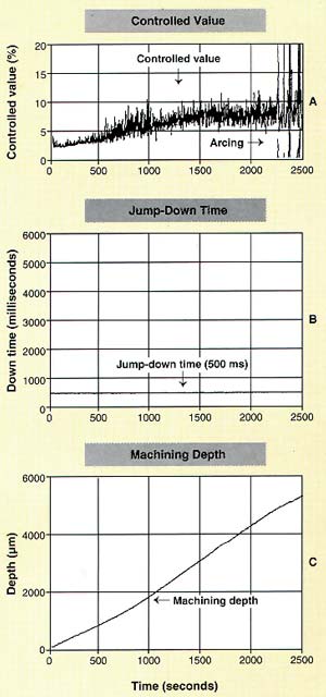

Figure 6: These graphs show the data recorded from a die-sinker EDM operation that did not have adaptive control.
Figures 5 and 6 show data from two machine operations during which deep cavities were EDMed. Figure 5 shows an operation using the adaptive control system. Figure 5A depicts the controlled value, which is a combination of the gap-state parameters that the monitoring system was detecting at any given time. The researchers found that for this operation a controlled value of 6% indicated a stable process. When the value went above this reference value, it was a sign of gap pollution.
The data recorded in the graphs of Figure 5 indicate that the gap had good flushing in the beginning of the operation. Figure 5B, which traces the jump-down time during the operation, shows that the good flushing conditions allowed the controller to keep the jump-down time high at the beginning. But as the machining depth increased, flushing deteriorated. In response, the controller gradually reduced the jump-down time to about 500 milliseconds. Figure 5C shows that the changes in jump-down time allowed the machining depth to increase smoothly without arcing damage.
Figure 6 records a process without adaptive control. For this operation, the researchers chose a jump-down time of 500 milliseconds for the entire operation. For the given setup, 500 milliseconds would be a somewhat aggressive setting, but it was chosen to match the value that the operation with adaptive control eventually came to. Without adaptive control, the controller could not change this jump-down time to respond to deteriorating flushing conditions. As a result, the controlled value, which is depicted in the top graph, gradually rises with the increase in machining depth. The spikes on the top graph show that unrecoverable arcing damage began at 35 minutes into the operation.
