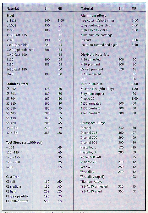

Determine the machinability of the material to be machined, based on hardness (Rockwell C or Brinell), material type, toughness and alloy content. A good source is the universal "Machinability Rating" (MR), originally developed by Metcut Research Associates Inc. for the Defense Logistics Agency. Table A gives the MRs for a number of popular materials. Plug the selected rating into the formula in Step 2.
Comments about Step 1: The MR will be affected by any changes in material hardness caused by heat treatment or other processes. Generally, the harder the material, the lower the MR will be. Therefore, it is important to know the true hardness of the material to be roughed.

Table A: Machinability ratings for various materials.

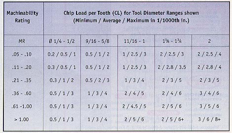

Table B: Chip load per tooth
Feed per tooth (chip load) selection.
These values are presented in a simple tabular form to ease selection (Table B). They are based on MR percentages, type of roughing tool - coarse or fine pitch - and tool diameter.
Comments about Step 3: It is not recommended to run below the minimum chip load or above the maximum CL. If the type of pitch (coarse, medium, fine) is not known, here is a useful rule of thumb: Measure the knuckle depth of the rougher to be used (major diameter of tool minus minor diameter divided by 2, or the depth of the knuckle, measured from the top of the knuckle to its bottom). Use a percentage of this dimension as the feed per revolution. For example, use 50 percent of the knuckle depth as feed per revolution on a material with an MR of 0.60 to achieve a medium-heavy feed per tooth. Reduce the value for harder materials or wide cuts, and increase it slightly for softer materials or shallow cuts.

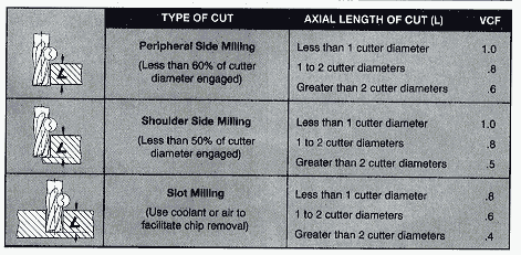

Calculate the Volume Cut Factor.
VCF is based on the theory that a tool with a specific geometry, length, diameter, number of flutes, etc., can remove a specific volume of a particular material without breaking. Let’s say that a 1"-dia. tool is successfully cutting at 2 times its diameter (axial length of cut) and 0.5 times its diameter (radial width of cut). The feed is 10 ipm. The cut volume calculates out to 10 cu. in. per minute (2 5 0.5 5 10 = 10). To change the cutter-engagement values, we could change a couple of the parameters and still come up with the same VCF.
For example, we could alter the radial width of cut by one-half (0.25 5 tool diameter) and double the feed rate (20 ipm). The resulting VCF would remain the same (2 5 0.25 5 20 = 10). As long as you stay near the recommended chip load, the parameters can be varied and combined so that the operation can be performed in the quickest, most efficient way possible without breaking the tool.
The material volume and VCF are established on the basis of the type of cut (peripheral side milling, shoulder side milling, slot milling) and on the axial length of cut in relation to the tool diameter. The resulting multiplier is plugged into the formula in Step 5 to modify the feed-rate value. Use Table C to establish the VCF.

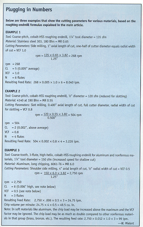

Calculate the feed rate. The feed formula includes the values calculated in the previous steps (rpm, CL, VCF) multiplied by the number of flutes (N) the roughing mill has. Enter the values established in Steps 2, 3 and 4 into the following formula:
Feed rate (ipm) = rpm 5 CL 5 VCF 5 N
Comments about Step 5: It’s recommended that you choose feed and speed values somewhat conservatively when starting out to make sure that your fixturing is adequate and that your machine has ample power. Increase the cutting speed and feed rate in 5 percent increments to find the optimum, aggressive parameters acceptable in terms of machining results vs. tool life.
Note: If you arrived at a low VCF and you also have chosen a low CL, the resulting feed per tooth may be below the recommended minimum CL. Adjust your rpm downward to reach a feed per tooth at or above the recommended minimum.
It takes only a short time to perform these calculations - one or two minutes. But you will find that it’s time well spent, as your machining time decreases, tool life increases and you start machining more accurate parts.
