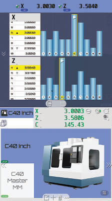

BIG DAISHOWA's SPI
BIG DAISHOWA’s SPI (Simple Post Interface) enables operators to measure tools, print labels and scan the data directly into their machine tool control.

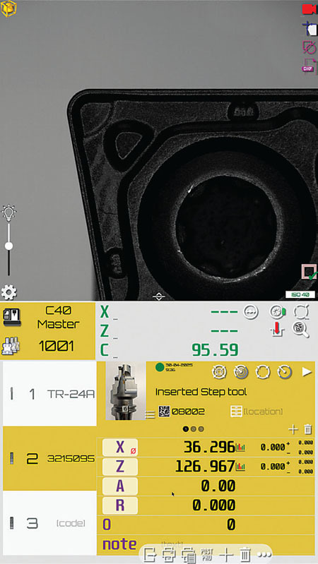

Presetter inspection camera view
Presetter inspection camera view can be used to check for damaged cutting tool edges. Lyndex-Nikken

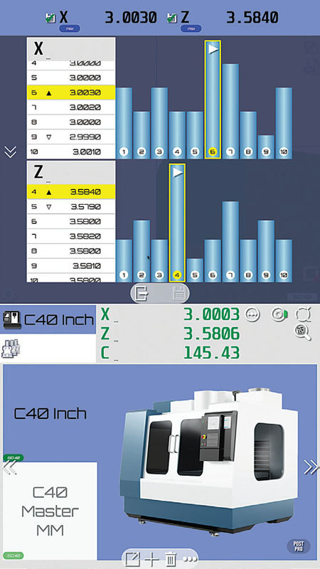

Autofocus of the presetters C axis
Autofocus of the presetters C axis can measure a tool 360° to increase operator efficiency. In this case, a shell mill with 10 inserts was measured. Lyndex-Nikken

One of the most overlooked benefits of presetters is visual inspection. Holden noted that modern presetters include cameras or lights that allow operators to inspect tool tips before they go into the machine.
“Chipped inserts, worn tools — these are often caught after a part is ruined,” he said. “A presetter lets you catch it before it happens.”
Hartman shared the story of a shop that used custom reamers. They began using their presetter exclusively for inspection. “They weren’t even using it to post offsets — just to inspect geometry and avoid scrapping expensive parts.”
And in many shops, where complex step tools like hydraulic porting reamers are used, presetters are invaluable. “If the distance between features on that tool is even slightly off, it can ruin the part,” said Hartman. “Presetters measure those distances to the micron.”

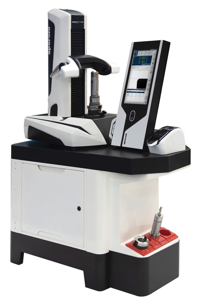

BIG DAISHOWA's entry-level SPERONI STP ESSENTIA tool
BIG DAISHOWA’s entry-level SPERONI STP ESSENTIA tool presetting and measuring system provides essential basic functions. BIG DAISHOWA

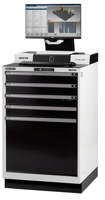

This UBI tool management system
This UBI tool management system (shown at right) from BIG DAISHOWA features the company’s INTELLIGO software, and together these systems provide real-time stock status. BIG DAISHOWA
