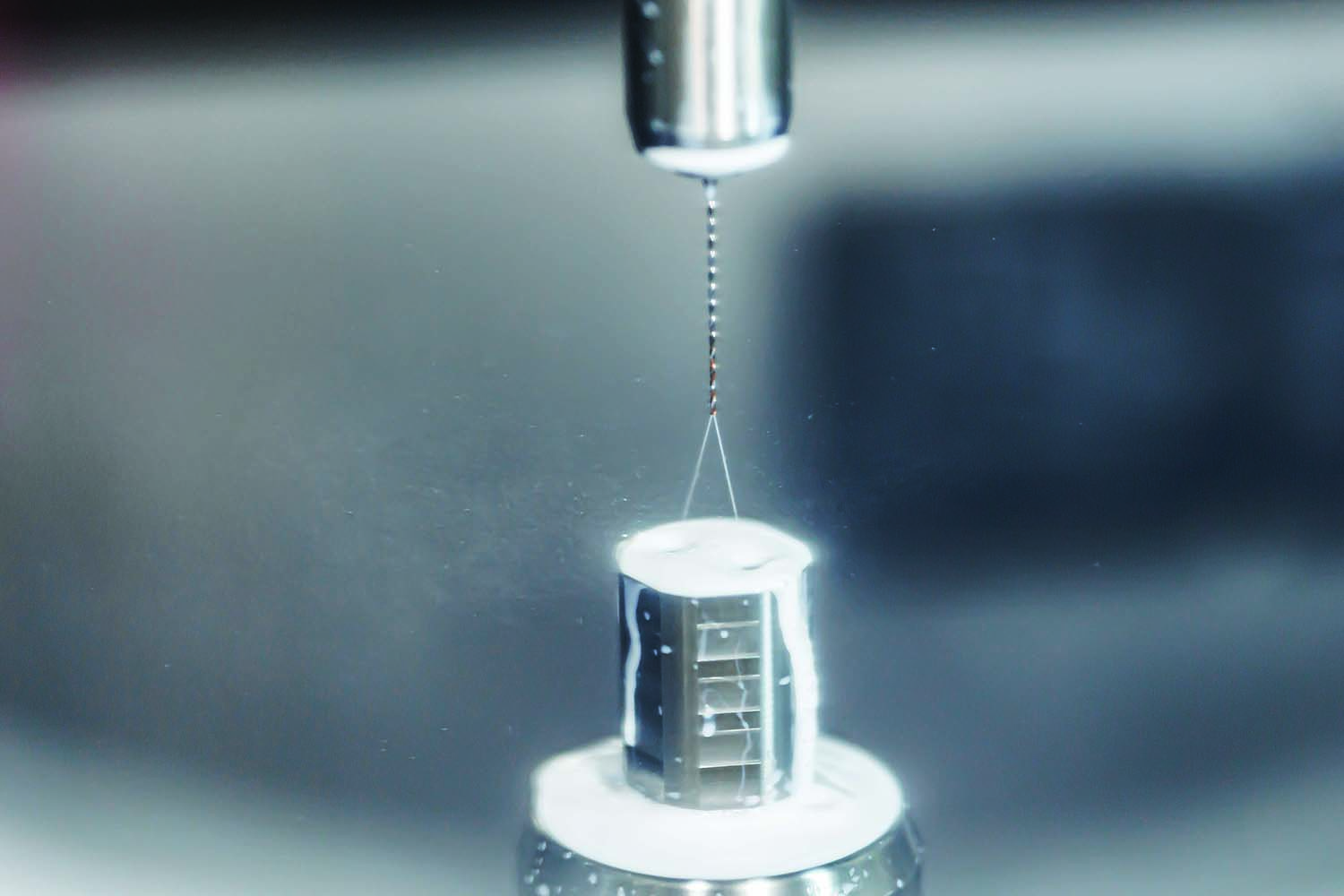

Successful deep-hole drilling is hardly easy. Move it into the microscale, which generally is considered to be no more than 3 mm (0.12") in diameter, and the process becomes even more challenging.
Deep hole is a relative term, with the consensus that it starts at three diameters deep, but cutting tool manufacturers offer microdrills for going deeper — sometimes considerably deeper. Sandvik Coromant Co. in Mebane, North Carolina, for example, offers the CoroDrill 462 and CoroDrill 862 microdrills for producing holes up to six and 16 diameters deep, respectively, said Cory Schwenke, product manager for solid round tools.
He added that there are variations to those product lines. The solid-carbide CoroDrill 462 microdrills are available uncoated in diameters from 0.03 mm (0.0012") to 3 mm and coated with titanium aluminum nitride in diameters from 0.2 mm (0.0079") to 3 mm. The toolmaker produces solid-carbide CoroDrill 862 microdrills for going up to 16 diameters deep and ones made from polycrystalline diamond for reaching 12 diameters deep. CoroDrill 862 microdrills are coated with titanium aluminum silicon nitride, with silicon enhancing the coating’s heat resistance.
“When you’re drilling, heat is the devil,” Schwenke said. “It can cause a multitude of problems.”
Therefore, coolant is required to bring down the temperature when deep-hole microdrilling. The CoroDrill 462 line requires external coolant to be applied while CoroDrill 862 carbide tools 1 mm (0.039") and larger have coolant channels. The smaller carbide tools, as well as all the PCD ones, receive external coolant, he said. Hole depth also plays a role, with either external or internal coolant being suitable for holemaking up to nine diameters deep and internal coolant only for making holes 12 to 16 diameters deep.

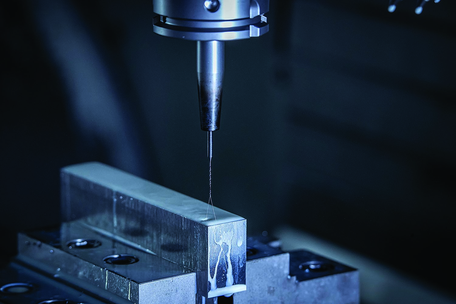

Ceratizit USA Inc. in Schaumburg, Illinois, also provides microdrills for going deep. Its WTX Micro drills are available in diameters from 0.8 to 2.9 mm (0.031" to 0.114") for going up to 30 times diameter, said Patrick Maigatter, product manager for cutting tools and holemaking. The through-coolant tools are suitable for drilling metals that generate relatively short chips that can be evacuated out of the tiny holes.
WTX Micro drills are available in diameters from 0.8 to 2.9 mm for going up to 30 times diameter.

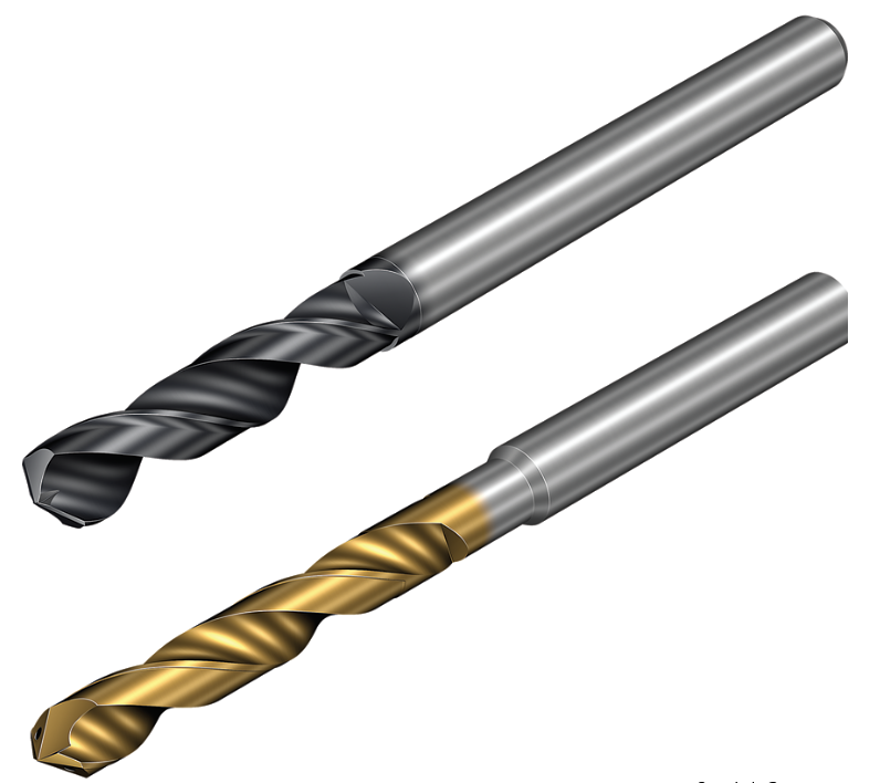

Schwenke said CoroDrill 862 tools have the -GM geometry to create a more optimized drill for a specific task than the CoroDrill 462.
“If you’re looking for an optimized product where you’re running large batches of the same application, the same material, and you really want to nail down your process,” he said, “that’s where you’re going to go with the 862.”
On the other hand, Schwenke said the CoroDrill 462 features the -XM geometry, which is more versatile and better suited for shorter runs of multiple jobs.

Maigatter said a milling machine should have an internal coolant pressure of at least 30 bar (435 psi).
“The longer the tool,” he said, “the higher the pressure should be.”
Maigatter added that a machine’s coolant system should have a 10 µm (0.00039") filter or finer to prevent recirculated particles from clogging the tiny coolant channels.

CoroDrill 462 tools (top) feature more versatile, general-purpose -XM geometry while the CoroDrill 862 (bottom) has the -GM geometry, which can be optimized for a specific application.
CoroDrill 462 tools (top) feature more versatile, general-purpose -XM geometry while the CoroDrill 862 (bottom) has the -GM geometry, which can be optimized for a specific application. Image courtesy of Sandvik Coromant
