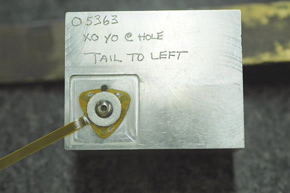

• Permanently engrave important offset and program information directly into your soft jaws. Then you’re not trying to figure it out in 6 months when the job repeats. Extra information available at the machine during setup reduces mistakes and increases setup speed and confidence.
• Cut a pickup feature or features directly into your fixtures and soft jaws. There’s nothing like a good round hole marked X0/Y0 to set up from the next time you use a fixture.
Figure%207-28.tif
All images courtesy T. Lipton
Engrave important program and offset information directly into fixtures and soft jaws.

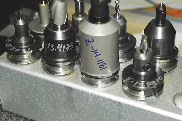

• A silver metallic felt pen provides a quick, easy way to mark a tool offset directly on a black-oxide toolholder. It only takes a second to record an offset and it’s cheaper than tags. Heck, I can’t even buy the nifty little tags for my BT-35 holders, so I improvise like a true cheapskate.
Figure%207-32.tif

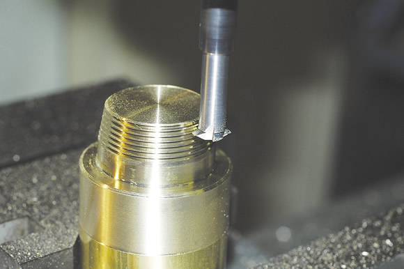

In addition to milling common thread pitches, a single-flute thread mill can mill those oddball thread pitches that come up every once in a while.
• If you haven’t tried thread milling, you should. Sometimes it’s the only way to thread a delicate part. When thread milling, the cutting forces are low and it’s easy to adjust the thread-pitch diameter for a perfect gage fit. You can also cut a full-engagement pipe thread with less than the full depth of hole you would otherwise need, even with a short projection pipe tap.
• Don’t stress too much about ramp-in and ramp-out moves if you are manually programming thread milling. The straight-in approach works fine and is easier to think about than ramping moves the first few times you try it. Most of the time, you are ramping into air or a thread relief. You can use G41/G42 tool compensation if you like to adjust the diameter, but this can be a little tricky to do down the hole of an internal thread. I generally do the entire thread without tool compensation and adjust the X or Y point where the tool starts to orbit for the helix. I put a marker in the program so I can find it easily. With a single-flute thread mill, you can also mill those oddball thread pitches that come up every once in a while.

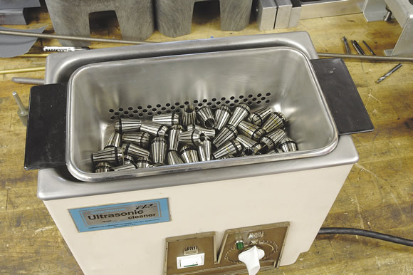

A great way to clean collets is in an ultrasonic cleaner.
• I’m sure everybody has experienced the weird phenomena of an endmill or drill lasting for hundreds of parts and then, after replacing the tool “just in case,” having the new tool last for only one part. Check a few of your ER-style collet setups for runout when that happens. You might be shocked at what you find. These collets are not automatically accurate. This is particularly important with small tools that cannot tolerate much runout in proportion to their diameters. If you find runout, thoroughly clean the collet and holder. The culprit is usually the inside surface of the nut and collets, which have coolant residue or small burrs on them where the nut contacts the collet.
• A great way to clean collets is in an ultrasonic cleaner. Small chips and debris worm their way into the collet slits and ruin accuracy. Use a heated solution of degreaser, such as Simple Green or Omni-All, followed by drying and dipping in lightweight oil, such as M-1 or WD-40. CTE
