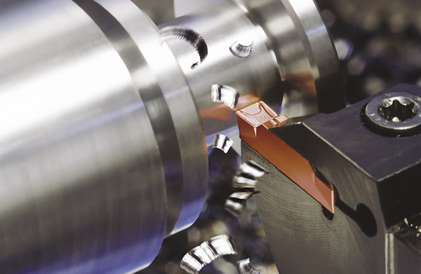

The lathe is one of the first machines tool and die students learn to operate. Image courtesy Sandvik Coromant.
