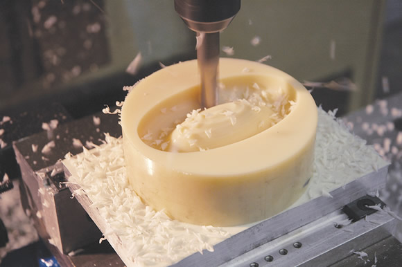

A trick I gleamed from a friend reveals an interesting use of relatively crash-proof soft metal or plastic bed plates on a milling machine. In the shop where my friend works, they prepare the part blanks and secure them to the bed plate with Permacel double-sided tape. Plastic locating pins are used to index the part for the second-side operations. This technique, used along with hot-melt glue filling (see the August 2013 “Shop Operations” column), allows the “unmachinable” to be machined with ease, such as delicate parts that cannot tolerate any clamping force without distortion.
For example, hot-melt glue supports a difficult-to-hold part for two-sided machining, and the part is held with double-sided tape to a freshly surfaced subplate. The first side of the part is faced and then surface contoured to the part’s halfway point. Be sure to slightly overlap the parting line if applying a ballnose endmill.

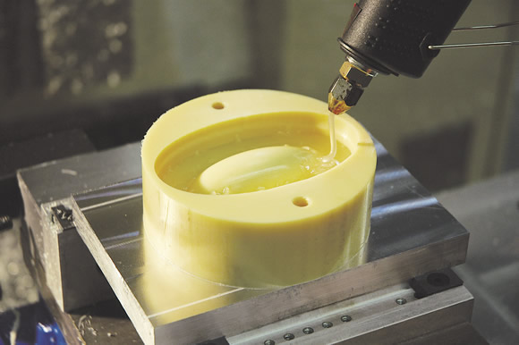

After machining the first side, spray the machined cavity and part with a little mold release and fill with hot-melt glue. For a large volume of glue, fill an inexpensive Teflon-coated pan on a hot plate to make quick work of melting the glue.

Double-sided tape holds this workpiece to a freshly surfaced subplate.

Filling the cavity around the part with hot-melt glue.

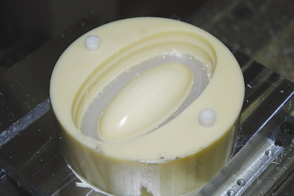

Surfacing the second side of the part exposes the hot-melt glue the first side was filled with.

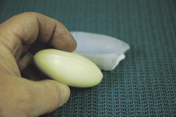

An example of a difficult-to-hold part. When the last hunk of hot-melt glue is pulled off the part, the finished part is exposed.
Add the locating pins at this point so the second side of the part is perfectly indexed. Plastic pins are used in case the contouring tool bumps into the pin while the part is being cut. They are only needed when the part is indexed and secured with the double-sided tape. I leave them in because it’s easier and I’m paranoid about a workpiece not remaining perfectly secure when using double-sided tape.
After the glue solidifies, reface the first side of the part to the Z-axis zero point. Use a low rpm, or spindle speed, to prevent the glue from remelting. You need a smooth, solid surface for the second side of the part so the double-sided tape has enough surface area to hold it. This method is great for the delicate parts that cannot tolerate any clamping force without distortion.
Surfacing of the second side of the part exposes the hot-melt glue that the first side is filled with. Technically, the part is floating in space, with no connection to the original blank other than the glue.
For the next step, I simply use a bandsaw to remove the excess material to get close to the part. Be sure to run the saw slowly because otherwise it will remelt the glue and make a mess of the saw. When the last hunk of hot-melt glue is pulled off the part, the finished part is exposed.
For thin-shelled or other difficult-to-hold parts, this method can produce fantastic results. CTE
