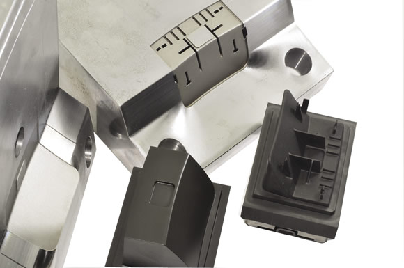

GF AgieCharmilles LLC, Lincolnshire, Ill., is another EDM builder touting new technology. Its IQ generator promises faster production, improved electrode life and finer finishes, in some cases dramatically. For example, a test case suggests upwards of 90 percent reduction in electrode wear is possible.

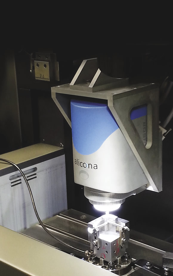

EDM Department performs in-process measurement on a Makino EDAF 2 sinker EDM using an Alicona white light measurement system.
Much of this reduced electrode wear comes from better spark control. “Micrographs of the burn area on older machines show kind of a random, splashy-looking spark discharge,” Baeszler said. “This led to inefficient stock removal and high wear rates. But if you look at an actual spark discharge on a new AgieCharmilles, you’ll see a perfectly smooth puddle of molten material. This is a result of our digital manipulation of the spark discharge, assuring a much more efficient spark, with less thermal damage to the workpiece and far less electrode wear.”

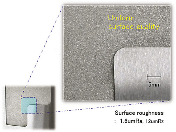

Deep burning is the focus of the new SuperSpark IV graphite technology from Makino Inc., Mason, Ohio. “One of the most prevalent processes we see in sinker EDMing nowadays is rib machining for plastic injection-mold features,” said Brian Pfluger, EDM product line manager. “This typically requires a very narrow, blade-type electrode, maybe 0.040 " wide at the tip with a 1° draft angle, to burn slots from 2 " to 4 " deep.”
In this scenario, wear is especially critical when in the roughing mode, which uses negative polarity. Therefore, 30 to 50 percent of the electrode might be gone before the electrode goes 1 " deep. “Negative polarity burns produce very aggressive metal-removal rates, but to the detriment of electrode life,” Pfluger explained.
Switching to positive polarity, typically for finishing, is a good news/bad news situation. “Due to positive polarity’s conservative cutting action, you could get by with one electrode but won’t deliver parts until Christmas,” he said.
According to Pfluger, SuperSpark increases production rates by automatically alternating polarity during the burn. This provides speeds equivalent to that of negative-polarity burning but with the electrode wear seen in positive-polarity conditions.
“SuperSpark gives you reasonable speed, but with total wear levels as low as 1 percent,” he said. This means a shop can use the same electrode for the entire burn and still achieve a uniform 40µin. Ra surface finish or finer in most materials. For most work, no further processing or hand polishing is required, according to Pfluger.

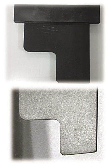

With the ability to machine electrodes on the fly, there’s no longer a need to premachine all the electrodes you think you might need. Shops can simply start burning and see how things go. Add the ability to measure the electrode and the workpiece with inline gaging and the door to unattended machining opens even wider.

Someone who can speak to this point is Mark Raleigh, CEO at EDM Department Inc., a machine shop based in Bartlett, Ill. “With our closed-loop method, we don’t have to make a series of electrodes up-front,” he said. “We start with the initial electrode and evaluate the results after the first article. Since we have introduced sensing capability into the machine, we can measure wear, surface finish and form all in one system, while the process is running. Now, based on this capability, we can be proactive instead of reactive.”
That sensing capability is the R25, a high-resolution, 3-D scanning system from Alicona Corp., also based in Bartlett. As Raleigh explained, integrated measuring capability is critical to success with today’s short lead times and small lot sizes.
Raleigh said: “Manufacturing is dynamic in nature. You can plan all you want, but oftentimes you end up executing far differently because the information has evolved. The ability to dynamically measure wear and overburn and then feed this information to a cell controller means you can be more flexible, more efficient and, therefore, more profitable.”
