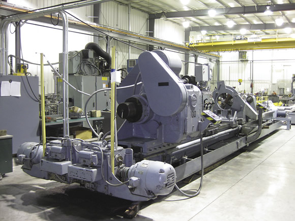

Chesterfield Tool uses this gundrilling and deep-hole boring machine renovated with a high-speed gearbox to drill small-diameter holes.

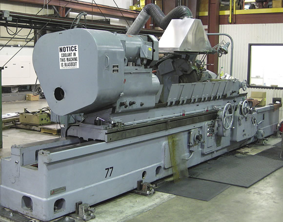

Chesterfield Tool grinds shafts from 5 " to 8 " in length with a 0.0002 " tolerance on this OD grinder.
