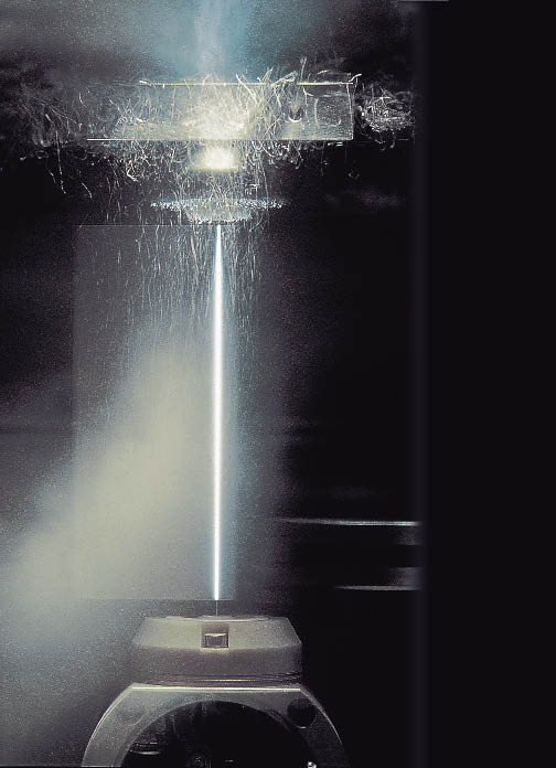

Wire EDM vaporizes material via a series of rapid electrical discharges delivered by a thin wire, usually brass. The procedure often is performed under water and the path of the wire is controlled by computer, which permits the sculpting of intricate geometries. While EDM can only work with conductive materials, it is especially effective machining hard metals.

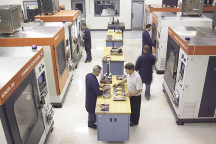

Equipped with 40 GF AgieCharmilles and Sodick EDMs, Xact Wire EDM serves the medical, aerospace, electronics, energy and packaging industries. And the company finds wide applications for EDM prototyping. “For parts that are getting smaller and smaller, especially for medical or aerospace, the machining choice moves closer to EDM,” said Stamm, adding that because EDM exerts no cutting force, it does not stress fragile and micro parts.

Using 0.008 " stratified wire, “we started with sheet stock and cut the ID and OD,” Stamm said. “As soon as you separate [a stainless steel part] from its parent material, it’s going to spring because stainless loves to move around.
“The wire releases any kind of stresses already in the material; usually it moves parallel to the surface about a couple thousandths of an inch.”
