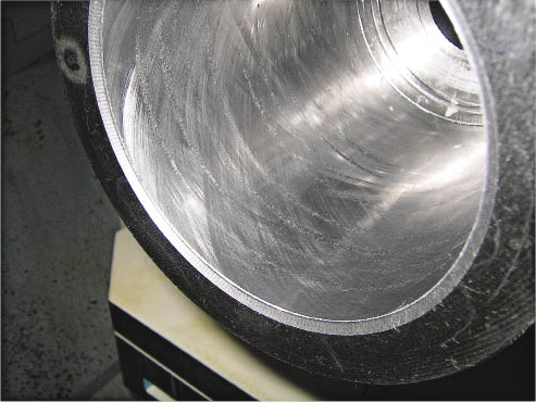

A honed CGI test cylinder illustrates the surface finish that can be achieved without handwork.

As previously reported in Cutting Tool Engineering, Makino worked with Sandvik Coromant to develop a process and tooling that allows CGI cylinders to be finished at cycle times similar to those for gray cast iron ones. The cylinder bore is rough plunged with a CoroMill 210 high-feed facemill. Then, instead of applying a boring head, a special prototype long-edge plunge milling cutter tooled with indexable inserts finishes the bore via circular interpolation. The tool design allows the entire length of the bore to be cut in one helical revolution rather than having to make possibly 50 to 100 single helical passes, according to Makino.
“The inserts overlap perfectly so you don’t have one insert leaving a witness mark or telltale of its path,” Weidmer said. He added that the body of the long-edge plunge mill has milled pockets to hold ground inserts in a precise location, which reduces vibration and enables imparting a finer surface finish.
However, Weidmer noted that not all CNC machines are able to helically interpolate equally, a process that involves side load and can generate vibration. “The higher-end machining centers are much better at interpolating, or swinging, a circle and holding roundness,” he said. “Anytime you replace a boring tool with a helical milling process, the ability to hold roundness comes back to the accuracy of the machine, its control and its ability to make perfect circles.”
Weidmer added that helical interpolation requires communication between a machine’s servos and control to generate an accurate toolpath, especially when circular interpolating at a high feed rate. “To circular interpolate with a CNC machine, the two ballscrews [for the X and Y axes] must reverse direction every 90°,” he said, adding that a popular drawing toy functions as an analogy. “Similar to drawing a circle on an Etch A Sketch, you must reverse the direction of one of the knobs. The back and forth synchronization must be precise to make a perfect circle at high speeds.”
In addition, a rigid machine tool increases the accuracy of helical interpolation. “Added rigidity is a definite plus,” Weidmer said.
