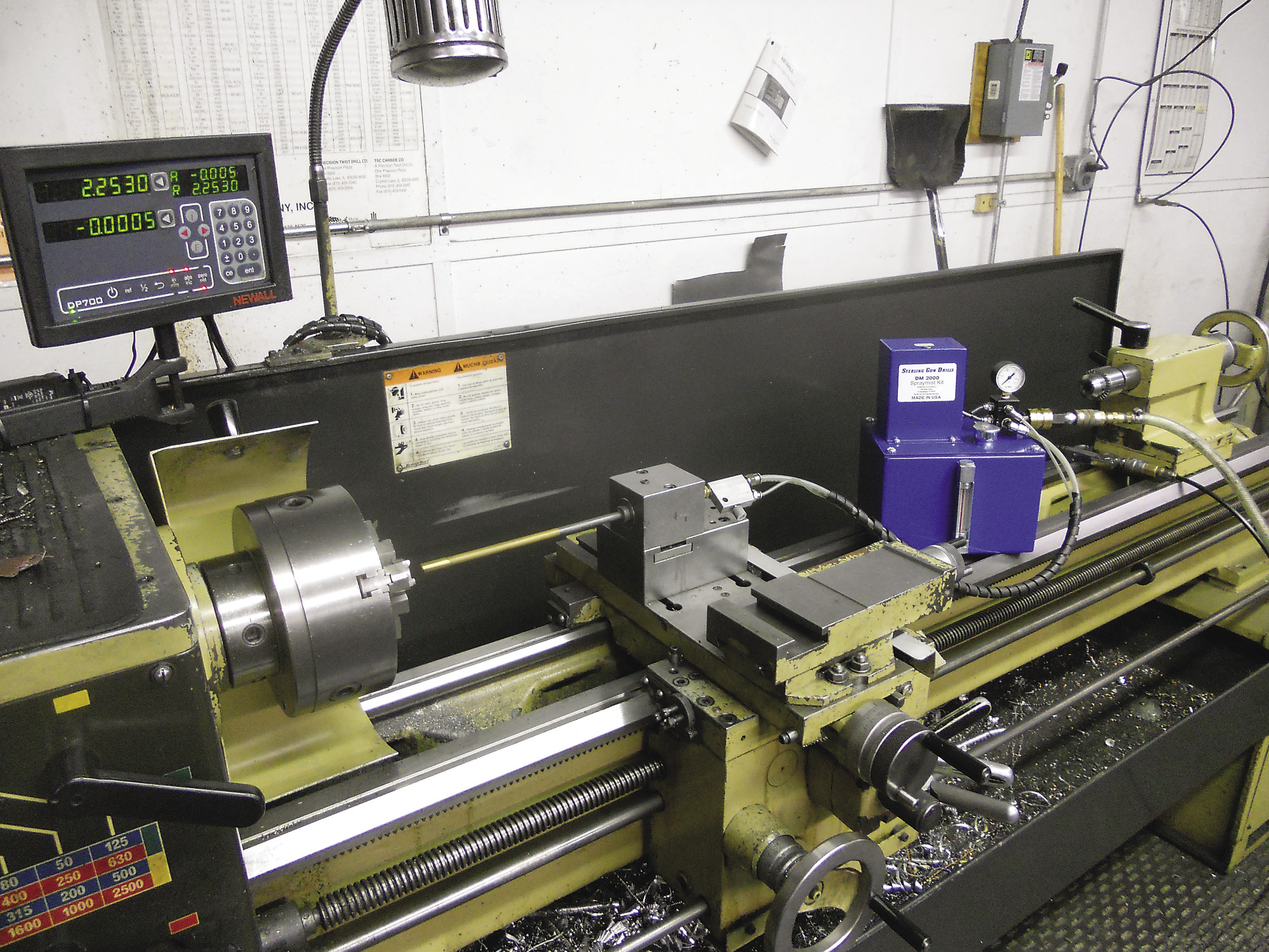

Although CNC equipment is the primary producer of gundrilled holes, even that old manual engine lathe in the corner can be converted into a decent gundrilling machine. “You have to make sure the available feed rate is low enough,” Holley noted. “A 0.250″ gundrill in steel might feed at just 0.0005 ipr, which is tough to achieve on a manual machine. In this case, special gearing or an auxiliary feed motor to drive the tool might be needed. Alignment is also very important. Some people just mount a block of steel on the saddle and bore the toolholder directly in the machine. This works pretty well and takes advantage of a machine that otherwise might sit idle.”

Sometimes any machine will do when gundrilling. Here, an engine lathe has been equipped with a spray-mist unit and the tool block carefully aligned to make an effective gundrilling machine. Image courtesy Sterling Gun Drills.

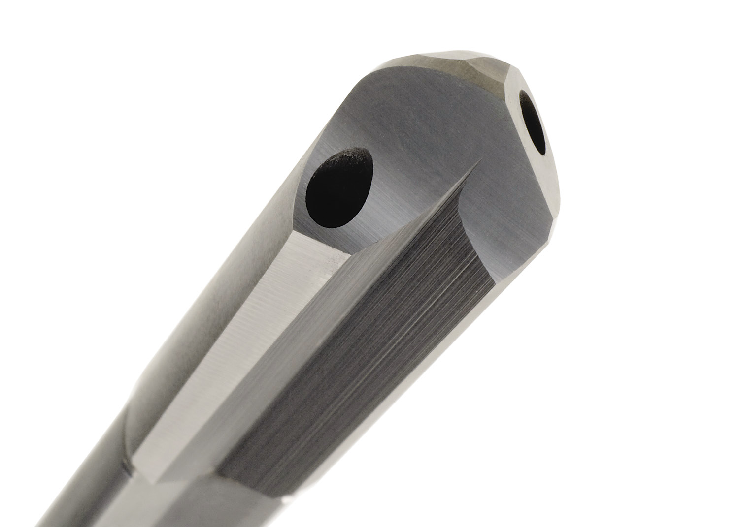

Cross-holes are another potential problem. Most gundrills have a single coolant hole. When drilling hydraulic housings, crankshafts and similar parts, coolant flow to the cutting edge is lost when the tool breaks through into intersecting passages and cavities, as these present an alternate route from which high-pressure fluid can escape. The result is dramatic heat increase, chip packing and, quite often, tool breakage. To avoid this, Cella recommends a gundrill with two coolant holes: one traditional hole exiting the end of the drill and a second hole directing coolant to the cutting edge. This maintains a constant flow of cutting fluid around the drill during breakthrough to prevent catastrophic failure.

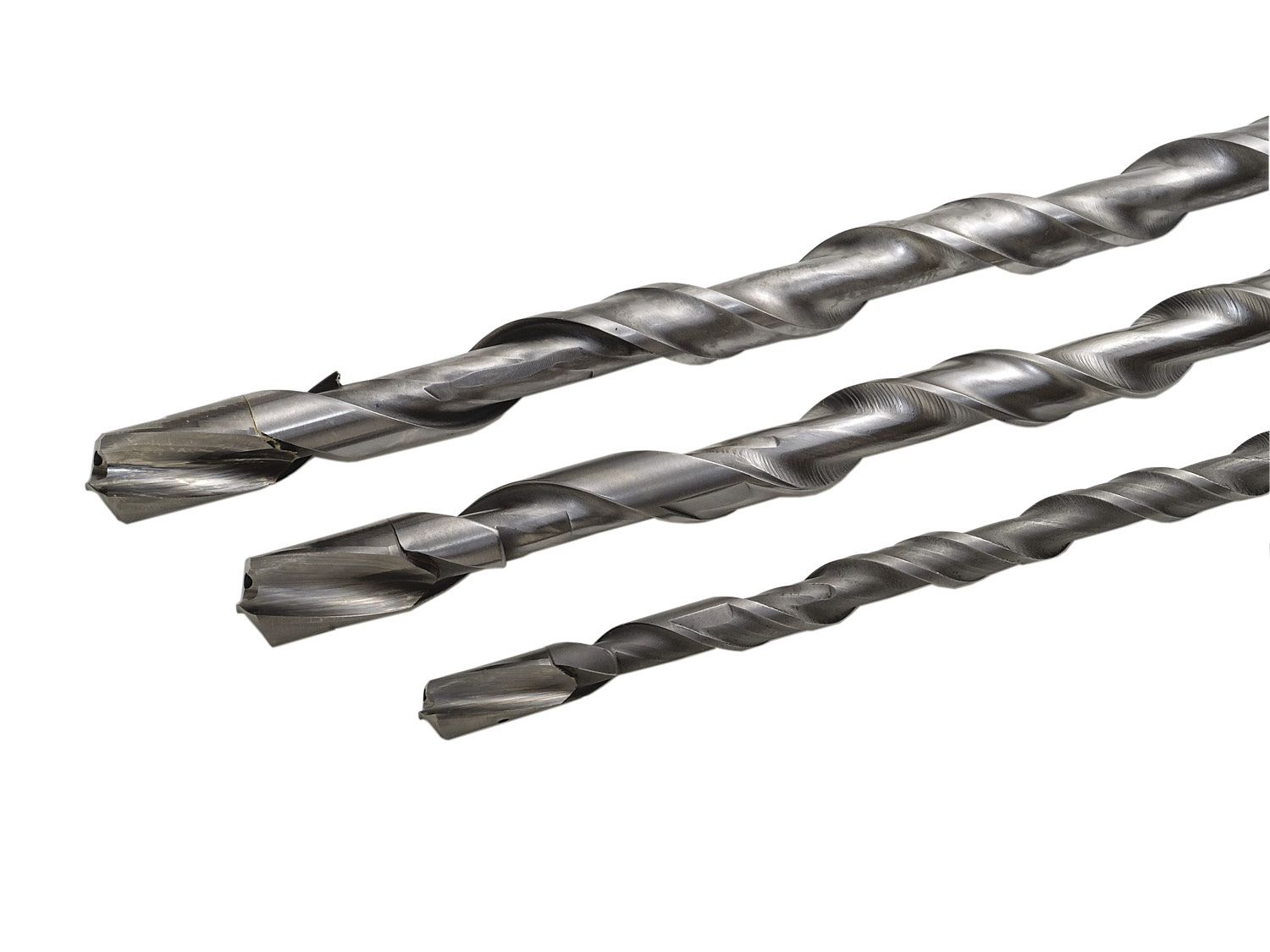

Arlington, Texas-based Iscar Metals Inc. is another toolmaker with a few gundrilling tricks up its sleeve. Drilling Product Manager Pat Cline agreed that clean, high-pressure cutting fluid is key to successful gundrilling, but said temperature is another important consideration. “It’s best to keep it in the 70° to 75° F range, but definitely not above 130° F. Above this temperature, viscosity starts to fall off and the cutting fluid becomes ineffective.”
Cline added that many shops select a general-purpose tool, which may be sufficient for the job, but different materials and applications often call for fine-tuning. “To realize the most benefit, selecting a tool designed specifically for the job at hand can lead to big productivity and quality gains.” Different edge preps and coatings, double-margin or flat-bottom drills, serrated inserts for improved chip control and single- or multiple-flute tools are some of the many options available, and choosing the right one can improve surface finish, straightness and, especially, throughput when gundrilling.

Double Jet gundrills from Star SU feature two coolant holes. This provides additional cutting fluid and helps prevent tool wear or even catastrophic damage in cross-hole applications, according to the company. Image courtesy Star SU.

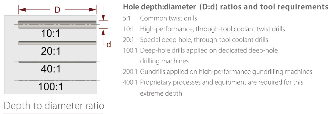

This holemaking guideline illustrates the depth-to-diameter ratios at which a dedicated gundrilling machine becomes necessary. To read a sidebar with more information about UNISIG’s in-house deep-hole drilling operations on conventional CNC machines and the dedicated gundrill machines it builds, see below. Illustration courtesy UNISIG.

Choosing the right drill also depends on the machine tool. Iscar offers solid-carbide, deep-hole drills down to 0.035″ (0.889mm) in diameter, which are a slam dunk on Swiss-style lathes, if high-pressure coolant is available.

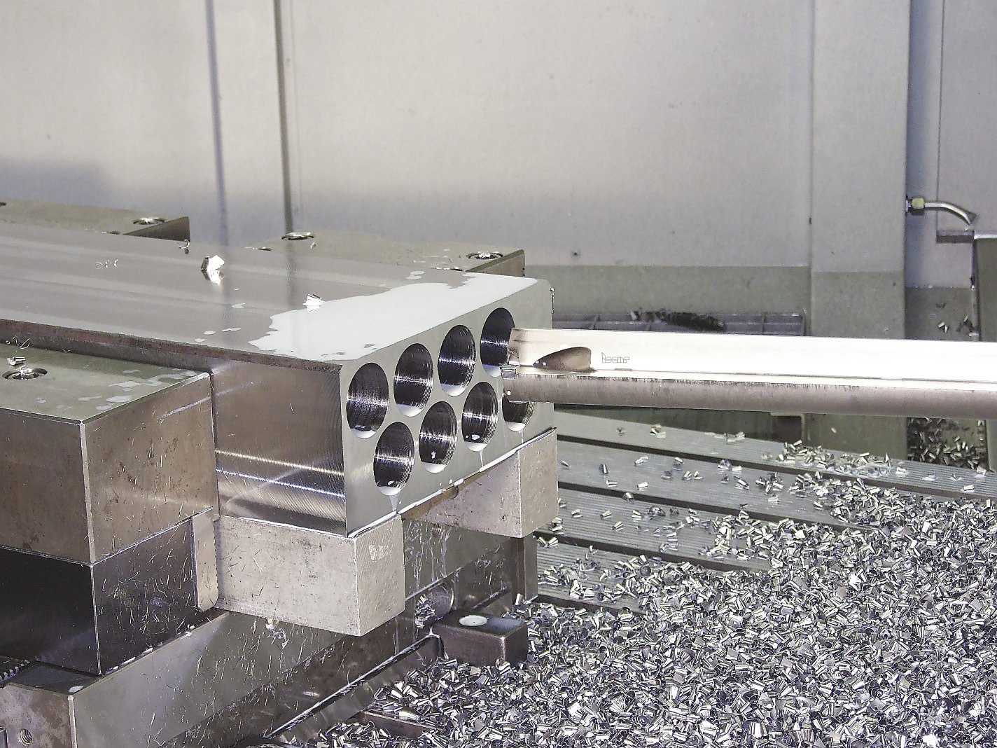

Another common application is mold and die work, where horizontal machining centers are used to drill cooling passages in mold bases. In both instances, gundrilling on the same machine that produced the parts avoids having to move workpieces to another machine for a secondary operation. Such delays can be costly and accuracy may suffer as a result of refixturing.

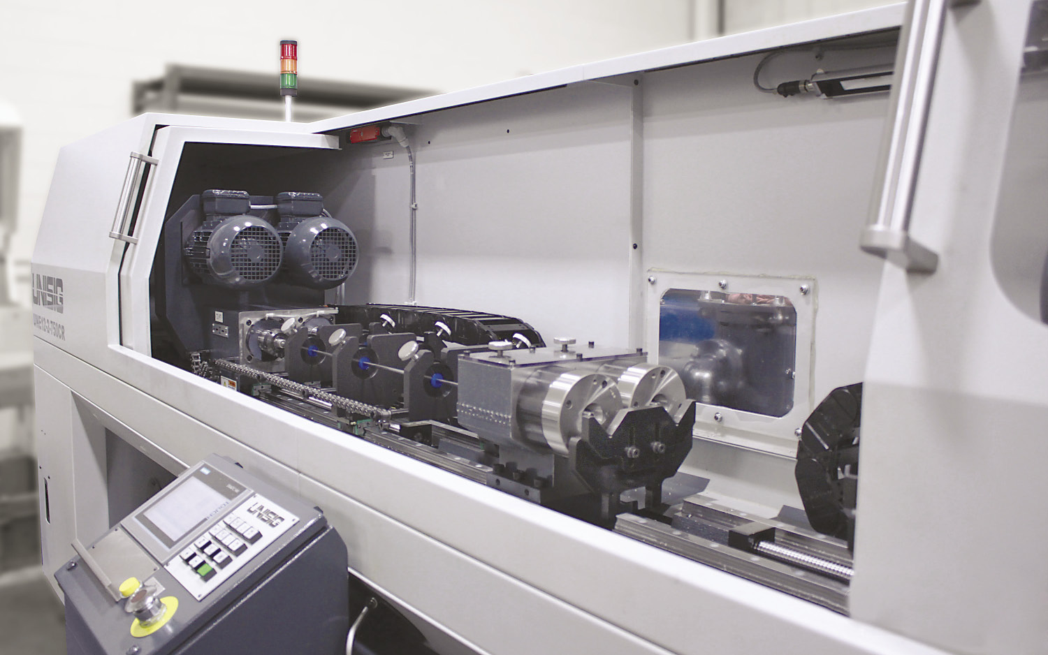

Anthony Fettig, CEO of UNISIG, Menomonee Falls, Wis., said his company performs gundrilling on conventional lathes and machining centers all the time. “It works great.”
That may seem an odd statement from a builder of gundrilling machines, but Fettig said there’s a fairly clear line that defines when dedicated gundrilling equipment is necessary. “We figure depth-to-diameter ratios greater than 40 to 1, maybe 20 to 1, as the point where shops should consider deep-hole drilling machines over lathes and machining centers.”
Conventional thinking
Dedicated gundrilling machines are often equipped with dual spindles for twice the production output compared to single-spindle machines. Image courtesy UNISIG.
What’s so special about a drilling machine that costs $150,000 and up? One feature is a counter-rotating tool and spindle, which provides “ultrastraight holes,” according to Fettig. For example, a 1⁄4” (6.35mm) hole drilled 100″ (2,540mm) deep could be expected to hit a bull’s-eye smaller in diameter than a pencil and be round within 0.0005″ (0.0127mm) or better. This extreme-depth capability is because of the high cutting fluid pressures available on these machines. Where 1,000 psi (69 bar) is common on Swiss-style lathes, most gundrilling machines provide two to three times that pressure.
Another key advantage is electronic monitoring of the machining process. “We keep a close eye on pressure and flow rates, as well as power and thrust in the drilling process,” Fettig said. “The difference between a sharp tool and a dull tool, or a chip forming properly or binding in the tool, is very subtle. A little flicker of the power bar graph on a CNC machining center isn’t going to do it for you.”
These data points are collected by the drilling controller and dynamically graphed on the machine interface, recording recent events, changes and trends, automatically interrupting the cycle in the event of a problem. This lets operators optimize the drilling process and prevent damage to a workpiece, which may cost as much as the machine tool itself.
Despite the high level of control and commensurate drilling performance that comes with dedicated deep-hole drilling equipment, Fettig maintains gundrilling on conventional machine tools remains a viable approach, provided the work doesn’t fall outside the working boundaries of the equipment.
“Gundrilling for us is often a matter of extremes,” Fettig said. “On one end, we routinely drill holes 6″ in diameter and 30′ deep, and one tool might produce 2,000 to 3,000 lbs. of chips per hour, using 200 horsepower or more at the spindle. Conventional machine tools can’t do that. We’re doing a job right now calling for 0.030″ holes, 1.6″ deep with a very close tolerance. You might drill a few of those on a machining center, but you’ll probably only manage it a few times without issues. Do it a thousand times and you’ll end up with a pile of broken carbide next to the machine. Everything has to be just right to be successful at work like this. That’s the world we live in.”
