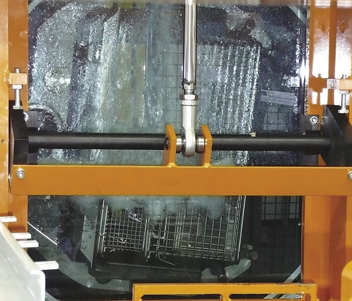

Solvents are employed in closed-loop cleaning systems that comply with directives for volatile organic compounds. The cleaning process can be divided into several phases, such as cleaning, vapor degreasing, rinsing and drying. (For more about vapor degreasing, see the sidebar on this page.) Parts cleaning machines with multiple fluid tanks make it possible to integrate and use different solvent tanks. For example, a machine can be set up for preliminary cleaning, fine cleaning and corrosion protection.
Modern cleaning systems are equipped with an integrated distillation unit, which continuously removes oils and greases from the solvent. Additionally, these machines offer a filtration unit equipped with bag or multiple-tube filters for removing particulates like swarf, chips and burrs. The unit is usually integrated into fluid loops. When the solvent removes large quantities of metal particles from the parts, a magnetic separator can be integrated into the filtration system. These features enable the solvent to be used in a closed-loop system and assure consistent cleaning quality and low solvent consumption.

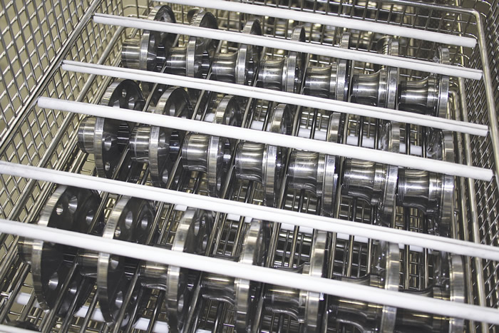

The container that holds parts to be cleaned also plays an important role in the quality and efficiency of the cleaning process. Regardless of whether parts are cleaned in bulk or individually, it’s recommended that cleaning containers be made of rust-free, round, stainless steel wire. These provide effective, complete access to the parts by the cleaning medium and the cleaning method, such as ultrasound waves or spray.
Another key aspect is the positioning of the part in the carrier; it must positioned so as to allow critical areas of the component to be accessed directly and treated in a targeted way.

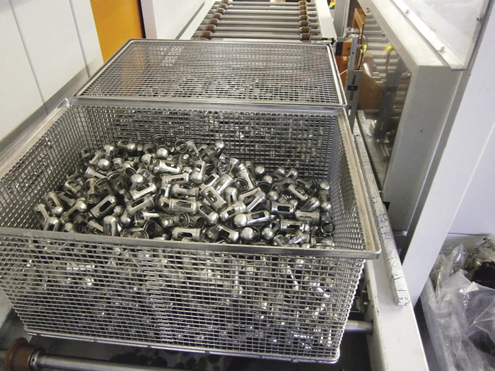

Once parts leave the cleaning facility, their cleanliness must be maintained throughout all subsequent steps, such as picking, inspection, transport, storage and packaging. Simply enclosing or covering the area where cleaned parts are removed from the cleaning system protects them from recontamination by environmental impurities, such as dust and oleiferous air.
For parts with high cleanliness requirements, it is advisable to perform parts removal, inspection and packaging in a clean area or clean room with properly trained and equipped personnel. Volatile-corrosion-inhibitor packaging materials are available to protect cleaned parts from corrosion. These packaging materials create a corrosion-proof atmosphere inside a package while providing protection from outside contamination.
