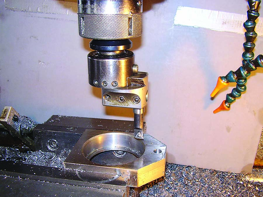

This article is about boring holes with a milling machine. I make a huge variety of parts in quantities of one or two. This is not about large-quantity manufacturing. That’s a different world from where I live. Here, I’ll discuss how to make a bore to accept an SKF 6207 ball bearing unit that has an outer diameter of 72 mm.
I use a 2" Criterion boring head that is direct-mounted to a toolholder with a 7/8-20 thread. This boring head has an indexed dial screw with 0.001" gradations for setting the boring diameter, so I’m using inch dimensions in this column. Besides, my customer gave a print of the part to me that specifies the bore as 2.8351"/2.8344".
The part and the boring tool are on the milling machine.
Figure 1: The part and the boring tool are on the milling machine. Image courtesy of B. Taylor
There is some machinist’s skill involved with the boring that can make the process easy and reliable. I find this kind of job fun to do. Accuracy has value, and it can be rewarding in money and satisfaction. Also, this customer has been coming back for 35 years, and I like that scene.
Figure 1 shows the part and the boring tool on the milling machine. Before boring, I make the hole 0.1" undersize with a 0.5" roughing endmill, then 0.06" undersize with a finishing endmill. This part has a land in the hole for the bearing to seat against. The depth and inner diameter of that feature are set with the endmills. Then the boring operation takes place.
Note the indexable tool. Carbide holds edges longer than high-speed steel tools, and for fussy dimensions it saves trouble. If an edge goes dull partway through the process, it can result in an oversize bore and a piece of scrap.
There are 5.5" between the point of the tool and the spindle nose. There is going to be deflection in the cutter setup when making a cut. The faster the metal removal, the more deflection there is. And remember that deflection makes chatter, and then the surface finish will be bad.

This bore has a tolerance of 0.0005" with a surface finish better than 63 micro-inches, so care must be taken to hit both marks. The insert has a 0.015" nose radius, and I cut the relief angle on the back of the cutting edge to 30 degrees.
Figure 2 shows the cutter grinder that I use to modify inserts. It uses a cup-shaped diamond wheel. Carbide does wear, and when taking a light cut dullness on the cutting edge makes the tool skate on the surface of the workpiece and creates inconsistent results.
I use a boring cycle on the milling machine: Feed in, dwell at the bottom of the cut, and then feed out. If the tool is cutting while retracting or the finish is inconsistent, then it could stand sharpening.
I have found that taking off 0.015" on the diameter at a feed rate of 1.2 ipm and 200 rpm until the bore is 0.015" under provides consistent results. With smaller bores, I still use the 200 rpm speed because it’s that 5.5" overhang that causes the chatter and not so much the diameter of the bore.

When I reach 0.15", I dress the edge. Figure 3 shows the boring tool with a diamond file. I put on my magnifying eyes and use the file to get a nice, sharp edge. It just takes a touch on the outside of the insert, but, man, it works. Then I run the tool again without coolant and check the measurement and finish.
Cooling of the tool or workpiece is not needed with this light cut, and I like to see how the work is progressing. Is the finish nice and consistent? (Fun is where you find it.) Then cut to 0.005" under and check to see if the tool took out the dialed-in cut. Cut to 0.002" under, measure again, and then hit the marks.
This might seem like a lot of time to make one bore, but if it comes out big or rough, then I will need to start the whole job again. Well, you get the picture.
