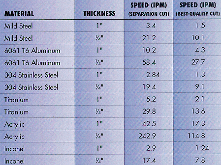

AWJ Table #1
Table 1: &Nbsp;Recommended speeds for the AWJ machining of various materials with 1/4" and 1" thicknesses. These speeds are based on a waterjet pressure of 55,000 psi, an orifice diameter of 0.015", and a nozzle diameter of 0.045".
