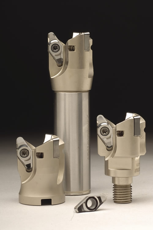

Millstar offers a new line of indexable-insert cutters for milling aluminum. Image courtesy Millstar.

He explained that the Millstar endmills and shell mills for cutting aluminum are made with a fine-grain carbide with a low cobalt content so the substrate provides enhanced hardness and wear resistance. Also, the flutes are polished to make them as slippery as possible and minimize aluminum’s tendency to stick to their surfaces, while an upsharp chipbreaker improves chip flow.
v6-engine-block-1009.tif

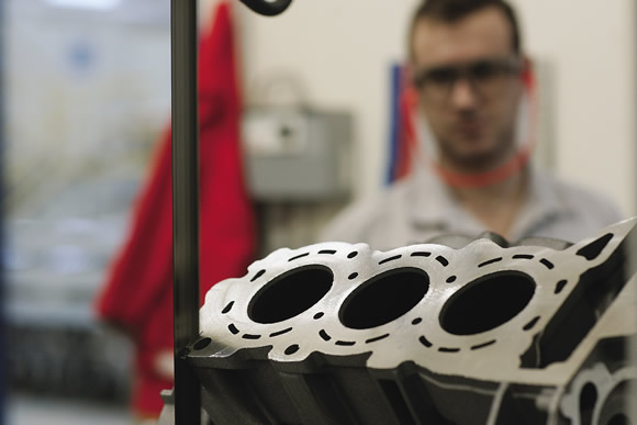

Automotive applications, such as this V6 engine block, are a main mover for the development of new aluminum alloys. Image courtesy Hydro.
To efficiently cut aluminum with the tools, Field recommends a spindle speed of at least 10,000 rpm and high-pressure, through-spindle coolant. However, the tools are also effective when dry machining. For instance, in a demonstration of a Millstar shell mill cutting 6061 aluminum on a Hurco VMX42HSi milling machine without coolant, the tool ran at 18,000 rpm, a feed rate of 1,134 ipm (28.8 m/min.), a DOC of 0.05 " (1.27mm) and a step-over of 1.75 " (44.45mm).
According to Field, the indexable inserts not only make quick work of roughing and finishing aluminum, they last a long time while doing it. “I have a customer who has been using the same insert for 24 hours a day, 7 days a week for probably 3 months,” he said, noting the application is in 6061 aluminum, which is easy to machine.

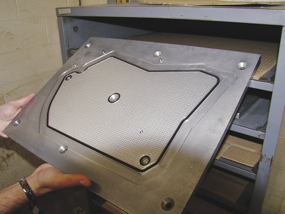

An aluminum top plate for a vacuum fixtures at AT Precision accommodates a specific part shape. Image courtesy A. Richter.

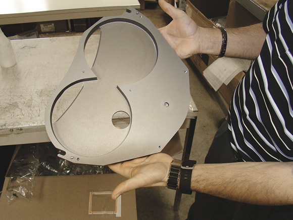

After machining, this feeder pan produced at AT Precision was anodized with Teflon. Image courtesy A. Richter.

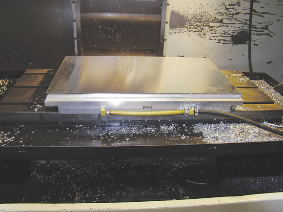

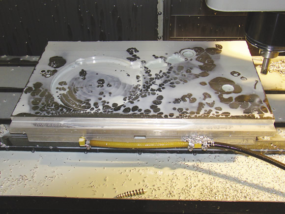

AT Precision cuts the cast plates on 20-hp Haas milling machines with 15,000-rpm spindles and applies general-purpose, water-soluble coolant. The carbide cutting tools for machining aluminum are often uncoated, but Thudium noted TiN-coated tools help prevent aluminum from galling. When a part requires an 8- to 10-rms surface finish, AT Precision applies PCD-tipped inserts, followed by manual polishing to clean cutter lines.
Thudium explained that instead of using workholding clamps, the shop produces vacuum fixtures in-house for holding plates to help minimize part distortion and access five sides of a plate. AT has used the fixtures since it first started machining aluminum (see sidebar on page 46). Each vacuum fixture has a base plate that remains on a particular machine and a top plate that accommodates the shape of the specific part being machined. The plates are changed and stored as needed. The base plates are usually made of MIC6 aluminum as well.
DSC01723.tif
DSC01750.tif
AT Precision machines MIC6 aluminum cast plates on vacuum fixtures it makes in-house to produce feeder pans for the pharmaceutical industry. Above is a workpiece prior to machining. Below is a partially machined workpiece covered with coolant. Images courtesy A. Richter.
The top plate provides a seal for the portion of the plate that’s machined, and if a part requires a through-hole, for instance, a circular seal is positioned where the hole is drilled. “If you break the seal, there is nothing holding the part on the fixture and the part is going to go flying,” Thudium said.
In addition to the pump for creating the suction, the vacuum system includes a water collector to remove coolant so it doesn’t enter the pump.
After roughing aluminum parts, AT Precision sends them to a heat-treatment facility that soaks them in liquid nitrogen to stabilize the parts. “When the parts come back, they go on the same fixtures and we finish-machine them,” Thudium said. “There is very little stress left in the material at that point.”

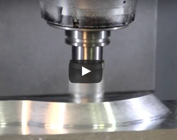

For more information about Millstar’s indexable-insert milling tools for machining aluminum, view a video presentation at www.ctemag.com by scanning the QR matrix code on your smartphone or entering this URL on your Web browser: cteplus.delivr.com/2gd5k
