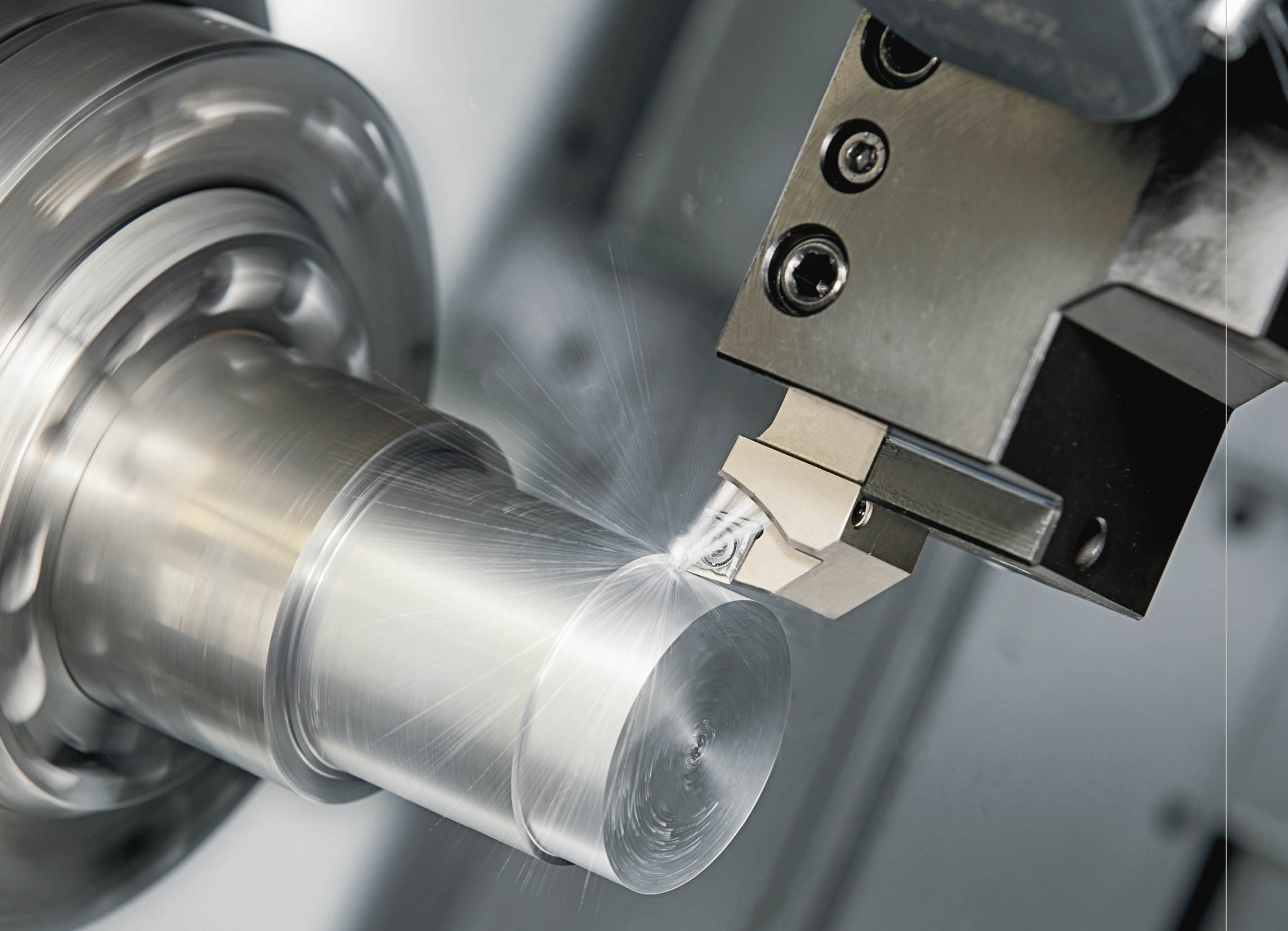

Manufacturing precision turned parts made of titanium – as are frequently needed in aviation and spaceflight, the chemical industry, vehicle construction, and medical technology – requires tools that are suited to machining this particular material. Image source: ARNOMachining titanium is an investment, as it costs about three to five times more than tool steel. So logically, users to avoid waste. The careful selection of a suitable cutting tool is only the first step. Manufacturing precision turned parts made of titanium requires tools that are suited to machining this particular material, allowing for the most stubborn titanium alloys to be machined as needed.

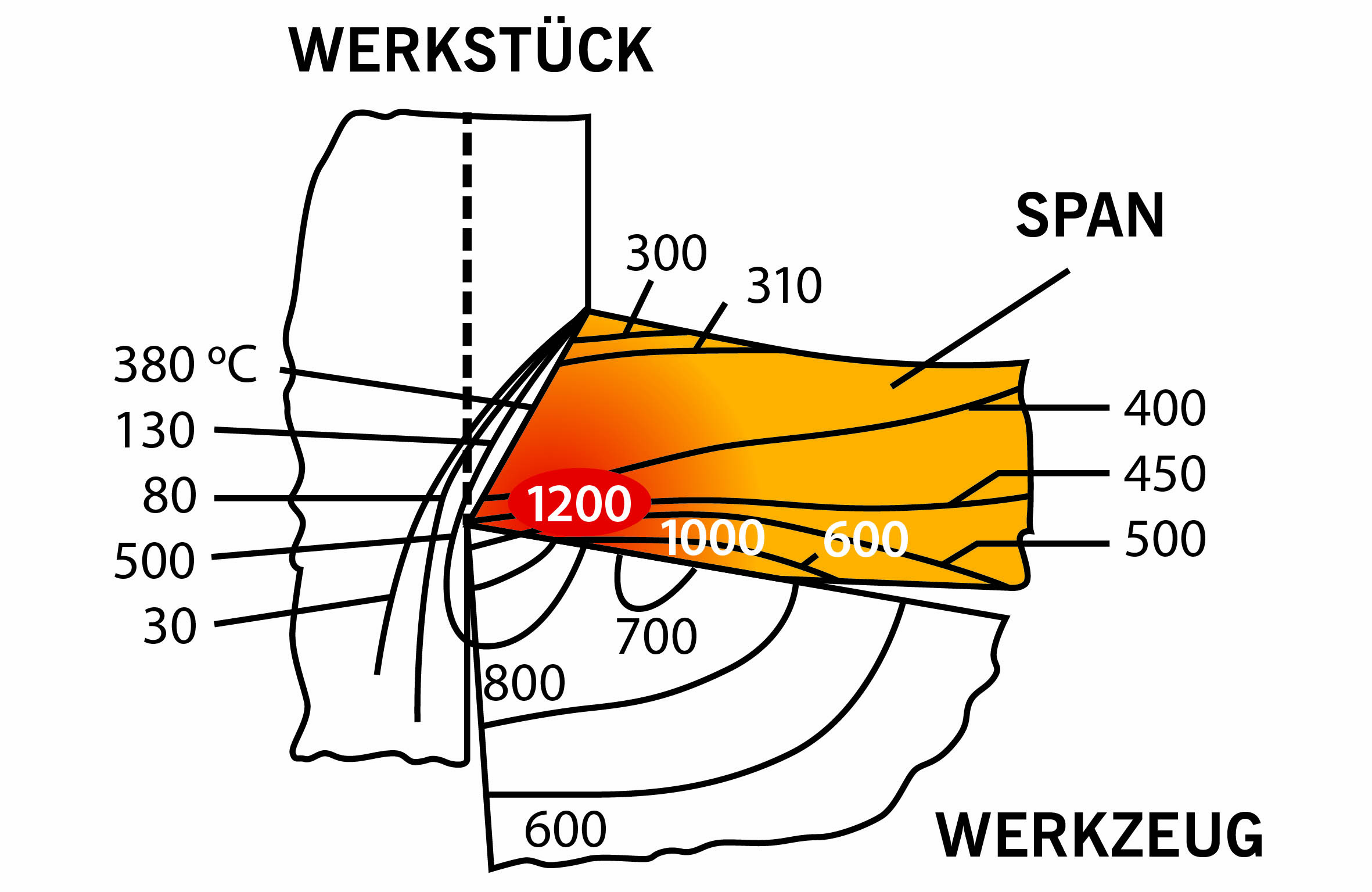

  • ·         High heat resistance (see diagram)

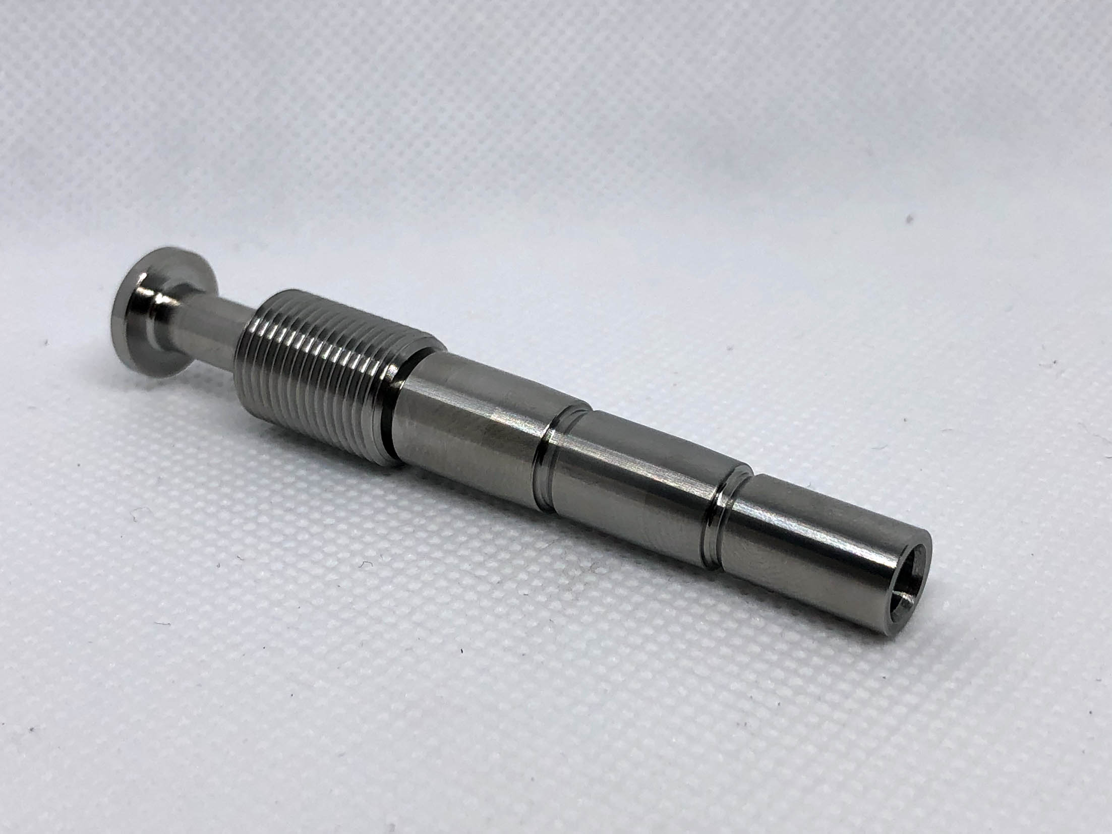

Since only a privileged few manufacture titanium screws for the 1500-HP Bugatti Chiron super sports car, let’s instead take a look at the manufacture of a threaded and grooved shaft made of the standard titanium alloy Ti6Al4V Grade 5/23, as is frequently used in medical technology. With a tensile strength of Rm = 990 N/mm2, yield strength of Re = 880 N/mm2, a hardness of between 330 and 380 on the Vickers hardness scale, and elongation at fracture A5d of approximately 18%, this titanium alloy is typically used for medical implants as well as aviation applications (3.7164) and industrial applications (3.7165). With six percent aluminum and four percent vanadium, and extra-low interstitial elements (ELIs), this alloy is highly biocompatible, inducing virtually no known allergic reactions.

Since titanium is a poor thermal conductor, the heat cannot be evacuated from the cutting zone via the chips. And at temperatures of 1200°C and higher in this area, the cutting tool can quickly sustain heat-related damage. Image source: ARNOTo evacuate heat from the cutting zone requires a high-quality surface finish, reliable process safety, and controlled chip removal, all while keeping process times short despite potentially high rates of chip removal.
Users might assume that most of the heat generated in the turning process is evacuated via the chips, but this isn’t so. Since titanium is a poor thermal conductor, the heat cannot be alleviated from the cutting zone via the chips. And, at temperatures of 1200°C and higher in the cutting zone, the cutting tool can quickly sustain heat-related damage.
The easiest things to do to prevent too much heat from building up are to feed coolant directly to the cutting zone, reduce the cutting force by using a sharp cutting edge, and adjust the cutting speed to suit the process at hand.

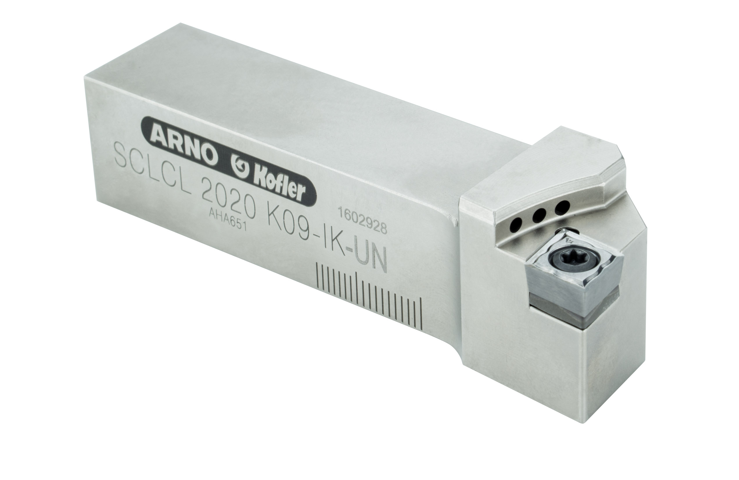

ARNO Werkzeuge offers one of the largest selections of high-positive indexable inserts. The company’s experienced application consultants are happy to share their manufacturing process knowledge. Image source: ARNOThe cutting pressure is reduced by using ground, high-positive indexable inserts with polished flutes, if necessary, with the appropriate coating, minimizing friction in the chip removal process. These three parameters help prevent heat from being produced in machining. If only a little bit of the heat is reduced further through optimal coolant flow, the cutting edge will have a longer service life. Or the cutting speed (Vc) can be increased again to improve productivity.

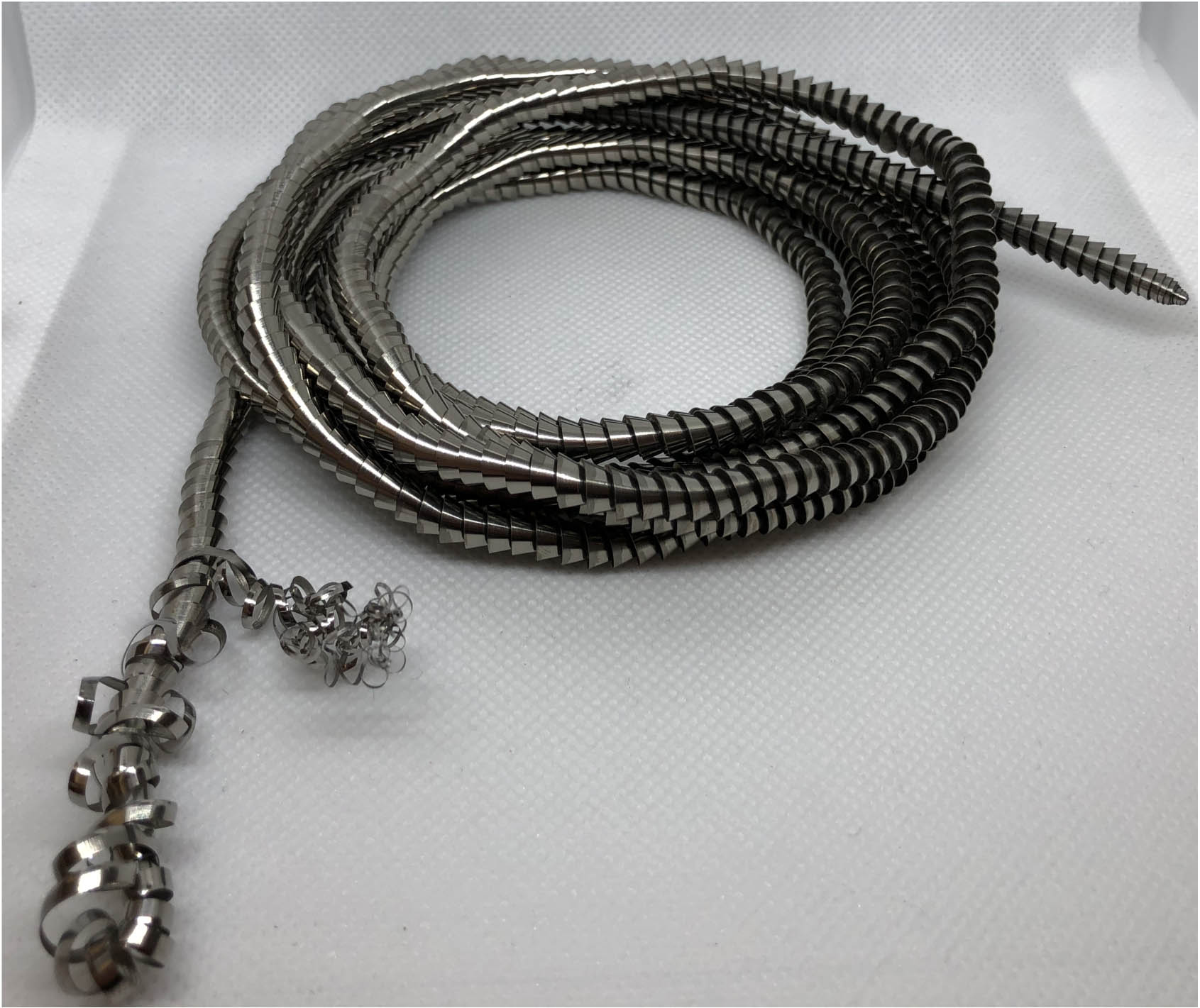

So far, so good. But since the chips don’t like to break, other difficulties may be faced. An endless chip could wind itself around the workpiece, tool, or the machine chuck and pose a hazard to the machine or your safety. It could help to change the direction of rotation and turn the cutting edge around if the machine’s design allows it.
If the cutting edge is pointing downward, chips will fall freely to the ground and no longer pose a danger. However, when working with demanding roughing applications and less-than-stable machinery, users will have to check whether the cutting action allows the chips to be directed towards the machine bed. After the chips have left the work zone, they can no longer disrupt the process.

An endless chip could wind itself around the workpiece, tool, or machine chuck and can pose a hazard to the machine or your safety. It can help to change the direction of rotation and the approach angle of cut. Image source: ARNOTo ensure the user chooses the right tool for titanium machining, turn to a manufacturer. Some go above and beyond, offering advice based on specific application experience in addition to supplying the cutting tool itself.
For instance, ARNO Werkzeuge is a tool manufacturer that has been around since 1941. In addition to manufacturing one of the largest selections of high-positive indexable inserts, it employs many experienced application consultants who would be happy to share their knowledge to ensure that customers’ manufacturing processes run smoothly.
Its high-positive indexable inserts are sharp enough to keep cutting force to a minimum, and their optional rounded edges ensure excellent stability. Expedient high-tech coatings make them well-equipped against the poor thermal conductivity of this tricky material.
Negative indexable inserts with EX, NFT, NMT, and NMT1 geometries provide an affordable, reliable solution for more basic machining and roughing. Arno’s positive indexable inserts with geometries PSF and PMT1 are ideal for machining superalloys. All of these inserts are highly resistant to notch wear and heat when machining tough material. Unique geometries ensure exceptional chip control and process safety. Dedicated titanium machining experts and ARNO customers are well prepared. After all, you never know when you’re going to get that call from a Bugatti engineer.
