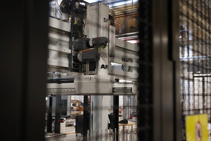

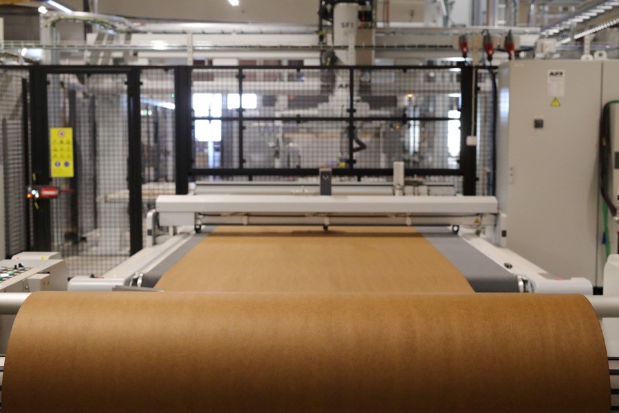

Top: The raw material of PaperShell’s products is reinforced paper on rolls that are cut into “blanks” and are pressed and formed at elevated temperatures. Above: Blanks are moved through the fully automated line with the help of AP&T’s SpeedFeeders. Photo: PaperShell.

With the new material’s specific characteristics in mind, PaperShell and AP&T developed a fully automated, flexible and energy-efficient production line concept making it possible to rationally and efficiently manufacture components for many different areas of application using one line.

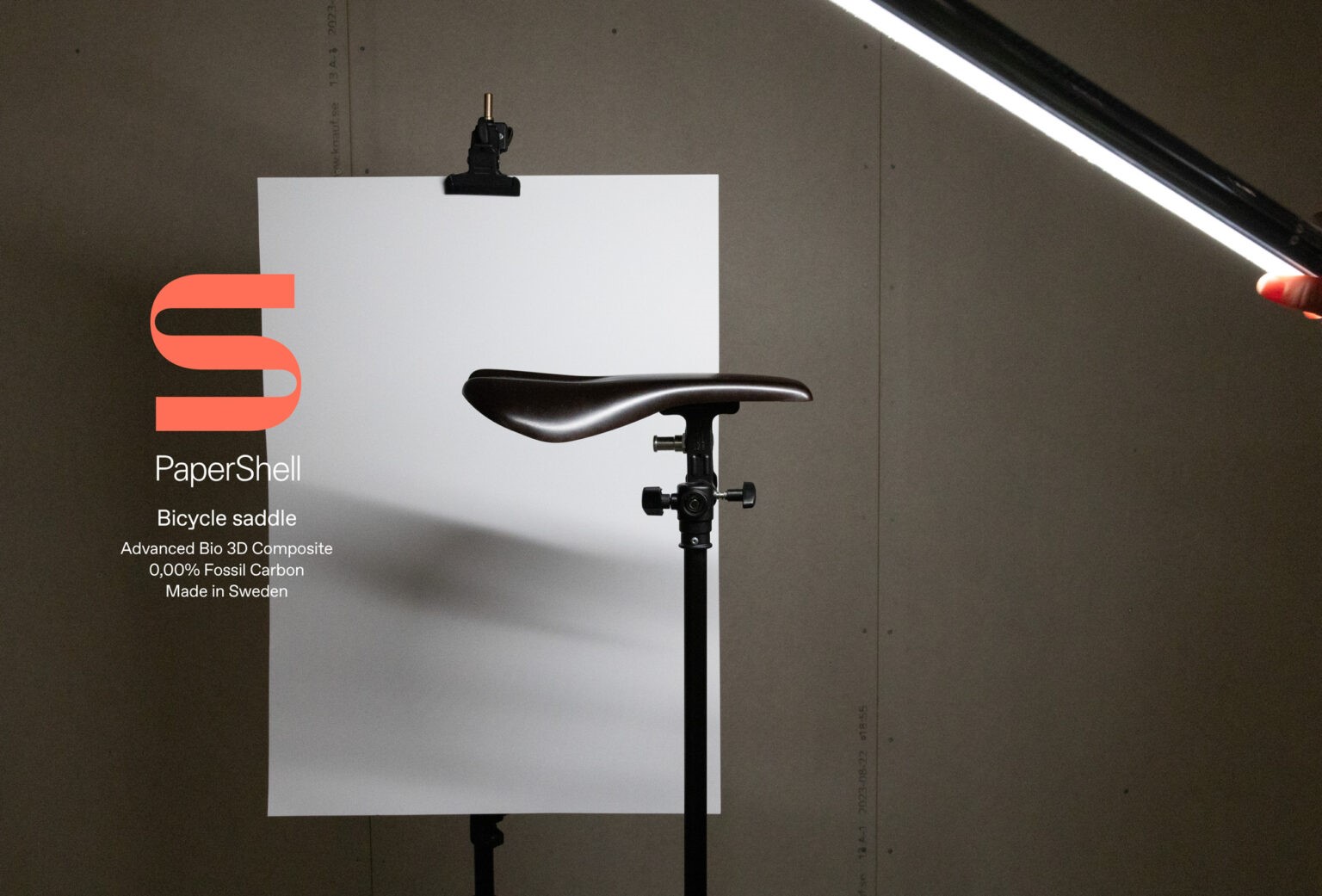

A fossil-free bike saddle made of PaperShell’s fiber composite. Photo: PaperShell
The manufacturing process is fully automated. The raw material is reinforced paper on rolls, which is cut into “blanks”, pressed and formed at elevated temperatures. According to Haglund, the magic is in the combination of heat, pressure and a binding agent.
To minimize the need for intermediary storage, labeling, cutting, stacking and inspection are all done in the same line, and all under the supervision of the line’s process monitoring system which ensures that the end products are of the right quality.
“The technical level of the equipment is on par with the most current press-hardening lines we deliver around the world. This lays the foundation for a stable, secure and extremely energy-efficient process,” he said.
