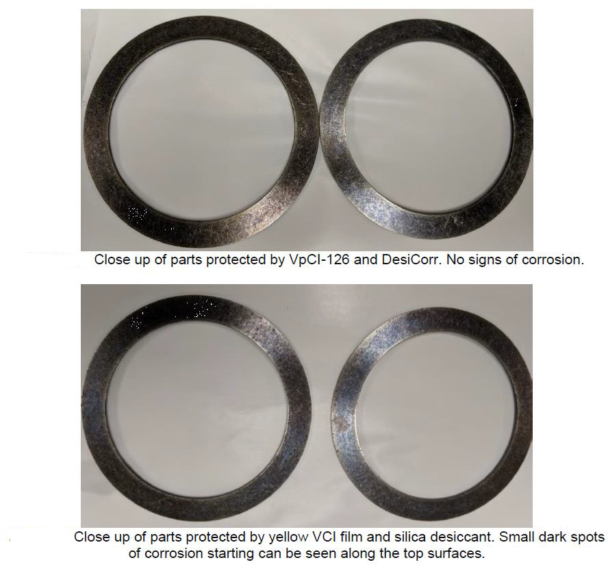

Cortec’s customer manufactures springs and small automotive components. After manufacturing and processing, automotive parts are placed in VCI bags to prevent corrosion during storage and transport. Cortec Laboratories was asked to test the effectiveness of their current VCI bags and desiccant against Cortec’s VpCI-126 bags and DesiCorr. A loosely wrapped bag of VpCI-126 and a 1/6 unit of DesiCorr showed excellent corrosion resistance in ASTM D-173 conditions at 120 hours. No signs of corrosion were seen on the surfaces of any rings tested with VpCI-126 and Desicorr. Rings protected by yellow VCI film and silica desiccant appeared in adequate condition at 120 hours of testing in ASTM D-1735. Closer inspection of rings from this group showed small signs of corrosion starting on the top surface of the rings.
