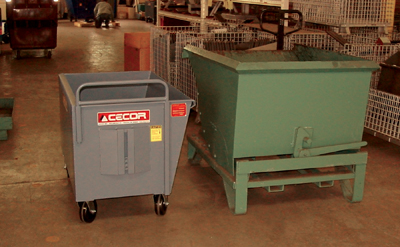

Because the manufacturing floor space is a premium, Cecor designed the DB-244-6P industrial cart to make the best use of floor space.
February 1, 2014
Because the manufacturing floor space is a premium, Cecor designed the DB-244-6P industrial cart to make the best use of floor space. Its small footprint and best use of the cube allow storage and transport of big loads much more than a self-dumping hopper. With a capacity of 13.4 cubic feet (approximately ½ yard) and a lip height of 30″, the DB-244-6P can fit under machine tool discharge, conveyors and tables. Roll heavy loads out of production areas. Fully loaded cart is maneuverable by one person.
The DB-244-6P cart is made of heavy-gauge steel with fully-welded, leakproof seams, and can stand up to rough treatment. Available options are a drain plug and a flip-up drain screen. Dumping trunnions and the companion Dumping Frame DF-1056 allow for easy dumping from hook hoist or fork lift. Carts can also be fitted with T-rail cleats for use with a hydraulic dumping system.
