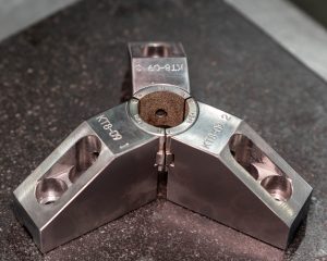

Collet pads & jaws imageMore geometries mean more capabilities
A collet pad top jaw system increases a chuck’s range of workholding capabilities, allowing more varied part geometries to be machined with the same jaw system, which means more business opportunities. Precision ground collet pads provide tight tolerances for workpieces, with full contact across the gripping surface for greater holding power. Full contact of gripping surfaces provides a more stable grip and allows heavier cuts resulting in shorter cycle times. Round, hex, and square collet pad shapes with both smooth and serrated gripping surfaces available, including Carbinite – a wear-resistant textured carbide coating which doubles the gripping strength at equal clamping force. This improved grip on workpieces enhances mill performance and can prolong tool life.
