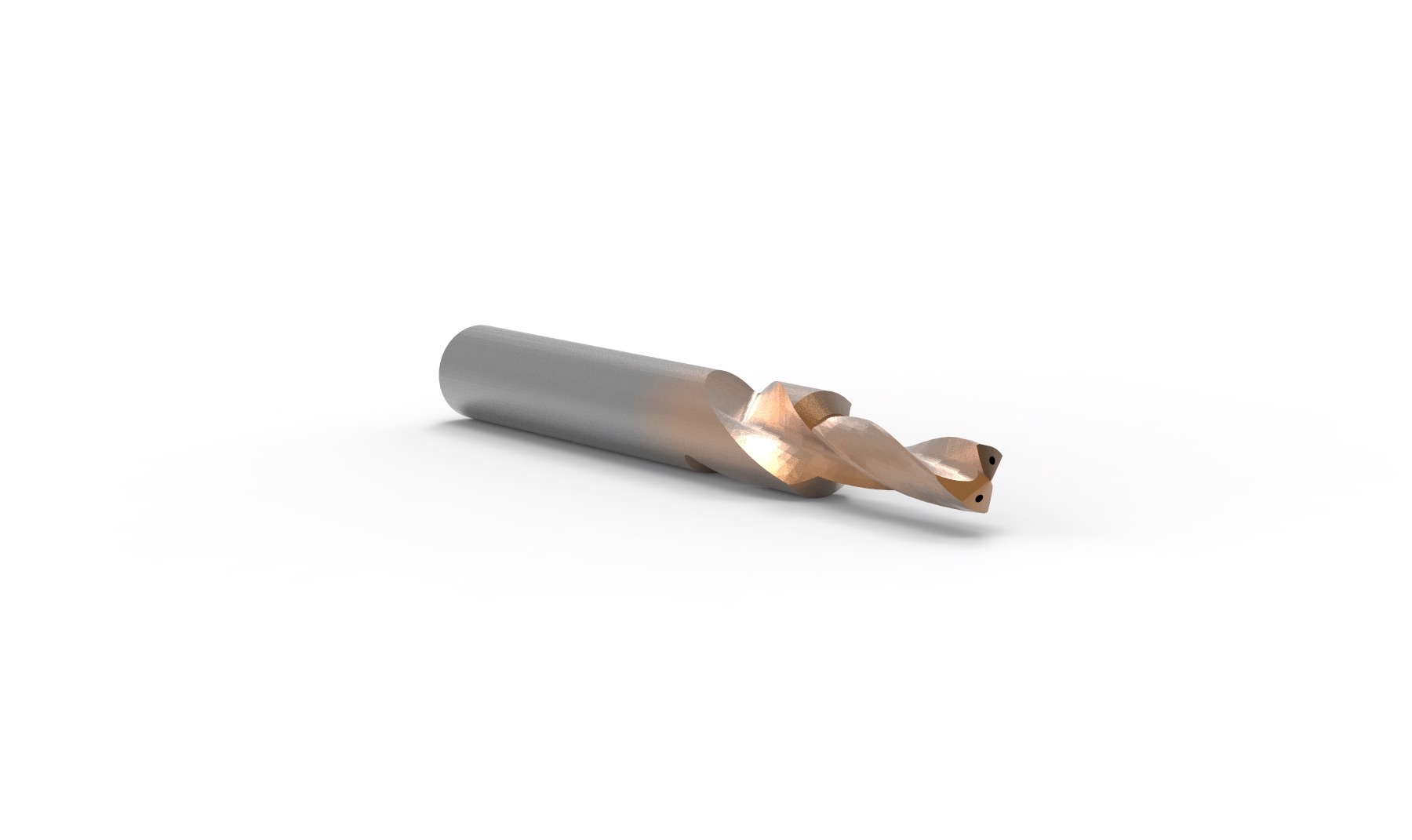

Whitepaper: Benefits of combining cutting operations in a single tool image
A Superion solid-carbide step drill.Images provided by Superion, an Allied Machine & Engineering company.
Another advantage of step tools is for forming complex forms, such as cavity ports that have multiple angles running into radii. The end user can control all tolerances in the tool and would not have to program the complex information into several tools to complete that same difficult form. This means it will result in higher accuracy and faster production, while also maintaining consistency, especially in complex forms.
One key example is SAE and/or ISO hydraulic ports, which feature forms with multiple angles and radii that all need to be controlled within each other. This combination of critical features makes them difficult to produce without a step tool. With combined tools, the port can be drilled from solid to a finished port all in one shot. This can be a significant time saver. All CNC machines use toolchangers, and moving from one tool to the next may take as much as 10 to 30 seconds of cycle time. Remember, in production shops, every second counts.

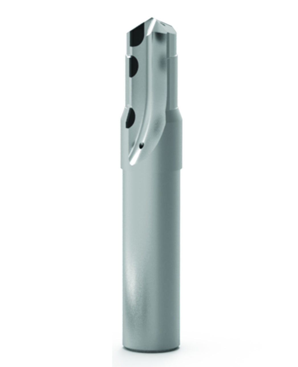

PCD step tools can combine roughing and finishing operations, so operators can drill, mill and ream with one tool.
Many are looking for PCD step tools that can combine rough operations with finishing operations, so operators can drill, mill, and ream with one tool. The combined PCD tools are also being used in the automotive industry for abrasive high-silicon aluminums.
