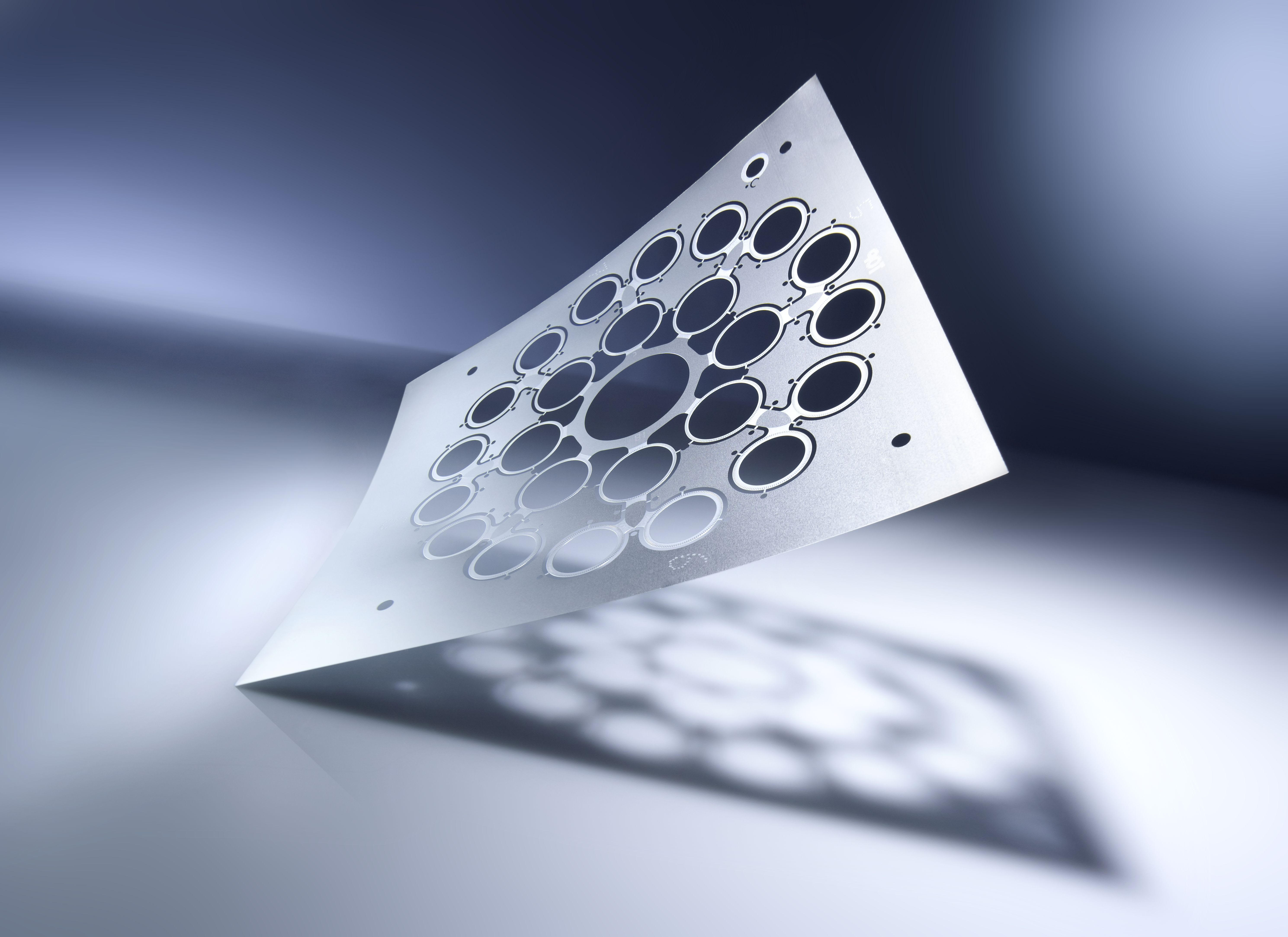

micrometal 1AL. PCE is a technology that manufactures extremely complex metal components with no burrs and no stress-related issues that are common in other metal manufacturing technologies. This is down to the nature of the process which selectively removes material through chemical etching rather than mechanical stamping or high-temperature laser cutting. It is also extraordinary in that it works through the use of inexpensive and easily designed digital or glass tooling, meaning no costly steel tool cutting, no long tooling lead times, and agility and versatility in the tooling process that allows for design tweaks and new iterations at next to no cost.

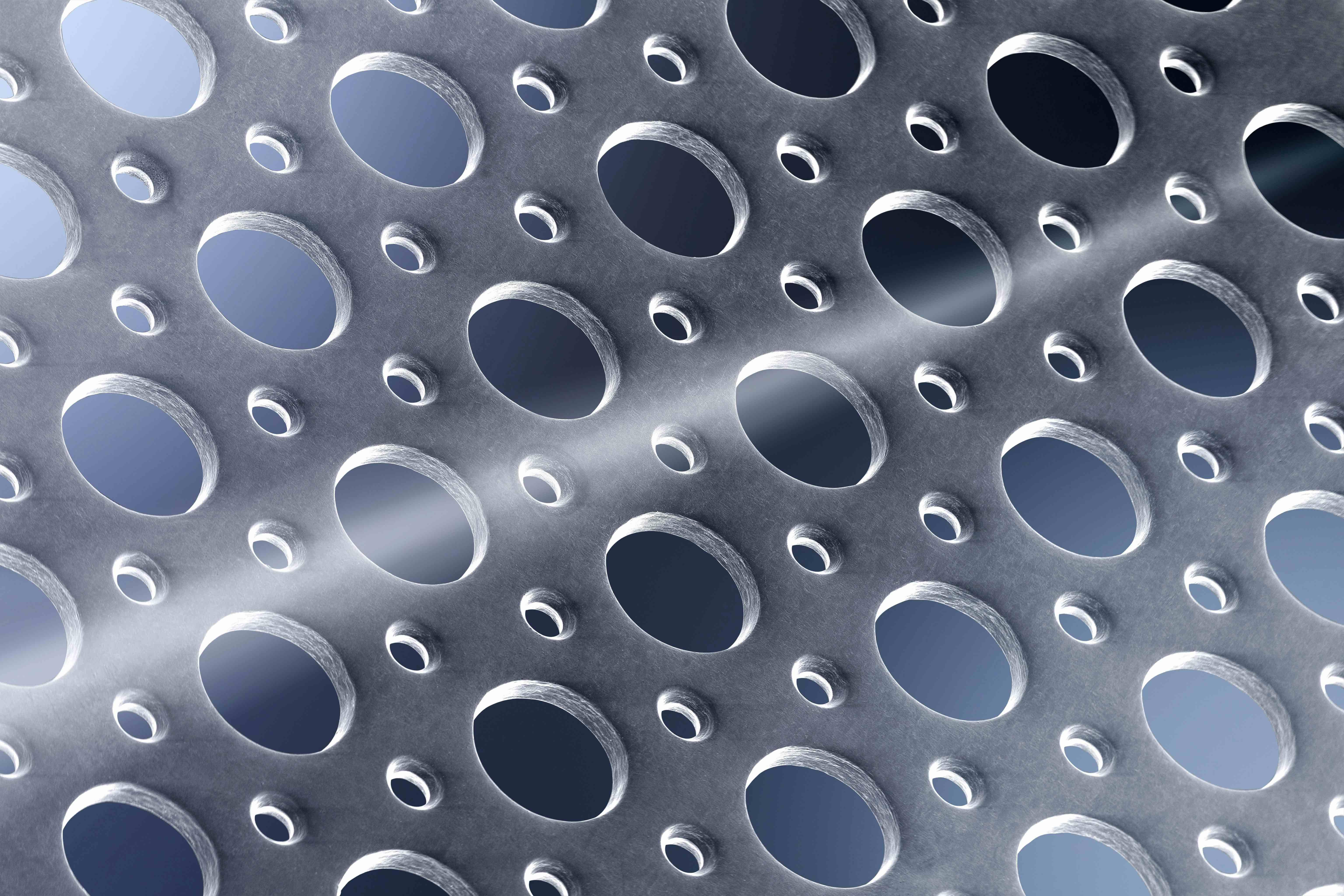

AL. micrometal’s unique variation of the PCE process involves the use of a very thin proprietary liquid photoresist (2-8 microns thick) and high-resolution glass photomask tools.  This combination provides extremely precise control of the etching process, enabling configurations, features, and tolerances that cannot be achieved by other methods such as stamping, laser machining, or traditional PCE. 3-dimensional features can be etched into the thickness of the material itself, and dimensional tolerances as low as +/-0.005mm can be achieved.
The company can achieve extremely small feature sizes of 25 microns, a minimum hole diameter of 80% of the material thickness, and single-digit micron tolerances repeatably. Traditional PCE uses relatively thick dry film resist which compromises ultimate part precision and the available tolerances, and it is only able to achieve the smallest feature size of 100 microns, and the smallest hole diameter is a factor of 1-2 when compared to material thickness.

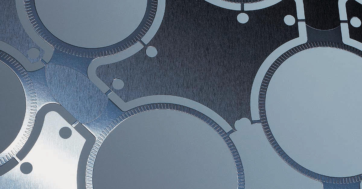

AL. Well, let’s look at something that is a part of the PCE process that no one without an intimate understanding of the technology such as micrometal would know. Inherent in the way that PCE works are that it creates an edge “cusp” during the process. An awareness of this and micrometal’s ability to control this means that we can produce a range of profiles that can be used to enhance product characteristics. Without close consultation with your PCE “partner” such possibilities would be lost, and sub-optimal products may be the result.
