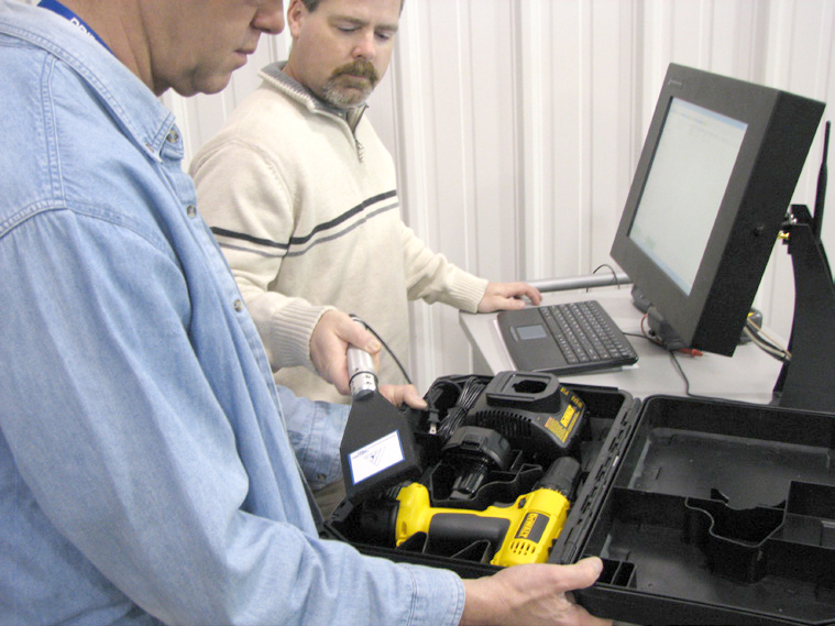

An automatic ID toolcrib solution in its simplest form is an employee swiping his or her ID card, which logs the worker's identity and then passing the items being checked out through a scan zone that reads the tag on the tool. This setup is similar to using a self-checkout at a retail store. Other options include using vending machines to dispense tools, keeping tools secure while freeing up labor hours since no one needs to man the toolcrib and also ensures an accurate record of which employees have checked out which tools.
