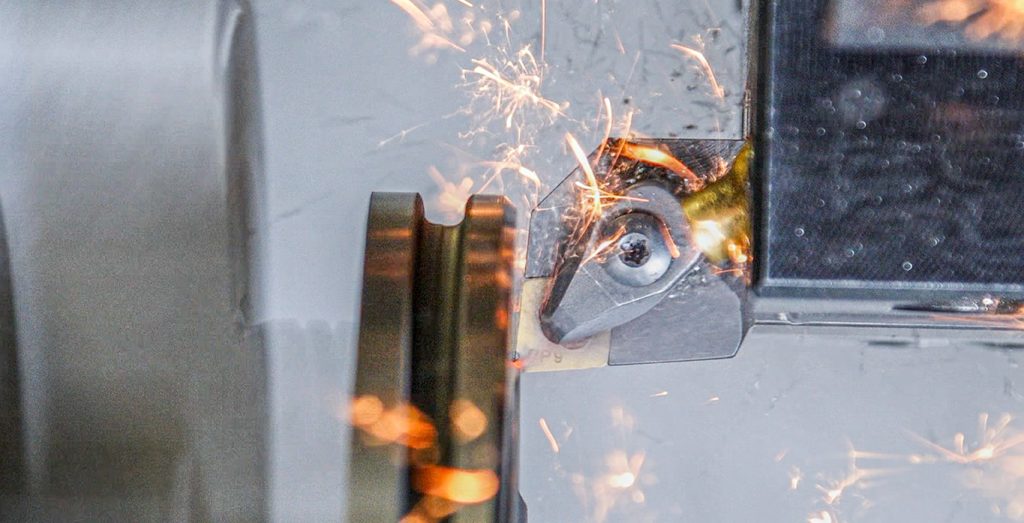

Engineering cast iron machining with strategic ceramic application image

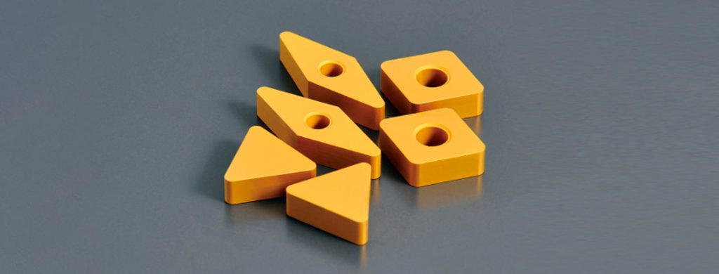

NTK’s SP9 coated silicon grade ceramic solution.
NTK ceramic solutions for cast iron
NTK’s ceramic portfolio has been developed specifically for cast iron machining:
• SP9 – Coated silicon nitride grade supporting roughing to finishing of gray and ductile cast iron
• SX6 – High-toughness silicon nitride ceramic for demanding gray cast iron roughing, including scaled surfaces
• HC1 / HW2 – Alumina-based ceramics optimized for high-speed finishing of gray cast iron
These grades are widely applied in automotive, heavy equipment, pump and valve, and general industrial casting production.
