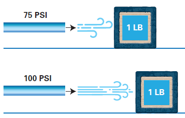

What is pressure?
Pressure, typically measured in pounds per square inch (psi), determines the system’s ability to perform a certain amount of work at any given point in time. Consider an application as simple as using compressed air to slide a wooden block across a table. In this case, using 75 psi of air might not deliver enough force to move the block but 100 psi will.
At a minimum, the compressor must provide the pressure (force) needed to perform the job (in this case, moving the block). If the minimum pressure required is 100 psi but the compressor is unable to provide this pressure, the job will not get done. However, too much pressure can damage equipment or cause it to operate erratically. Each pneumatically operated device has a stated pressure range in which it works reliably, and these specifications must be followed.

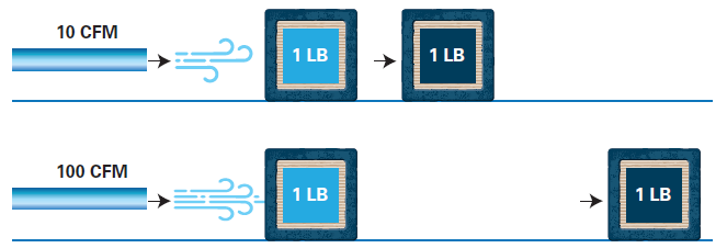

What is flow?
Flow is the ability for a compressor to continue performing the task. In the U.S., flow is typically measured in cubic feet per minute (cfm) at a specific pressure. The amount of flow depends on the length of time needed to complete the task.
Let’s look at flow using the example above:
If you only had to move the block a small distance every hour, you could use a small compressor with a compressed air storage tank. The compressor refills the tank until the next time you need to move the block. However, if your process requires the block to be constantly moving over a 24-hour period, you’ll need a larger compressor with more continuous flow.
Insufficient flow will require breaks during the process while the compressor builds up pressure in a reserve tank of air. If you begin noticing longer breaks or if your tank is not building up air pressure quickly enough, it may indicate that you have an air leak.
