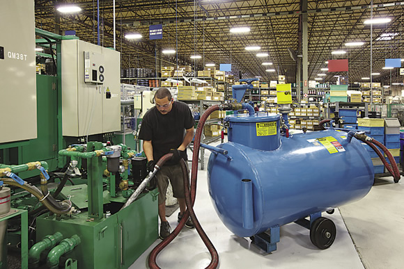

That’s good news for Ron Wendt, fluid recycling equipment manager for Eriez Manufacturing Co., Erie, Pa. “A lot of shops run their coolant until it’s bad,” he said. “Then they pump it out and have it hauled away. The big manufacturers have built-in evaporators in their plants, which is more cost-effective than recycling but represents a substantial investment. Either way, reducing coolant waste is difficult. And since most cutting fluids are at least 90 percent water, it can cost more to have it disposed of than to buy new concentrate.”
The solution, Wendt said, is managing the cutting fluid, extending its life and delaying the point at which recycling is needed. That’s where the company’s portable SumpDoc fluid recycling system comes in. “You can wheel it over to the machine and clean the sump without disrupting production,” he said. “It combines several important processes: filtration of chips and fines, removal of tramp oil and concentration control.”
This last point is something many shops get wrong, Wendt said. Without the correct cutting fluid concentration, tool life suffers and bacteria grows more readily, leading to a smelly sump. “You’ve got to clean the coolant before it’s a problem. It can’t be brought back from the dead. But with proactive treatment, you eliminate waste, extend machine and cutting tool life, and save on recycling costs and replacement of cutting fluids. It also minimizes your environmental liability.”

Air sump cleaners from Eriez have single-tank capacities from 50 to 1,000 gal. and twin-tank capacities from 50/50 to 500/500 gal. Image courtesy Eriez.

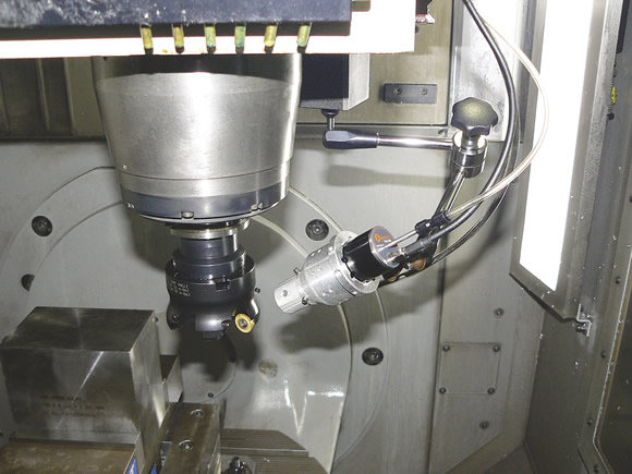

MQL keeps shops high and dry
Sometimes, the best way to avoid concerns about cutting fluid disposal is to avoid it in the first place. Dr. Radu Pavel, chief technology officer at TechSolve Inc., Cincinnati, said minimum-quantity lubrication (MQL) is an effective way to lubricate cutting operations, but without the cost, mess or environmental impact of conventional flood coolant. It works by introducing a small amount of pressurized cutting fluid—typically oil, but also water-based fluids—at a rate of 0.2 to 2.5 oz. (5.9 to 73.9 mL) per hour, just a fraction of flood coolant’s 8 to 20 gal. (30.3 to 75.7 L) per hour. One or more “channels,” or coolant lines, may be used, especially with large milling cutters and wide cut widths.
MQL lubricates a facemilling operation on a block of Ti6Al4V. Image courtesy TechSolve.
This isn’t a matter of starving the tool to save a few bucks. According to Pavel, titanium milling tests with MQL improved tool life four times compared to water-based flood coolant. Turning tests were not quite as impressive—about the same cutting results as flood—but that’s nothing to sneer at when one considers the cost savings. “When using MQL, the chips come out clean and dry,” he said. “There’s far less mist and evaporation than with traditional fluids, and there’s no need to recycle anything. A few gallons of lubricant might be sufficient for weeks.”
Some MQL systems use compressed CO2, nitrogen or shop air to drive and cool the lubricant. Pavel said a basic system might cost several thousand dollars or more, but that operating costs are significantly less than with flood coolant. “Conventional lubrication systems use electricity to drive the pumps, and there’s the cost of the cutting fluid itself, maintenance and recycling. By comparison, MQL’s efficiency depends on fluid selection, nozzle positioning and what gas is used, but it offers promising results in efficiency and higher part quality, at an energy consumption roughly 60 percent of traditional fluids.”
