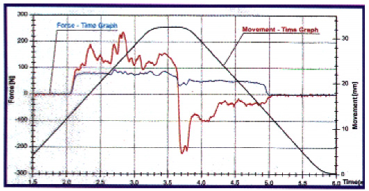

Fig 1: This graph plots the cutting forces generated in three trials by a tap with M10 threads cutting in synchronous mode. The sharp increase in negative forces in the middle of the graph was caused by the spindle reversal.In a comprehensive study sponsored by Emuge Corp., Northborough, MA, and conducted at the University in Kassel, Germany, researchers measured the extreme cutting forces that these synchronization errors generate during a rigid tapping cycle. Figure 1 is a plot of these measurements. As the graph shows, a sharp increase in negative forces occurred at the point that tap rotation was reversed (between 3.5 and 3.8 seconds). The forces remained high during the entire time the tap was backed out of the tapped hole.

The new tapholder’s ability to reduce cutting forces can be seen in Figure 3, which plots additional test runs by the researchers in Kassel, Germany. The red line on the graph shows the cutting forces generated as a 10mm tap – held in a rigid holder and mounted in a new
machine tool – tapped a hole in synchronized mode. This plot shows the same spike in forces at the moment of spindle reversal as the spike that appeared in Figure 1. After recording the forces with the tap in a rigid holder, the researchers placed the same tap in a tapholder with 0.5mm tension/compression. The researchers then mounted the tap and holder in the same machine tool and tapped another hole. The blue line on

Fig. 3: As can be seen in this comparison, a tap held in a helder with 0.5mm tension/compression (the blue line) generates fewer negative cutting forces than a tap held in a conventional tapholder(the red line).(Click for larger image)Figure 3 shows the forces generated during this run. As can be seen by comparing the blue line with the red line, the forces are much lower and steadier.

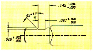

Fig. 5: These Emuge Full-Speed taps for high-speed tapping are mounted in Tapmatic E-lock tap adapters, which can hold the taps securely at speeds up to 4000 rpm.Quick-change tap adapters were widely used when high-production tapping was performed on transfer lines by multispindle machines. But these adapters have not been used with self-reversing tapping heads, because the adapters have been found to be unreliable at speeds above 1000 rpm. Instead, shops have had to use collets, nuts, and wrenches to secure their taps in self-reversing heads. With the recent introduction of the E-Lock quick-change system, which operates at speeds up to 4000 rpm, machinists now have the option of using a quick-change system with a self-reversing head (Figure 5).
The new adapters are interchangeable with other quick-change adapters. Special adapters that minimize the weight of the rotating spindle are available to fit self-reversing tapping attachments.
Speed Tapping
Fig. 4: A high speed, self-reversing tapping attachment, such as this unit offered by Tapmatic and Emuge, can eliminate time-consuming spindle reversals.The E-Lock system uses standard taps featuring a slight modification that can be performed in any shop (Figure 6). Modified taps also can be purchased off the shelf from some tap manufacturers. The E-Lock mechanism uses a spring-pin that locks securely into a ground notch on the square of the tap. This pin cannot be released unless the tap adapter is removed from the tapping attachment’s quick-change spindle. While the pin is engaged in the tapholder, it is almost impossible for the tap to pull out.
The E-Lock system is one example of how manufacturers have responded to end users’ needs with practical innovations. The technology that is now available–embodied in such products as E-Lock adapters, high-speed taps, tapholders with 0.5mm tension/compression, and self-reversing tapping attachments –gives users the tools they need to turn what was once one of the slowest operations on a production line into one of the fastest.
