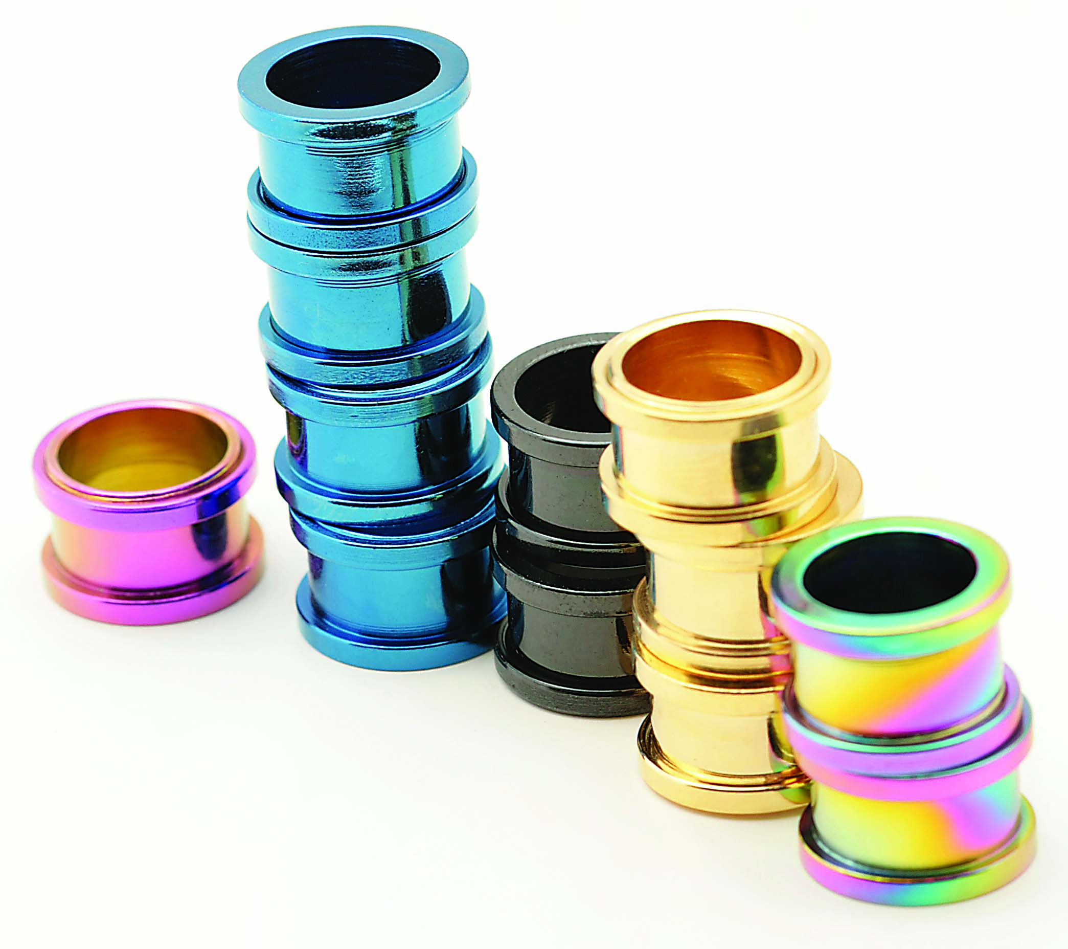

To permit the use of aluminum instead of other, heavier metals in industrial applications, many cylinders are anodized to create an extremely hard surface that resists wear and corrosion, is nonconductive and is lubricious. Because anodized surfaces are porous, they also improve adhesion of coatings, as well as accept a variety of dyes for coloring. Given the myriad benefits, anodizing is popular for a variety of cylindrical items, including lift mechanisms for chairs; lift cylinders for hatchbacks; shock absorbers and forks for bicycles; fuel pumps; water pumps; pneumatic and hydraulic cylinders; spool valves; valve stems; and valve bodies.
By definition, however, the anodizing process means that part dimensions grow dimensionally and the surface finish becomes rougher. For a cylinder, that includes both an increase to the OD and a decrease to the ID. There are several types or classes of anodizing methods, and each reflects a range of coating thicknesses. As a rule, thicker coatings provide greater corrosion protection. Therefore, surfaces last longer in harsh environments, such as salt air.
As for surface finish, a hard coat anodized to 0.002″ thickness generally results in an Ra two to three times the original bare metal finish. For example, a machined Ra of 16 easily can become 30 Ra or more after anodizing.

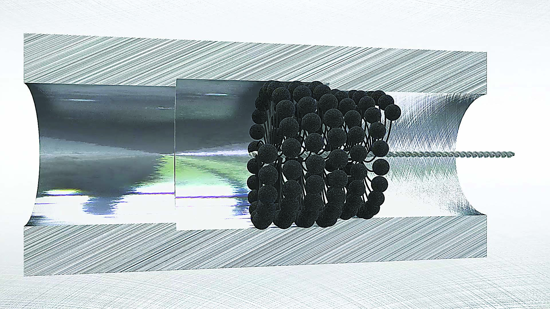

Rigid honing has other issues. Because anodized coatings are thin, just a very small amount of material should be removed. Yet rigid honing works best with heavier cuts and greater material removal. Fine cuts combined with tool loading can contribute to smeared surfaces.
The Flex-Hone Tool from Brush Research Manufacturing Co. Inc., Los Angeles, provides a better way to improve the surface finish of anodized and hard-coated cylinders. The Flex-Hone consists of abrasive globules permanently laminated onto the ends of flexible nylon filaments. Because the diameter of the tool is greater than the diameter of the bore, the Flex-Hone is used in an oversized condition and self-centers, self-aligns and self-compensates for wear.
Importantly, the tool’s globules float to ensure that all parts of the bore—not just the high spots—are surface-finished. Unlike rigid honing machines, Flex-Hone setups are simple. Surface finishes can be improved with just a few strokes of the tool, and results are consistent.

The tool may be used prior to anodizing to control the size in anticipation of shrinkage in ID. Honing also removes fuzz, sharp edges and any amorphous material that might adhere to the surface and affect the quality of the anodizing.
The most common use for the tool is after anodizing, when correcting unanticipated size and surface finish issues. When quality of the final anodized finish is of utmost importance, some users apply the tool before and after.
With anodized coatings, the recommended abrasive types are 400-, 600- or 800-grit Al2O3 and extra-fine levigated alumina. Choice of grit depends on the type and thickness of the anodized coating and the final surface finish specification. Flexible honing tools are available in sizes from 4mm to 36″.
