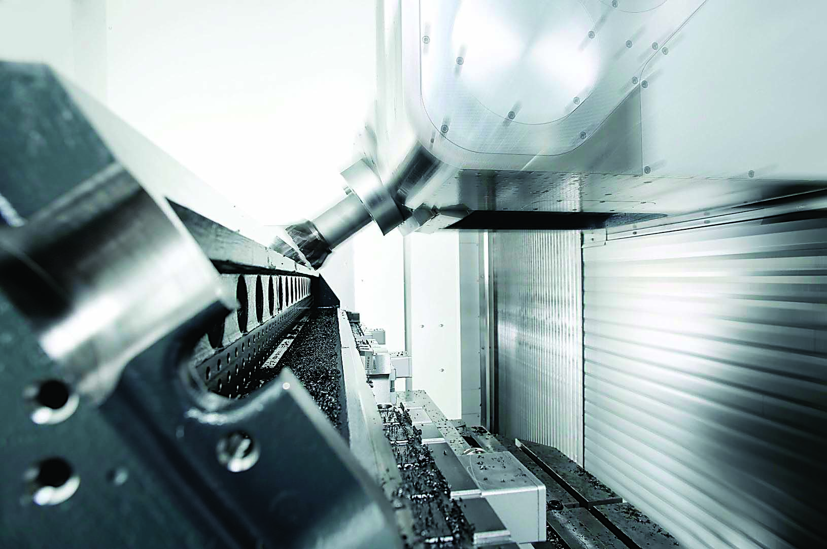

Next, we considered the dimensional tolerances of our parts. Five-axis machining makes it easy to hold close dimensional tolerances on multiple faces. Traditional machining methodology requires multiple workholding devices to access all faces. Having a setup with multiple coordinate systems, multiple workholding devices and numerous setups makes troubleshooting dimensional errors difficult.
Shop considers investing in 5-axis machining
Five-axis machining makes it easy to hold close dimensional tolerances on multiple faces. Image courtesy of Heller Machine Tools.
Besides reducing the number of workholders needed, 5-axis machining allows access to multiple sides without moving the part. Therefore, errors introduced from fixtures, multiple machining origins and other setting errors are eliminated. Troubleshooting problems with true position and other geometric errors is much easier when using only one workholder and one coordinate system.

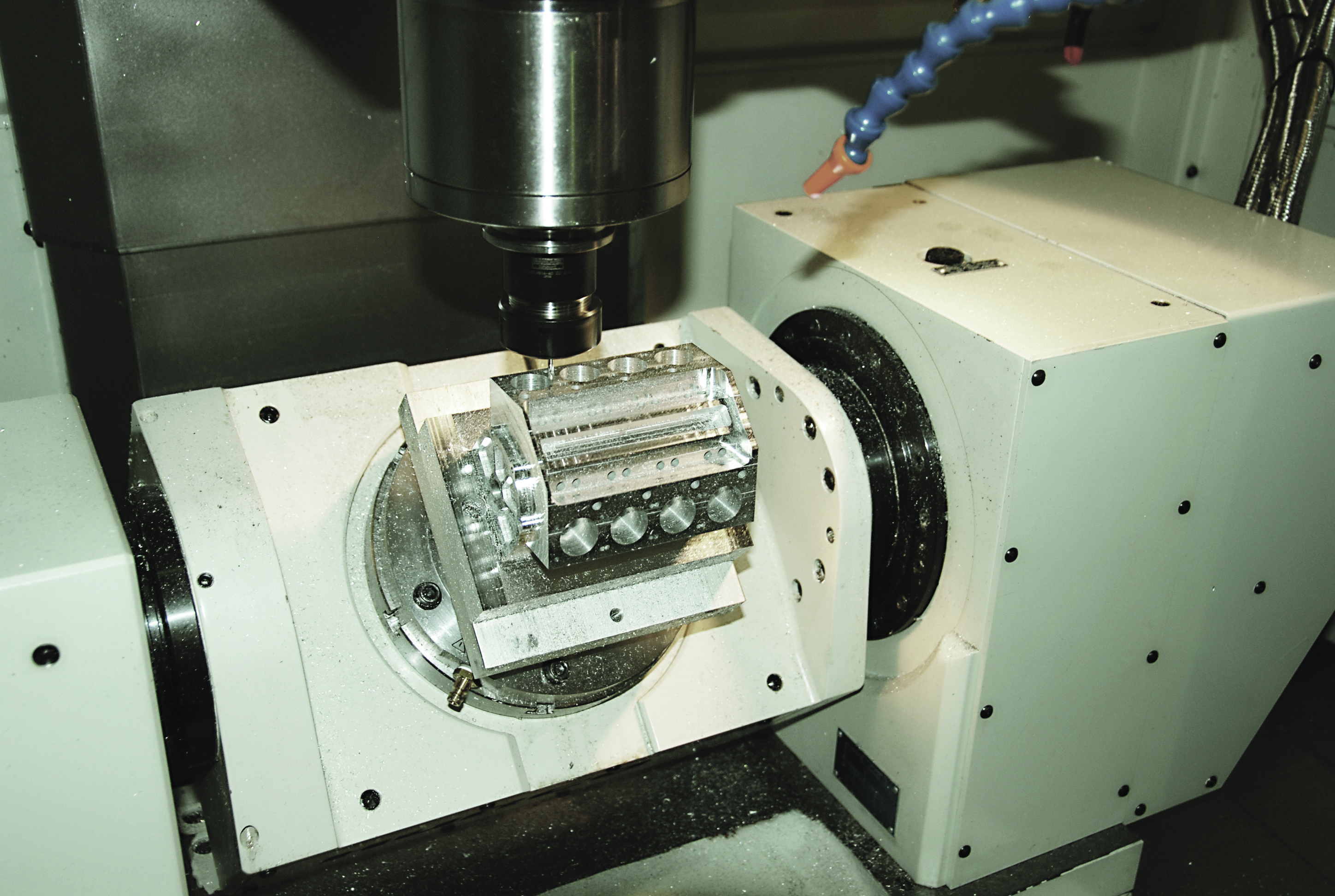

Finally, we had to consider the style of machine we would buy. Five-axis machines come in distinctive styles. Some have a spindle mounted in an articulating head. Others have a trunnion with a rotating table that tilts in the X-Y plane. The simplest, most economical versions put a 2-axis rotary unit on a 3-axis machine’s table. All styles have unique advantages.
Trunnion-style machines were best for our parts. This style minimizes interference among cutting tools, workholders and the machine, allowing for short, rigid tools and compact setups.
Machines with articulating heads were too large for our parts and more expensive. We considered purchasing a 3-axis machine and installing a 2-axis rotary unit, but we were concerned that integrating two components that were not designed as a system would cause reliability issues. (I learned later, through experience, that a 3-axis machine with a 2-axis rotary unit can work very well.)
