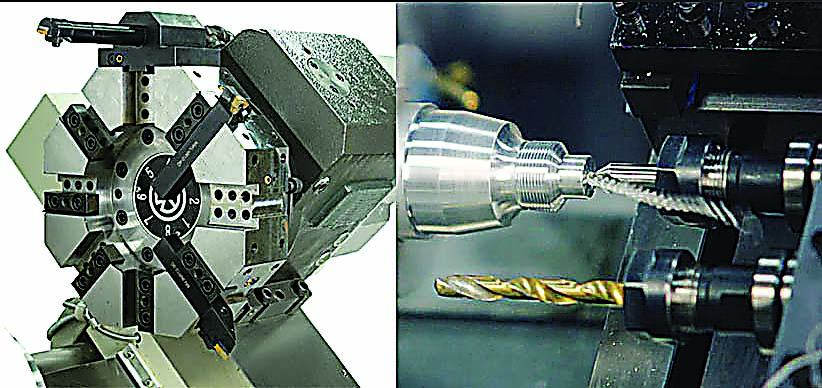

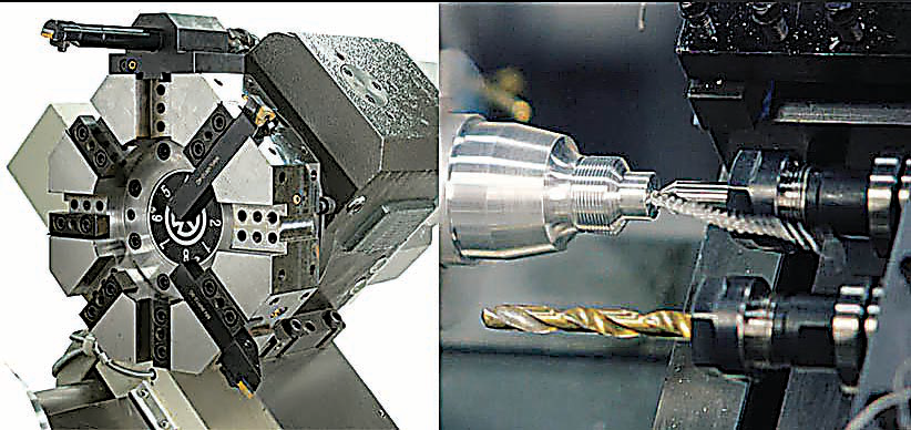

- Gang tooling is very hard to beat for small-diameter, short parts that do not need a tailstock.
- Turrets are more versatile. They are a must for long, skinny parts that need a tailstock for support.
Many machinists wish they could use their gang lathes for everything, but they have turret machines for parts that are too long and thin to be made with a gang lathe.
A CNC lathe with a turret (left) and gang tooling (right). Image courtesy of B. Warfield
For those kinds of parts, perhaps a better “competition” would be gang lathes vs. Swiss-style machines. Another possibility is to install small gang plates in some of the turret stations. This adjustment can make tool changes very fast for the tools on that station.
Turrets are also the norm on larger CNC lathes and multifunction machines. Turrets are preferred for large work because they don’t require clearance under the part. The turret can approach the part from behind, which allows more room for large-diameter parts.
Multifunction machines use multiple turrets and spindles to greatly enhance the speed and flexibility of the machine. The goal is to perform all operations in a single setup. With two spindles, the part can be transferred to a second spindle to allow machining of the back side. With multiple turrets, more tools can be accommodated, parts on two spindles can be machined simultaneously (one turret per spindle), and it’s even possible to increase the mrr by roughing an OD with two tools in one pass.
At the high end, the flexibility of turrets makes them the winner. At the lower end, the simplicity and speed of gang tooling makes them the winner.
