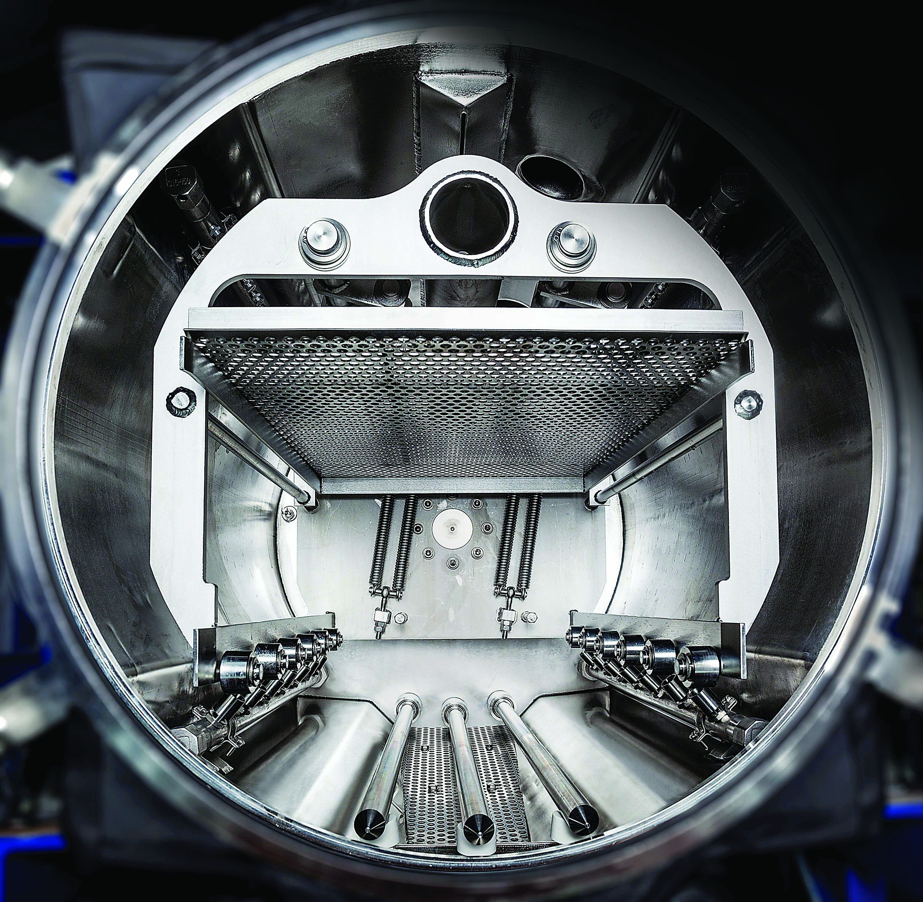

An electropolished chamber with integral wall flushing helps avoid recontamination. Photo credit: Hoeckh Metal Cleaning Systems GmbH
For fine-cleaning applications, features such as an electropolished chamber with integral wall flushing help avoid recontamination of the cleaned components by preventing the backflow of dirt or the formation of dirt traps inside the chamber. Image courtesy of Hoeckh Metal Cleaning Systems GmbH

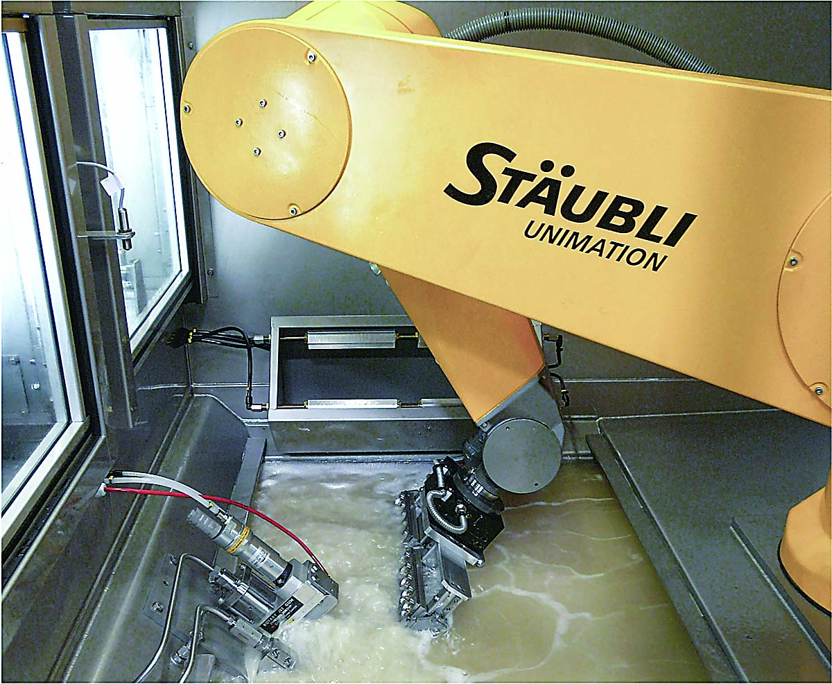

Robots enable various processes, such as deburring, spray cleaning and dip cleaning, as well as drying. Photo credit: Stäubli International AG
For cleaning individual parts, robots designed and specially sealed for use in cleaning machines enable various processes, such as deburring, spray cleaning and dip cleaning, as well as drying. Image courtesy of Stäubli International AG
