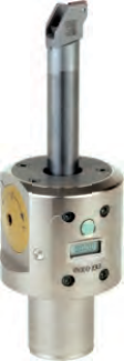

Digital readout of diameter adjustment reduces operator errors when using boring heads with a traditional dial and vernier scale.
Many toolmakers also offer digital readout capabilities. “You still have the adjustment piece, but on the other side you have a place to plug in a digital readout,” said Duane Drape, national sales manager for HORN USA Inc., Franklin, Tenn., which offers the URMA fine boring head. “The digital readout is much easier for the operator to read and understand how much they are adjusting the bore diameter.”

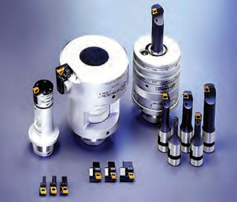

Sandvik Coromant’s CoroBore 825 finishing boring system can be adjusted for a range of diameters. Its coupling design integrates an elliptical interface to absorb cutting forces.

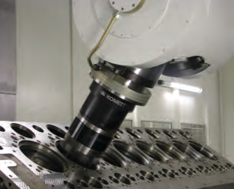

KOMET_Komtronic.tif
Courtesy of Komet

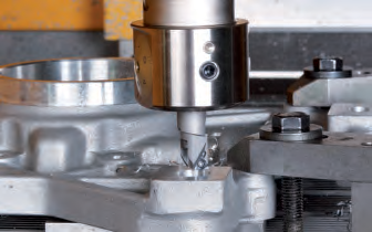

The Komtronic finish boring system boring an engine block.

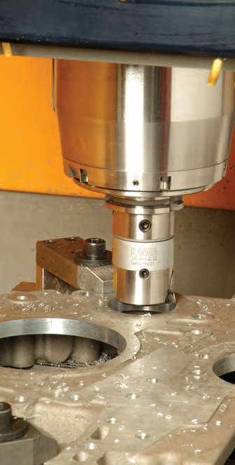

Other digital offerings include BIG Kaiser’s EWN 2-54D digital fine boring head, for the hole diameter range of 0.078 ” to 2.125 “, which supports spindle speeds up to 20,000 rpm. The boring head features an integrated LCD display with one-button operation.
To provide a display wirelessly, Komet’s MicroKom BluFlex fine adjustment system is equipped with Bluetooth technology. The display is separated from the head making it more convenient to read the data. The user can attach the external display unit anywhere near the machine.

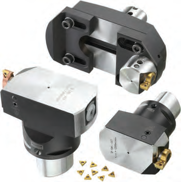

Sandvik Coromant’s CoroBore XL boring system has a counterweight on one side and is for finishing large-diameter holes.
“The worst, though, are the shoestrings, or long strings, which tend to wrap themselves around the tool,” Burley said. “They indicate you need to adjust something—your chipbreaker, stock allowance, feed rate, coolant application.” He added that those chips tend to mar a hole’s surface finish.
