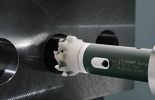

The Dihart Reamax TS carbide-tipped reamer is available from KOMET of America.
Effectively reaming nickel-base alloys requires a slow and steady approach.

Because these extreme-environment parts often require high-quality holes—with an H7 international size tolerance grade or better—part manufacturers commonly employ reaming to meet surface finish, size and concentricity requirements. For example, an H7 tolerance for an 18mm-dia. hole is 0 “/+0.0007 “.
“As the hole gets bigger, the tolerance range gets larger,” said Jacob Miller, product manager for Allied Machine & Engineering Corp., Dover, Ohio. The cutting tool manufacturer recently added replaceable-head reamers from S.C.A.M.I. to complement Allied’s monoblock and ring-style reamer offerings from the same Italian manufacturer.
Although high-performance drills can produce high-quality holes, reaming is required for a tighter diameter tolerance. Indexable-insert drills typically achieve a tolerance as tight as 0.008 ” and solid-carbide drills achieve a 0.002 ” tolerance, von Rohr noted, but solid-carbide, carbide-tipped and indexable-inserts reamers attain a tolerance of 0.0004 “. KOMET makes solid-carbide, carbide-tipped and indexable-insert reamers.
