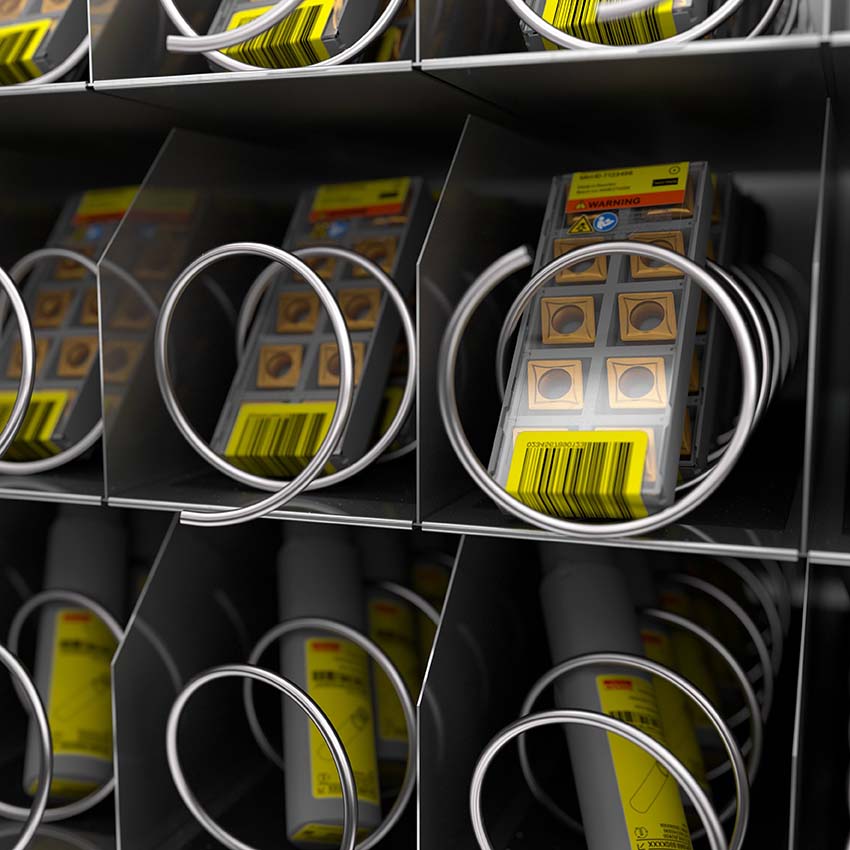

Cost per edge is important, but it’s not the end game. Choosing the right turning tool for the job is. Yet many metalworking professionals are concerned about out-of-control toolcribs, where the number of insert brands and grades seems to grow with each passing year, with some of those inserts probably dating back to the shop’s first CNC machine. Adding to inventory bloat are enthusiastic sales people who stop by with the latest tool body and pack of inserts and add another handful of part numbers for the crib to manage.
6 tips for improving turning operations
An effective tooling strategy requires working closely with suppliers
in a controlled manner, bringing in new technology to address specific challenges.
Granted, these ad-hoc solutions often bring improvement to tool life or productivity, but an effective tooling strategy requires working closely with suppliers in a controlled manner, bringing in new technology to address specific challenges.

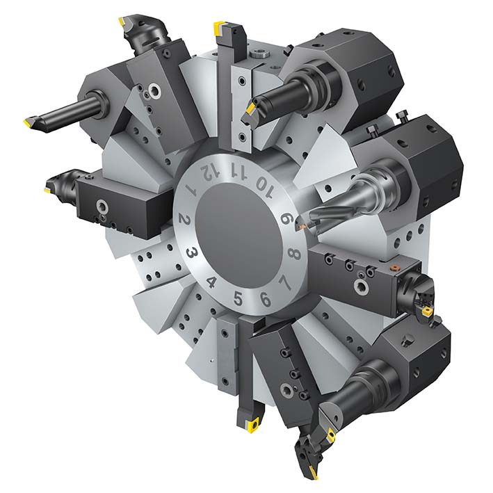

If possible, change all the tools in the turret
at the same time, at regularly defined intervals.
ne often overlooked bit of fine-tuning is to change all the tools in the turret at the same time, at regularly defined intervals. This minimizes the amount of door opening and, properly implemented, provides predictable lengths of time where an operator can leave a machine unattended to do other work. Of course, this requires careful planning and documentation of anticipated tool life and the cutting parameters that have been tried so far.
Some tools are in the cut much longer than others, and no amount of feed or speed tweaking will get them to wear out at the same time. They can, however, be scheduled for coordinated changeover.
If, for example, the rougher looks ready to fail at 18 minutes, the finisher at 67 and the grooving tool at 39, then:
A) change the roughing tool at 15 minutes;
B) replace the rougher and groover at 30 minutes;
C) change the rougher again at 45 minutes; and
D) swap all three tools at the 1-hour mark.
