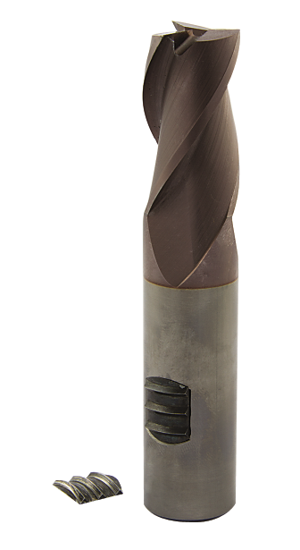

In the winter of 1918, Carl A. Bergstrom opened the Weldon Tool Co. in Cleveland. Working from his shop atop the Blackstone Building, he developed a new kind of endmill, one with a 30° helical flute. The thing cut like crazy. Yet Bergstrom quickly realized that his toolholder lacked the gripping power to hang onto his cutting-edge endmill, as the darned thing kept spinning right out of the holder. In a fury, he grabbed that newfangled tool and ground a flat spot on its side, giving the toolholder’s clamping screw a place to bite into. Bergstrom had invented the Weldon shank.
The old toolmaker has long since turned to dust, but his invention lives on. For decades, the Weldon shank has taken first place in the contest for raw gripping force. Until now, that is. Brendt Holden, president of tooling provider Haimer USA LLC, Villa Park, Ill., aims to retire Bergstrom’s brainchild to a well-deserved place in the milling hall of fame with the development of Safe-Lock, a system that utilizes a no-fail clamping technique.
“Weldon-style endmill holders by their very nature push the cutter off center,” Holden said. This creates runout and drastically reduces tool life. Worse, even the rugged Weldon flat is prone to failure under modern cutting conditions—people weren’t hogging huge blocks of titanium in Bergstrom’s day or machining aluminum at 600 ipm and 20,000 rpm.

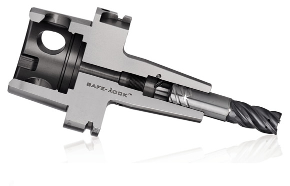

Cutaway view of Haimer’s Safe-Lock clamping system.
Since Haimer was already producing shrink-fit toolholders, it started by modifying one of its standard shrink-fit chucks, adding a pair of angular rods immediately behind the clamping area. These rods engage a pair of precision-ground helical grooves on the endmill shank to securely hold the tool during high-feed milling. Because the helical locating grooves on a Safe-Lock endmill run in the same direction as the cutter’s helix angle, rotational forces can only drive the endmill into the holder, not force it out.
To satisfy the requirement for Z-axis length adjustment, Haimer designed the system to allow about 12mm of length adjustment, and then placed an adjusting screw in the bottom of the holder. This butts up against the endmill, preventing axial movement. The Safe-Lock system was born.
“We brought it to back to that aerospace company and it solved their problem,” Holden said. “Runout was less than 0.0001 ” at a distance 3 times diameter from the chuck face. Tool life increased five to seven times compared to Weldon shank holders. They were very happy.”

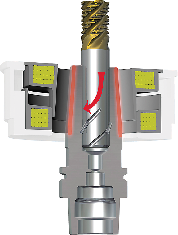

West agreed the Safe-Lock system solves the laundry list of problems cited by Holden, but went one step further. Because Safe-Lock tends to send cutting forces toward the spindle, rigidity is improved compared to conventional toolholders. “Anytime you have a high radial load,” West said, “you’re pushing perpendicular to the spindle. It’s hard on the spindle bearings and can lead to wear and tear on the machine. Because tools in a Safe-Lock holder push straight upward in the Z-axis, the machine should be able to better absorb that energy into the spindle.”
B02_Haimer_Safe-LockT_Grafik.tif
Courtesy of Haimer USA
Cutting forces are directed into the Safe-Lock chuck.

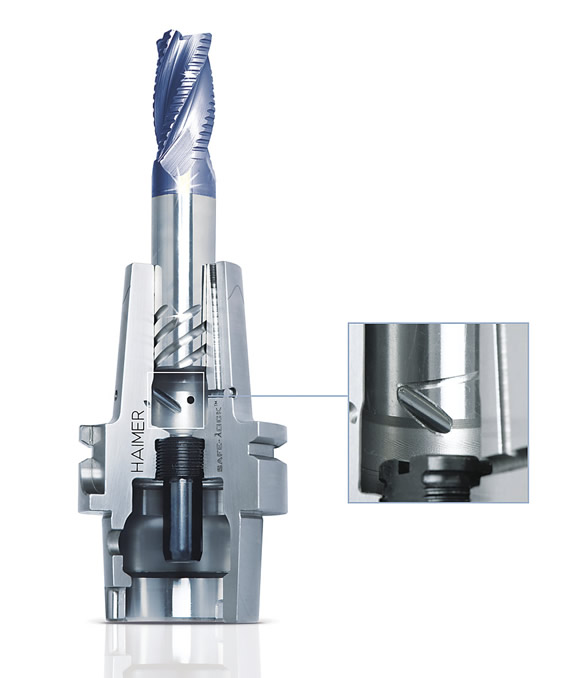

Cutaway view of a Kennametal shrink-fit HSK Safe-Lock toolholder.
Critics of shrink-fit technology point to the potential for metal fatigue. After all, repeated heating and cooling can turn even the toughest of metals into Silly Putty. To silence these naysayers, Haimer tested the typical shrink/heat thermal cycle more than 2,000 times against four sizes of toolholders, quickly bringing them up to 426° C, then chilling them down again to room temperature in less than 2 minutes. The results showed no loss of accuracy, gripping torque or metallurgical properties.

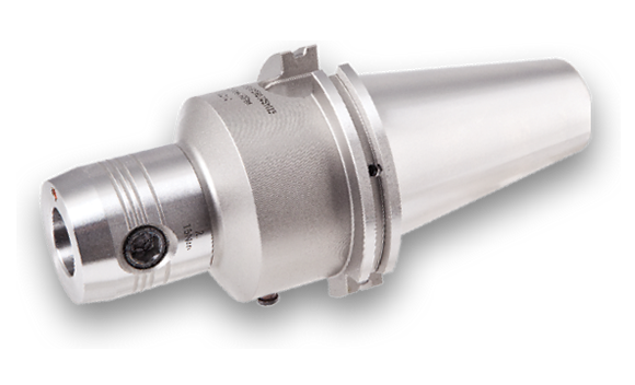

Iscar Metals Inc. offers an alternative to shrink-fit and Safe-Lock holders. Its HYDRO-SURE hydraulic holder has 0.003mm concentricity and 360° clamping with a patent-pending locking system, according to Iscar. “It provides the security of a Weldon shank and the accuracy of a hydraulic holder, but without the high investment costs of shrink fit,” said Tom Edler, national product manager for Arlington, Texas-based Iscar. “The only additional equipment needed to tighten a HYDRO-SURE is an Allen wrench.”
Despite this advantage, he admitted to one shortcoming shared by most hydraulic holders. “The accuracy of the two systems is comparable, but shrink-fit holders do have nearly twice the gripping force,” Edler said. “For example, a 0.750 “-dia. shrink-fit holder exerts roughly 370 in./lbs. of torque, whereas the same size hydraulic holder has only 200 in./lbs. or so.”

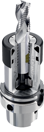

REGO-FIX_secuRgrip_CMYK.tif
Courtesy of Rego-Fix Tool
Cutaway view of Rego-Fix’s antipullout secuRgrip toolholder. Note the threaded nose, which keeps the press-fit collet in place during heavy-duty milling.

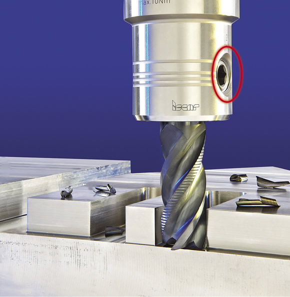

According to Iscar, its new system gets around this problem by incorporating a Weldon-style side-lock screw into the toolholder. “[Lower clamping force] is a moot point, as there is no way for it to rotate or pull out,” Edler said.
Like the systems discussed previously, an accurate tool shank is critical to gripping force. Edler also recommends H6 or better. And despite Iscar’s different approach to toolholding, Edler has no arguments about the affect of runout on tool life. “We prepared a case study, which established a baseline of 0.0004 ” runout equal to 100 percent tool life. We found that increasing runout by just 0.0002 ” cuts tool life by nearly 20 percent, while reducing runout by the same amount improves tool life by 30 percent.”
Edler said this is one area where most shops can see dramatic improvement with a reasonable investment: The cost of Iscar’s antipullout toolholder is around 15 percent more than its standard hydraulic one. “For a few bucks more,” he said, “I could literally come in, change the holder and provide better tool life and worry-free performance, regardless of whose cutter you’re using.”
Another company looking to keep the Weldon flat alive and kicking is Rego-Fix Tool Corp., Indianapolis. As Vice President of Sales Bill Obras explained, Rego-Fix leverages the Weldon flat as a way to guarantee zero pullout and high accuracy and does so with a mechanical clamping method.
“We began development of our system in 2002,” he said. “We observed problems with hydraulics in that you have a fluid chamber that can flex within the toolholder. And shrink-fit has issues with longevity due to heating and cooling, especially at diameters of ¼ ” and below. We wanted to have a solid toolholder, one with the clamping force of a Weldon toolholder but without the associated runout.”
The result was the powRgrip, a press-fit system that uses a 100:1 taper and a matching collet. The tool is mounted in a collet, and, using a tabletop press that exerts more than 9 tons of force, the collet is pressed into the holder. Rego-Fix claims runout better than 0.0001 ” at 3 times diameter with a service life in excess of 20,000 cycles at all diameters.
In spite of the powRgrip’s success, Rego-Fix observed that in some extreme cases pullout might occur. This is no different from any system without a positive lock. And, in today’s world of high-value aerospace and medical components, customers are unwilling to take the chance of scrapping an expensive workpiece.
Obras said: “Even with the tremendous clamping force generated by many systems, there’s a limit in very aggressive machining applications. The vibration and extreme radial load work to loosen the tool no matter how hard you clamp it. You have to have some sort of positive lock on that tool shank.”
The solution was to take that old Weldon flat and make it new again. Rego-Fix developed the secuRgrip toolholder, an antipullout version of its proven hydraulic system. The secuRgrip has several components, the first one being a standard hydraulic collet modified with an internal thread running the length of the bore. The second is a threaded insert that fits into a Weldon flat (see photos on page 56 and 57). Drop the insert into place, screw the endmill with its two pieces together into the collet, and then press the collet/endmill assembly into the tool holder like any powRgrip system. Lastly, a threaded cap screws over the top of the collet, locking it all together.
“We worked for a number of years on the secuRgrip system,” Obras said. “There’s no way for the tool to pull out of the collet, and the collet can’t pull out of the holder. The only failure mechanism is if the endmill breaks.”
