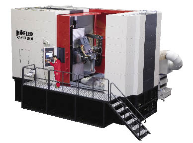

VanGear’s Höfler Rapid 2600 CNC gear grinding machine can achieve the American Gear Manufacturers Association’s highest achievable quality level, AGMA 15.

To make the gears, VanGear uses a 1.6m CNC hobbing machine and 1.6m and 2.6m gear grinding machines, all from Höfler GmbH. Mantei explained that the gear-making process begins with a gear blank, primarily a forged carburizing steel one for the wind energy industry. VanGear then cuts the gear’s teeth, typically with the hobbing machine. “What’s been most beneficial with the Höfler CNC hobber is we’re able to utilize a 15 "-dia. carbide gashing cutter,” he said, adding that it enables cutting teeth up to 10 times faster than the previous equipment.
Once the teeth are cut, a gear generally requires heat treating, which is performed by sister company Vancouver Heat Treat Ltd., Surrey, B.C. Because heat treating distorts a part, VanGear must do finish machining. “We grind the teeth to achieve the high accuracy levels required for the wind energy industry,” Mantei said, adding that, in some cases, the tolerances are tighter for wind energy parts than aerospace ones.
According to Mantei, VanGear’s grinding machines can achieve the American Gear Manufacturers Association’s highest achievable quality level, AGMA 15, whereas achieving a level higher than 12 was difficult with older equipment. “They’re form grinding machines and for them to achieve 15 is quite remarkable,” he said. “And how easily they did it surprised us. In the old days, it took a lot of hands-on, laborious work to achieve a 12.”
Although hobbing isn’t as precise as grinding and therefore hobbing machines generally don’t have onboard inspection equipment, which is common for grinders, Mantei noted that VanGear’s hobbing machine was customized with one to suit a customer’s inspection requirement. “It was the first hobbing machine in the world to have it,” he said.

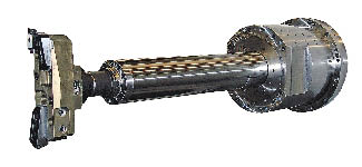

Because they’re usually large, machined components for wind turbines often require extended-reach tools to access a workpiece’s deep-lying sections. Typically, that involves applying long specials. “The disadvantage of that is the tools are heavy and very expensive,” said Torsten Leistner, area sales manager for StarragHeckert Inc., Hebron, Ky. “You cannot buy them from a standard catalog.”
Courtesy of StarragHeckert
The StarragHeckert HEC 1800 Athletic machining center can produce complex workpieces with edge lengths up to 3,300mm and weighing up to 13,000 kg and has an NC quill (inset) with stepless adjustment up to 750mm for long travels and the machining of deep-lying form elements.
The machine tool builder’s solution for avoiding those long cutting tools is the NC quill spindle, which features a bar that slides in and out as needed. “With the NC quill, you can use standard tools,” Leistner added.
StarragHeckert offers the NC quill on a couple machines with the appropriate size to handle wind turbine parts: the HEC 1600 Athletic and the newer HEC 1800 Athletic. The HEC 1600 can machine workpieces with edge lengths up to 3,000mm, and the HEC 1800 can machine workpieces with edge lengths up to 3,300mm. Both machines can handle parts weighing up to 13,000 kg.

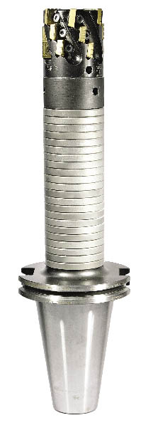

Stiff Tool
To overcome deflection issues when applying long-reach tools for machining wind turbine and other big parts, Valenite LLC developed the Stiff Tool carbide washer system. “The tool provides twice the accuracy due to half the deflection and twice the feed rate prior to the onset of chatter,” said Brian Hoefler, the Madison Heights, Mich., toolmaker’s manager of product development.
That’s achieved by assembling a toolholder with carbide washers. Valenite uses submicron-grade carbide with high cobalt content for the washers, similar to the substrate of the company’s carbide inserts. “We want the tool to be strong and not break,” Hoefler said, “and we’ve never had these washers break.”
Courtesy of Valenite

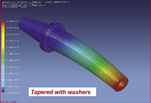

A finite element analysis image show the stiffness of Valenite’s Stiff Tool carbide washer system.
Unlike a solid-carbide tool, Hoefler noted that the Stiff Tool doesn’t have the inherent problem of the carbide stretching—which carbide doesn’t like to do. “When tools bend in use, and all do, including solid-carbide ones, one side stretches and the other side compresses, and the stretched side always gives rise to failure,” he said. “If the Stiff Tool deflects enough, the rings will gap so they don’t ever stretch.”
To quantify the Stiff Tool’s gains, Valenite conducted a finite element analysis using Unigraphics Scenario FEA software for CAT 50 BIG Plus taper toolholders having a 12 " overall length. The tangential cutting force was 790 lbs. and torque was 82 ft.-lbs. The straight-solid version had a maximum deflection of 0.0156 ", the straight-washer version deflected 0.0088 ", the taper-solid version deflected 0.0071 ", the 50 percent taper-solid version deflected 0.0102 " and the taper-washer version deflected 0.0038 ".
As a result, Valenite stated: “For straight-shank adapter versions, the carbide washer system generated a 77 percent gain in stiffness. On the taper version, the carbide washer system generated an 87 percent gain in stiffness. The gain is not quite double on the average but very significant. The carbide washer system has been lab-verified to operate at double the DOC prior to the onset of chatter due to the carbide material’s properties of increased stiffness and dampening.”
In addition, an end user can exchange some of the carbide washers with rings made of other materials to adjust the toolholder’s stiffness and modally tune it to the dominant natural frequency of the machining system. “The advantage is we don’t have to change the projection length of the tool to get exactly matched natural frequencies, which is the optimal chatter-resistant pocket of application,” Hoefler said.
That might involve replacing some carbide washers with washers made of H-13 tool steel, brass, copper or other material to reduce stiffness. The carbide washers are removed from the front of the toolholder to maintain stiffness close to the spindle. According to Hoefler, using all carbide washers doubles the stiffness compared to a solid-steel version with similar dimensions, but sometimes twice as stiff is not the correct stiffness. “You might want 1.9 times the stiffness to maximize the window of the dominant natural frequency that’s right for the speed that you’re most efficient to machine at,” he said.
That level of stiffness is determined by measuring the toolholder’s natural frequency and predicting through computer simulation the areas of stability. “Then you know how far you need to shift the frequency to get that pocket where the greatest range of width and depth of cuts exists for your rpm,” Hoefler said.
Aligning the tooling’s and machining system’s natural frequencies not only enables running at higher machining parameters, but it eliminates time-consuming spring-back passes where toolpaths are retraced to ensure the proper workpiece dimensions when tool deflection occurs. “You’re getting more of the shape you intended from your program,” Hoefler added.
