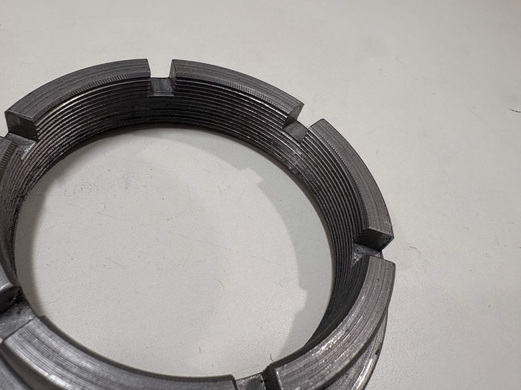

Custom castle-style lock nut for a Formula SAE wheel hub
The custom lock nut was threaded to fit the Formula SAE wheel-hub assembly. Credit: Robert M. Layng
The lock nuts were of a castle-nut design dreamt up by another student on the same team as the hub’s designer and has only suffered a very few revisions over the years — a tribute to the success of the design. (See figures 1, 2 and 3 for an overview of the castle nuts.)
The students ordered me a generous length of 2.500″ nominal inside diameter (ID) drawn over mandrel (DOM) steel pipe sporting a 0.500″ wall thickness. This would give me plenty of material to cut away and guarantee that I was still able to finish a completed part. After turning the OD features, I then bored out the inside of the rings for the female thread. As a reminder, the formula I’ve used to great success is as follows: OD – 1″/N = Minor Diameter, where N is the number of threads per inch. For my parts, there are 20 threads per inch, so 1″/20 = 0.050″ and our thread OD is 2.875″. For the ID, I bored the parts to 2.825″ before setting my threading tool to cut the screw threads.

Our CNC lathe has a very user-friendly tool wear compensation menu (see figures 4, 5 and 6). When doing the initial tooling setups, there was an option to “lie to” the machine and tell it that your cutter is slightly offset from where it really is. Regarding my threading operation, I told the machine that the tip of the tool was 0.007″ set back from the part’s ID. The control did the math and triangulation of the 29.5° lead angle in the background so I could simply tell the machine to dial in on the X axis alone.
The machine compensates on the fly, making programming and operation a breeze. All of this translates into being able to cut the female thread smaller than the desired finish size, and then advance the tool in by 0.0005″ increments in the offsets menu until I could get the wheel hubs (in this case, my plug gauge) to just barely thread in freely. The steel of the nut will wear the aluminum threads of the hub to settle into a perfect custom fit. I repeated this process five more times, making a spare matched set for a complete front hub assembly and a complete rear assembly.
After parting the rings off from stock, facing them to length, and back boring a relief, the parts were sent to our CNC mill to have the spanner slots cut into them. (See figure 7 for a fitted assembly.)
