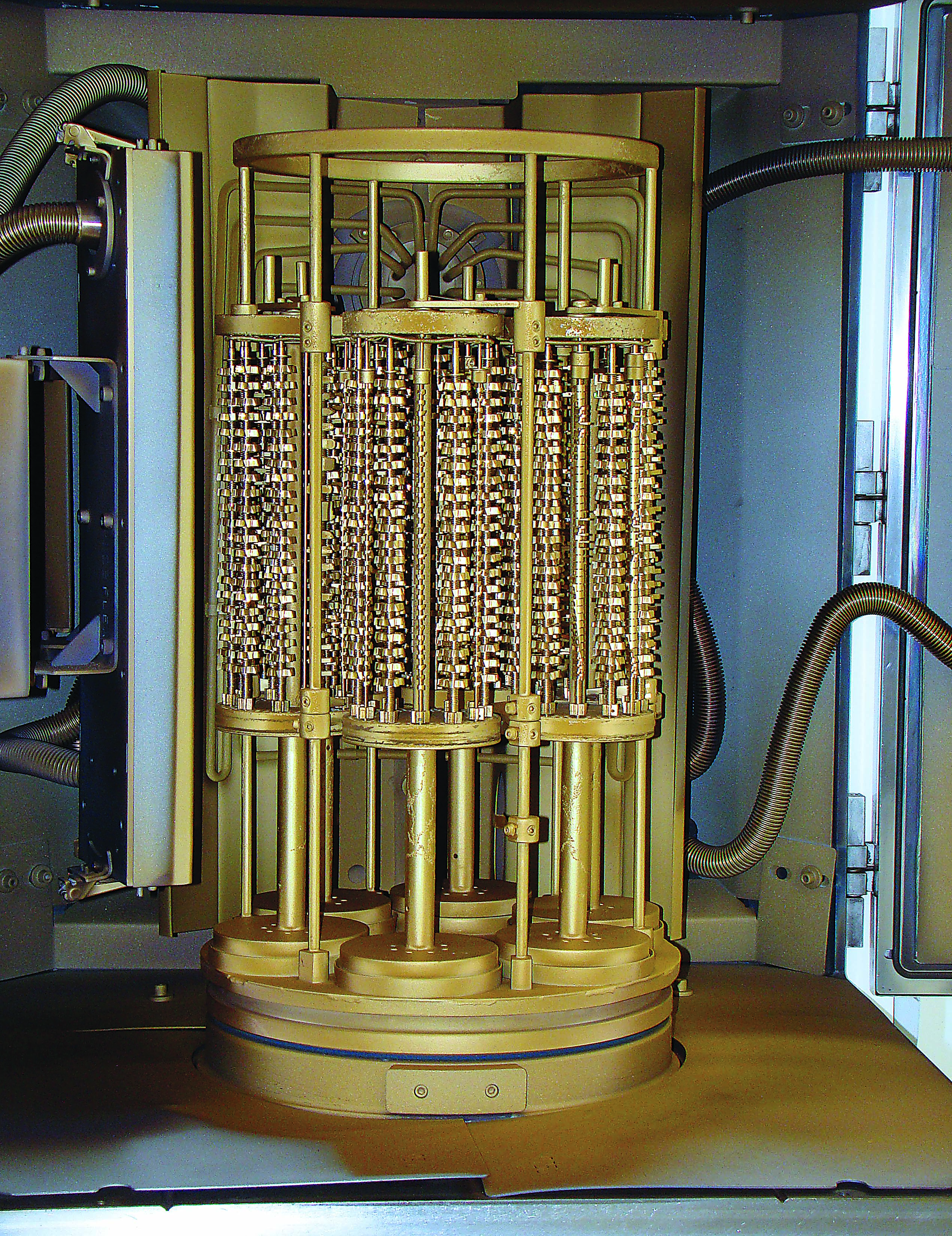

Physical and Chemical Vapor Deposition
Physical vapor deposition describes a family of coating processes. The most common of these processes are evaporation (typically using cathodic arc or electron beam sources) and sputtering (using magnetic enhanced sources, aka magnetrons, or cylindrical or hollow cathode sources).
PVD processes occur in a vacuum, typically at a working pressure of 10-2 to 10-4 mbar. They generally involve bombarding the substrate to be coated with energetic, positively charged ions during the coating process. In addition, reactive gases, such as nitrogen, acetylene or oxygen, may be introduced into the vacuum chamber during metal deposition. These gases create various compound coating compositions. The result is a very strong bond between the coating and tool substrate.

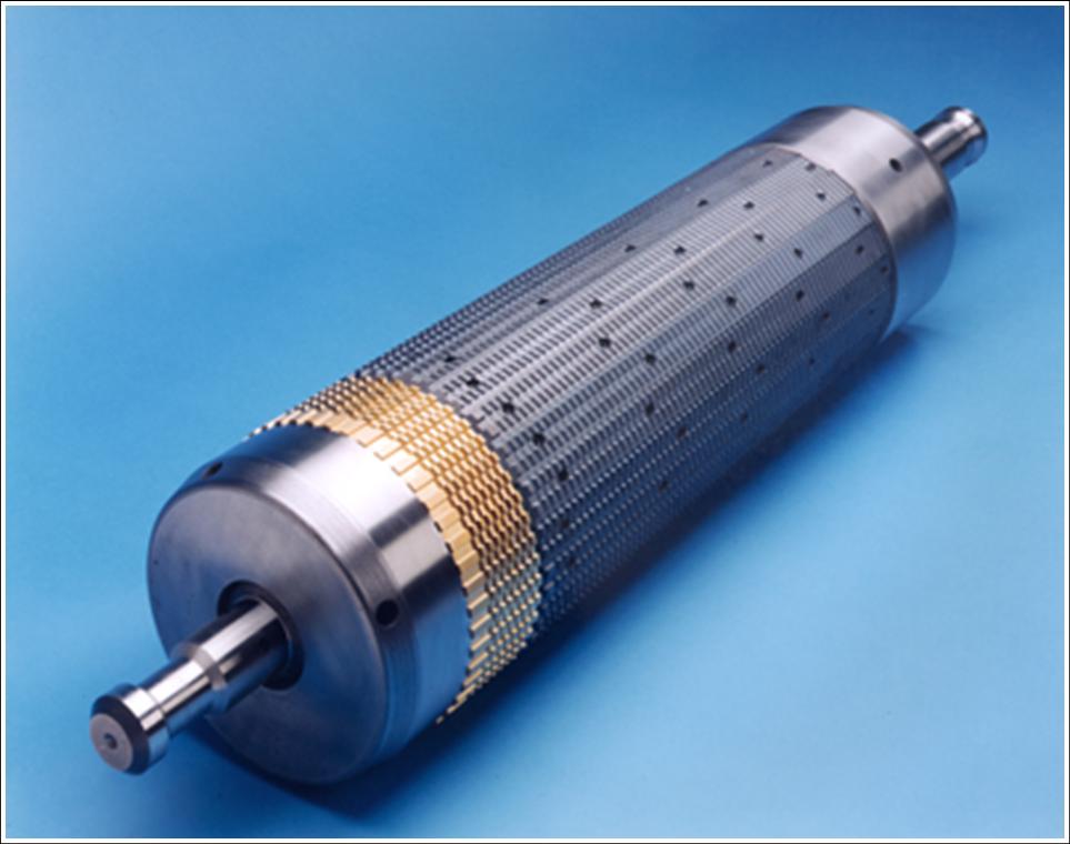

Understanding coatings and how they lower machining costs
A TiN-coated spline broach. Image courtesy of Richter Precision.
As for lubricity, the coefficient of friction for coatings can be significantly lower than uncoated tool substrates. With forming tools, for instance, this lowered coefficient of friction means the tools exert less force because of reduced resistance.
In cutting applications, reduced friction means that less heat is generated during the machining process, thereby slowing the breakdown of the cutting edge.
In applications involving parts that slide, coatings greatly reduce the tendency of materials to adhere. This reduces friction and allows more unrestricted movement.

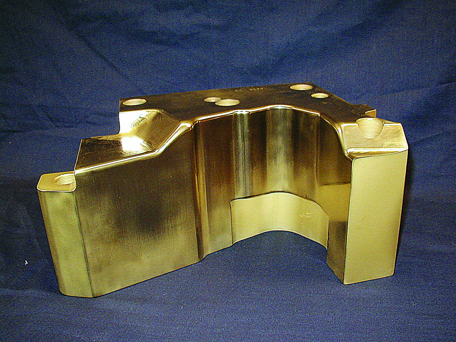

A die for automotive applications coated via the CVD process. Image courtesy of Richter Precision.
Broadly speaking, when materials and tolerances allow, CVD coatings have proven to be superior to PVD coatings in many applications. The CVD process creates a metallurgical and diffusion-type bond between the coating and the substrate. This bond is much stronger than the physical bond created through PVD processes.
But a potential area of concern with CVD coating is its high processing temperature: 1,925° F. This temperature can limit the use of CVD coatings in some applications because of tolerance concerns.
PVD coatings are suitable for a much wider range of substrates and applications. This is largely due to PVD coatings’ lower processing temperatures—385° F (196° C) to 950° F (510° C)—and average coating thicknesses of 2µm to 5µm. These characteristics, among others, make PVD coatings a better choice for applications in which close tolerances need to be held and for base materials that are sensitive to high temperatures.
For example, an HSS endmill likely would develop problems involving straightness and concentricity if the endmill was put through a CVD coating process, whereas the endmill would be an ideal application for PVD coating. Lower process temperatures mean no distortion will be observed for most materials as long as proper draw temperatures are utilized.
