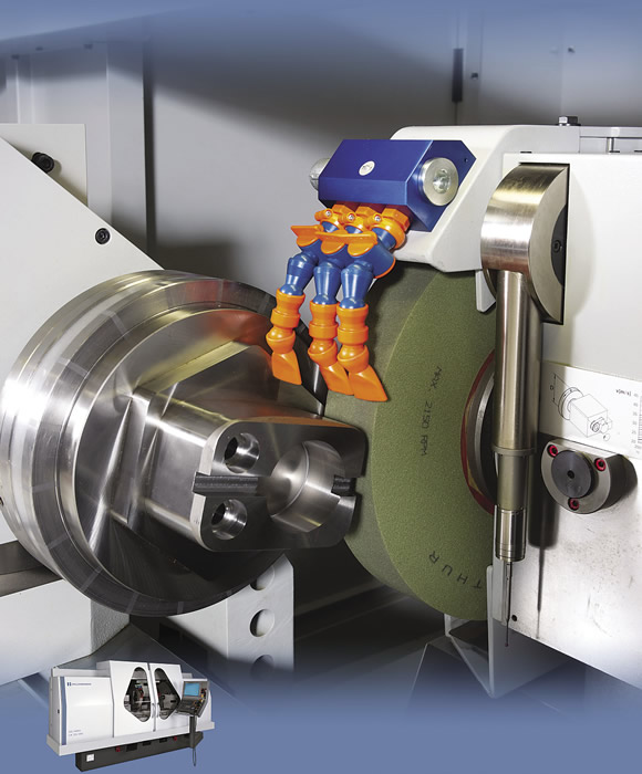

Grinding of a hexagon form using a Studer universal cylindrical grinding machine with a form grinding option.
“As you reduce the number of setups, you also reduce the chance of making a mistake or having to make offsets or adjustments in the part,” said Shane Farrant, national product manager for grinding machines, Toyoda Machinery USA, Arlington Heights, Ill. “If you flip the part on the machine or have to go to another machine, different variables can be introduced.”
Another benefit is faster throughput. “By grinding in one setup, you eliminate the locating, fixturing and load/unload time going from one grinding machine to another,” said Dennis Peters, account manager for Cinetic Landis Corp., Hagerstown, Md. “This eliminates what we call the ‘parasitic time,’ the nongrind time.”
Also, a single-wheel grinding machine requires more wheel changes. “It can take 15 to 30 minutes for a wheel change, whereas if you can just index to a different wheel it takes seconds,” said Jeff Hilliard, national sales manager for the Grinding Group at Hardinge Inc., Elmira, N.Y.
