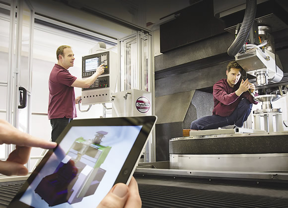

Improvements%20in%20graphics%20are%20reflected%20in%20all%20programming%20routines%20(credit%20Siemens).tif
Courtesy of Siemens
Siemens engineers, such as those shown here, refine control capabilities, including elements such as speed, functions and graphics for both conventional and conversational programming.

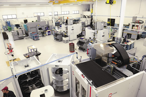

Operators%20at%20Marten%20Machining%20use%20conversational%20programming%20in%20concert%20with%20conventional%20G%20code%20programs%20(credit%20Marten%20Machining).tif
Courtesy of Marten Machining
Marten Machining uses conversational programming in concert with conventional G-code programs.

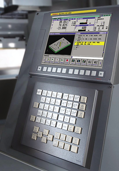

Fanuc%20control%20with%20conversational%20programming%20screen.tif
Courtesy of FANUC
A FANUC control with conversational programming screen.

Marten Machining Inc. has found that another variation of the hybrid approach works well for its operations. Much of the work done by the Stevens Point, Wis.-based job shop involves prototyping advanced parts. It has grown thanks to its early adoption of 5-axis machining and its innovative manufacturing techniques, including a “team” approach that permits operators greater involvement in the manufacturing process, according to owner Dave Marten.
“Despite the advanced nature of many of our parts, we use CP on our Heidenhain controls fairly often as an adjunct to our offline (conventional) programming capability, which is done by programmers using Mastercam CAM software,” Marten said. “For instance, if there’s a hole pattern to drill and tap, the offline program will define the position. But we let the operator decide, using CP, what the sequencing will be based on the tooling being used. We also use CP for certain touch-probe cycles. We like CP because it keeps our operators involved in the process and lends greater versatility to our programming.”
