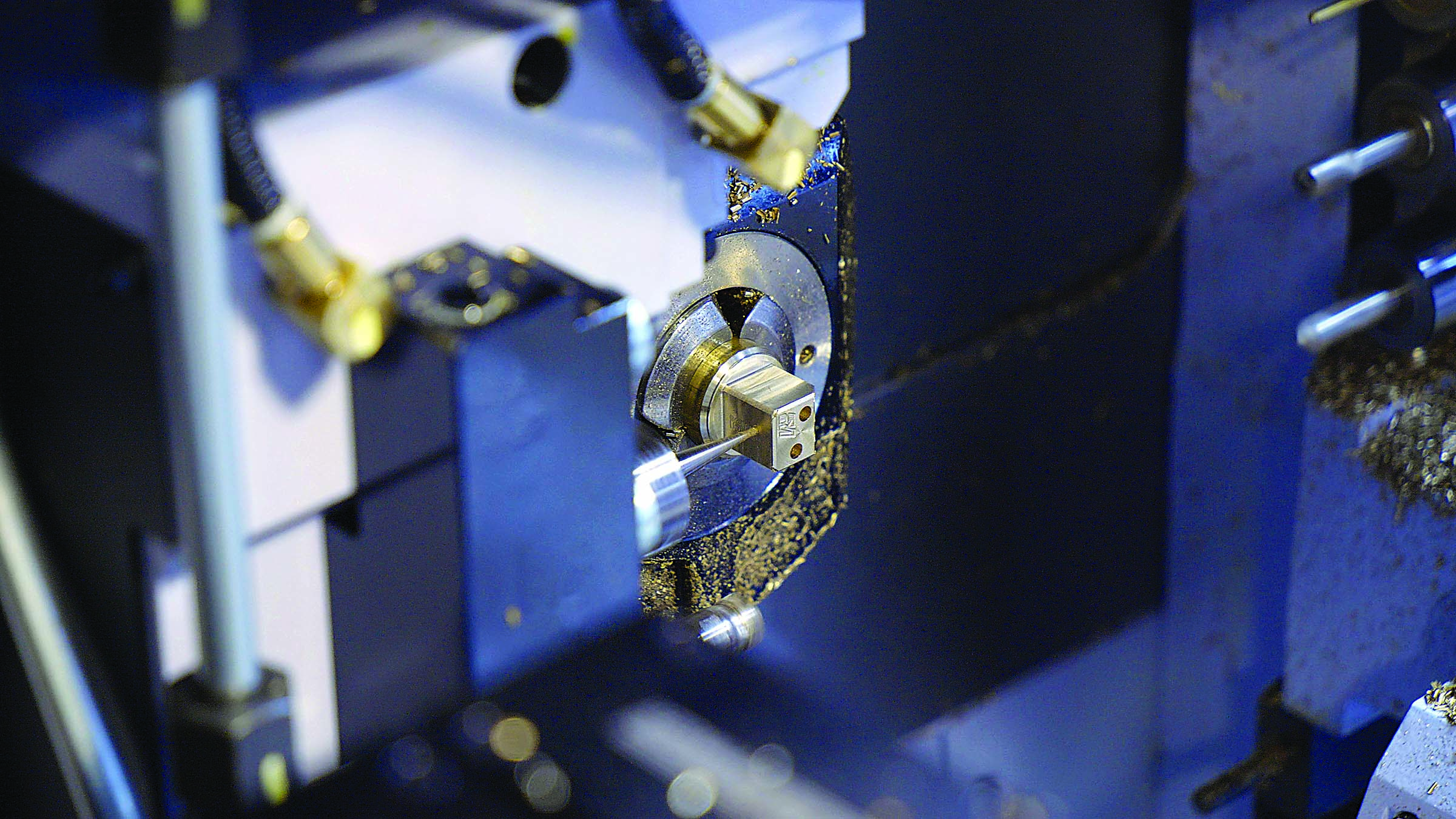

Courtesy of B. KennedyOn a Marubeni Citizen-Cincom K16 Swiss-style CNC lathe, a 0.047 "-dia. drill working from a slide servicing the subspindle creates a hole in a brass workpiece used to verify the setup for machining a dental abutment screw.Tactics and tools for Swiss-style machining.Swiss-style CNC lathes provide outstanding precision and flexibility while also posing special process control challenges and considerations.

On a Marubeni Citizen-Cincom K16 Swiss-style CNC lathe, a 0.047 “-dia. drill working from a slide servicing the subspindle creates a hole in a brass workpiece used to verify the setup for machining a dental abutment screw.
