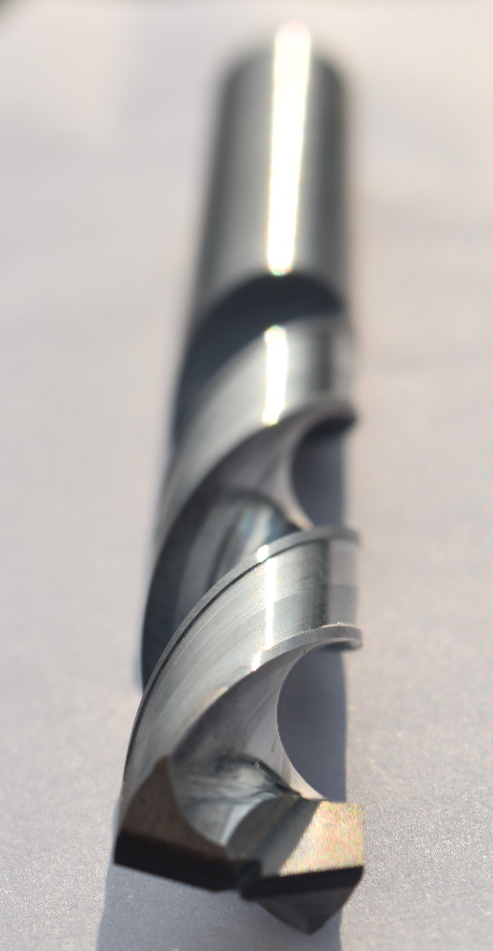

The twist-flute version of the EdgeX4 drill. Image courtesy of West Ohio Tool
King said the EdgeX4 offers a cutting speed that is up to three times faster than a solid-carbide drill. The drill’s cross-center tip eliminates all carbide cutting edges.
