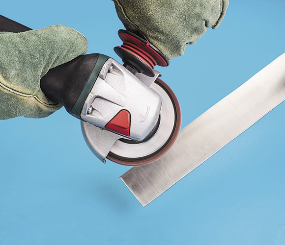

Whether the surface-treatment task involves deburring, blending, grinding, polishing, finishing, dimensioning, patterning or shaping a metal workpiece, there's a coated-abrasive product available to get the job done. The products include belts, rolls, sheets, pads and flap discs and wheels.

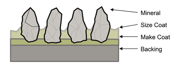

Two layers of resins create the bonding system for coated abrasives, according to a technical paper from VSM Abrasives Corp., O’Fallon, Mo. The first layer is the make, or base, coat, which anchors grains to the backing. The second layer is the size coat, which is applied over the grains to further anchor and stabilize them.

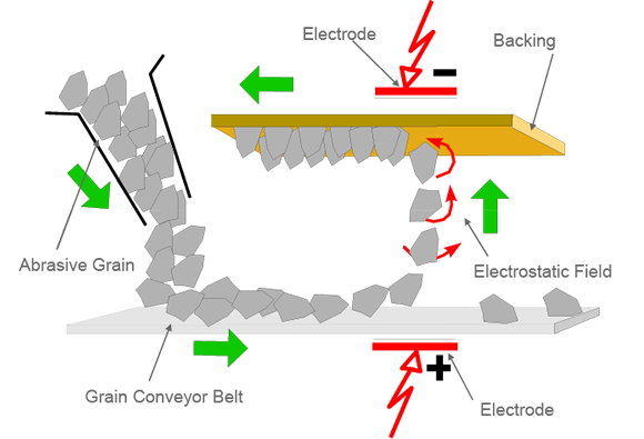

VSM also stated that grains can be applied via the gravity coating process or the electrostatic coating process. In the gravity method, grains drop from an overhead hopper onto the adhesive-coated backing. In the electrostatic method, the adhesive-coated backing and grains pass through an electrically charged field, which propels the grains upward toward the backing that travels upside down above the grains. The grains are then embedded in the adhesive with the sharpest edge of the minerals exposed to ensure uniform cutting.

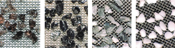

The primary abrasive grains for metal-working are aluminum oxide, zirconia alumina and ceramic alumina. Less-frequently applied ones include crocus, a natural abrasive of iron-oxide particles used mainly for cleaning and polishing soft metals, and silicon carbide, a hard and brittle grain for nonferrous metals and hard materials.

Electrostatic coating is the most widely used process for applying abrasive to the backing of coated-abrasive products. The process leaves the abrasive grains standing upright, perpendicular to the backing, with the sharper ends of the grains pointing up and away from the backing.

Four types of grains for coated abrasives are (left to right) aluminum oxide, silicon carbide, zirconia alumina and ceramic alumina.

A typical coated abrasive has a backing, make (base) coat, size coat and mineral.

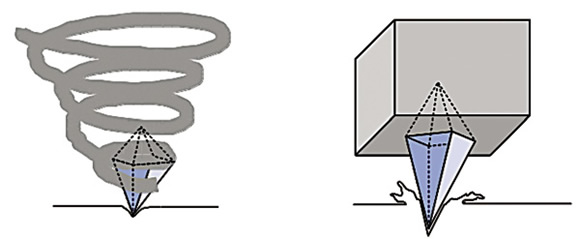

Non-Woven-Abrasive-and-Coated-Abrasive.tif
Courtesy of Superior Abrasives LLC
The spring-like cutting action of a nonwoven abrasive (left) is easier on the workpiece surface than a coated abrasive (right) and is ideal for manual operations that require finesse, according to Superior Abrasives.

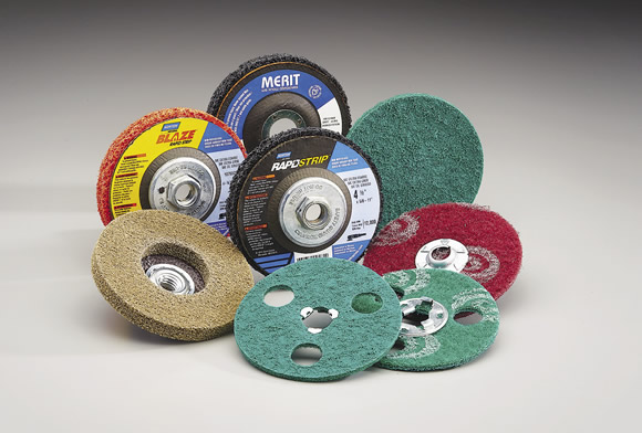

Although available for a couple of decades, nonwoven abrasives use is growing, according to Long. They differ from the traditional definition of a coated abrasive because a nonwoven backing can be impregnated with a layer of abrasives rather than just the top like coated abrasives. “For the most part, a nonwoven is coated,” he said. “It’s just coated on a synthetic nylon backing rather than on a cloth, film, paper or fiber backing.”
With nonwoven abrasives, end users can boost productivity when selecting a high-performance substrate and a premium abrasive, according to Long. “For example, I can offer a Blaze Rapid Strip product, which is a ceramic alumina grain coated onto a highly porous, highly aggressive nonwoven substrate,” he said. “With that particular product, an operator of a right-angle grinder can dramatically improve his wheel life and stock-removal rate over a comparable fiber disc.”
Discs-NonWoven-RAG-Line.tif
Courtesy of Norton/Saint-Gobain
Norton/Saint-Gobain offers an array of nonwoven abrasive discs.
